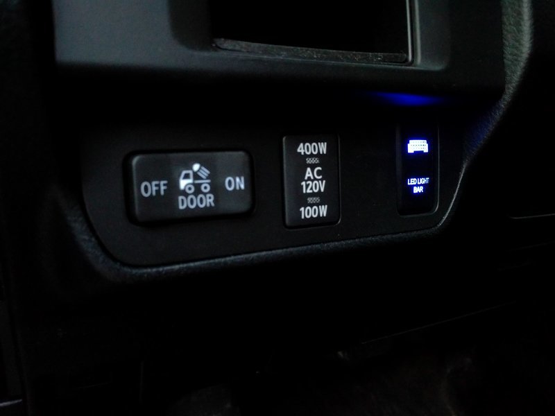

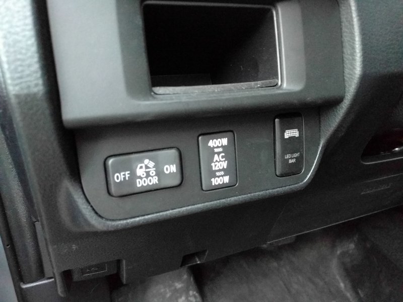

    Looks great. It also looks like the switch color and brightness are a pretty good match to stock. Did you use the MICTUNING switch? White or blue? Any changes to match the stock switch brightness?
    Thanks
  4. Apr 13, 2016 at 7:39 PM
    #244
    RNJNKE
    RNJNKE Pounding Trails
    Dec 29, 2015
    #173433
    480
    Russ
    VA
    2016 Tacoma TRD DCSB OR, Inferno
    '17 TRD PRO SEMA Wheels, 265/70/17 BFG AT KO2, Prinsu Racks, A.R.E Overland Topper, Redline Tuning Hood Strut, Relentless Fab Locking Bed Doors, Waterport, Angry Beaver
    Yep. MICTUNING. Didn't do anything but installed. Got the switch from Amazon.
    It was the blue...

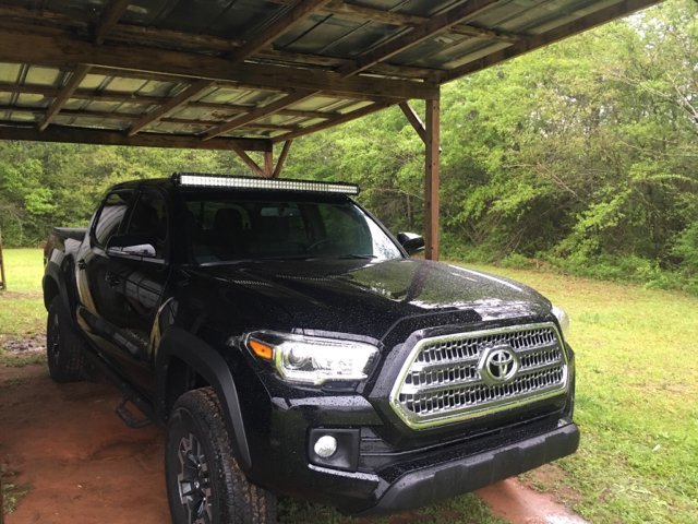

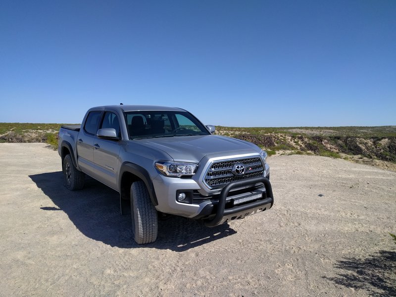

    Here's a 50" I did with a mictuning switch. I used info found on here and am very happy with the results! b71fc46a34677f5e30d4157e4f9ebf2f_a9b26c220ad3c22d63e6c8173424c2c89877cfd3.jpgdc9ab90a228c18d5b1897b93968dec49_b4ebca7988c2faeb8a36b7c8d80205f94be1d8a7.jpg

    I used a black oak dual row, with relentless fab brackets, was an easy install! ebeb5f495b3ca7a512954dab76a8c59c_e334ae218669b68f141d5d503c9da16d04ef1008.jpg5727c11610d8b8ced9e5988219e7a6f0_89741c241776d83797cc6437950c28c298c744a6.jpg

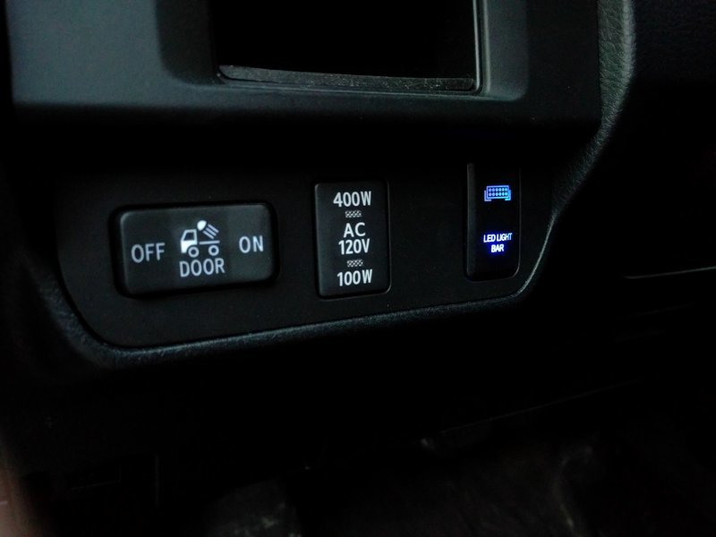

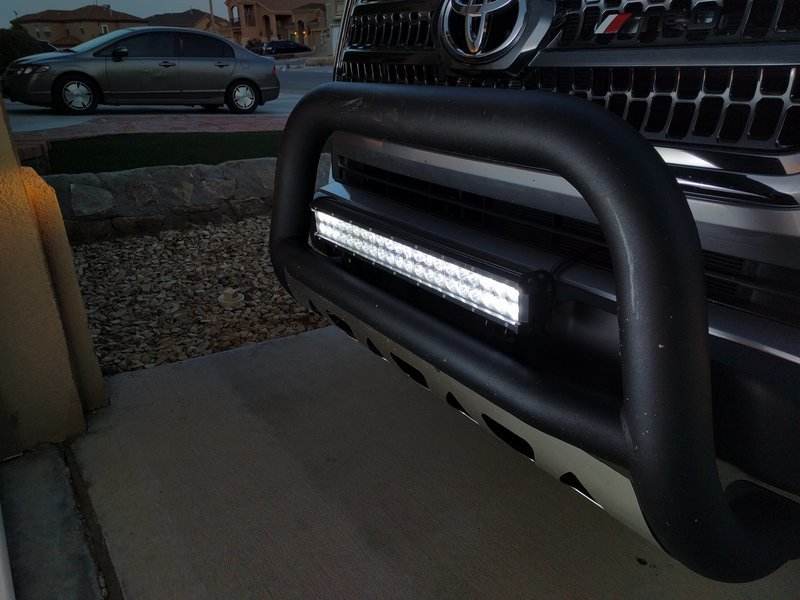

    First off, here's my setup:
    20" DT MOTO Lightbar from Amazon ($45) - mini Review: Very very bright, well made, gets the job done well, love it so far.
    attached to my Dakar Pro Bull bar (Bought locally at Alamo Auto Supply - $220)
    Inside we have the good ole Mictuning LED push switch. Amazon ($12)
    Connected with the OPT 7 Wiring Harness. Amazon ($25)
    Car off:
    Regular interior lighting with car on:
    Light bar on (Hard to tell, but only the picture of the lightbar on the switch gets brighter):
    Eureka!

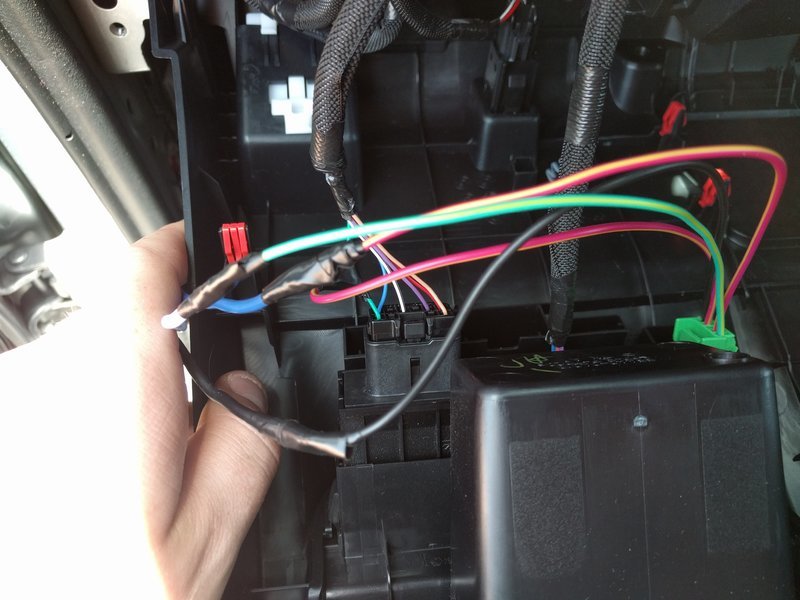

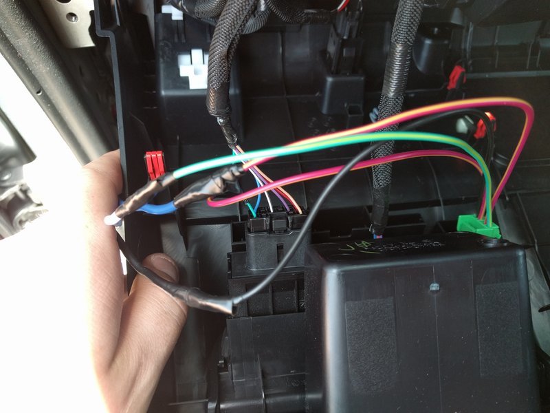

    Now, one thing I don't see on here clearly pictured is how you do the wiring, it may be different for your vehicle, but I spliced mine with the truckbed light (light green wire). The rest of the wires attach as shown below.
    Instructions for the OPT7 harness & the Mictuning light switch:
    Mictuning to OPT7 Wiring Harness goes:
    (Green w/ yellow-stripe) to (OPT7 White) - Powers light on
    (1st Red w/yellow) to (OPT7 Blue) - Powers light off
    (2nd Red w/yellow) to (Spliced w/ light green wire on Truckbed light) - Lets switch light up with rest of interior dash lights
    (Black) to (OPT7 Black) - Grounding
    With this configuration lights will display as shown above, and the lightbar will work with the engine off, as the other end of the OPT7 harness is attached directly to the battery terminals, the rest of kit is installed pretty much the same way as rysingsun's tutorial.
    The whole process is really easy to do yourself, and I'd be glad to answer any questions on my experience. Also, shown above the wires are just covered with electrical tape, after ensuring it worked, I used heat shrink to get a nice tight wrap that will withstand the fury of off-road vibrations, if you're gonna do it, do it right.
