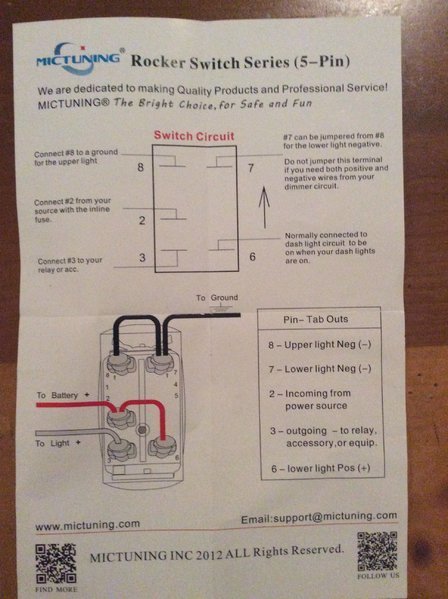

    Yeah man I don't even want to begin the nightmare yesterday accidently hooking up the wrong wire... I put the extra hot wire to the dash positiveIMG_1262.jpg

    What wiring harness are you using? Same as mine? If so, I can help you with which wire on the switch should go to which wire on the harness.

    It's mic tuning but a bigger switch. I had to dremle out the plastic to fit it in

    I am tracking need to put a wire from 6 to the green wire on that switch?

    Which wiring harness are you using from the light bar to the switch? MicTuning as well with white, black, and red cables going to the cab?

    It's white black and blue.... which makes thst harness all the more confusing. I'm tracking blue is the power on for the relay. White is batt and black is neg

    Here's my best guess on wiring up your rocker switch to your harness:
    • Switch 8 to harness black (ground) - use butt connector
    • Switch 7 to switch 8 / harness black (ground) - use jumper or butt connector
    • Switch 2 to harness white (positive power / inline fuse source) - use butt connector
    • Switch 3 to harness blue (light bar / relay) - use butt connector
    • Switch 6 to green cargo light wire (come on with interior lights) - use t-tap
