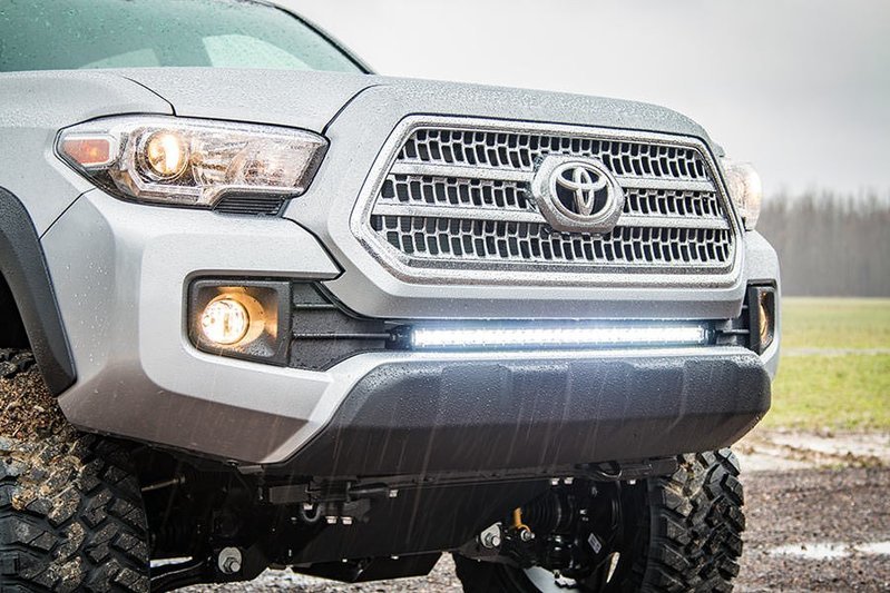

    Anyone have a thread on the Rough Country 30" bumper light bar install? I think this one looks the cleanest in my opinion. But just not excited about the trimming.
