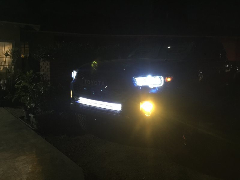

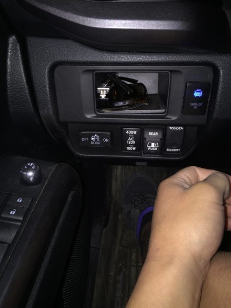

    Socal
    Installed mine the other day :) happy with it but did some cutting for my button as I ran outta button space. One thing I couldn't figure out was the red 2 next to the green (positive wire) on my microtunning switch on to which green wire I should tap on so I didn't add it. I'll figure it out later lol anyways here ya go. Haven't tested it out in a dark alley yet so here's some teasers. Thanks for this thread and the guys who help make this thread !

    Looks awesome! Great looking truck. The bronze rims look badass, I considered rims that color as well but went for black. See below for my write-up which I believe answers your question. It's the green wire from the cargo rear light which is the switch on the far left. The green wire is the first wire. See below. I removed a little bit of the sleeve for the cargo light and retaped it with electrical tape to have more space to use the t-tap.

    By cargo light do you mean the truck bed light ? If so I'll try n do it again ! Thanks bro!

    Yeah the bed light at the top of the rear of the cab (the far left rocker switch). The green wire is the far left wire of that far left switch. Take a look at that picture I posted, hopefully that helps. Good luck!

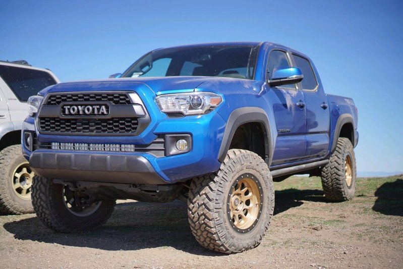

    Pics as promised.
