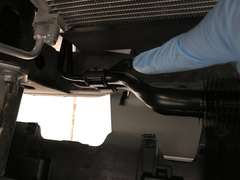

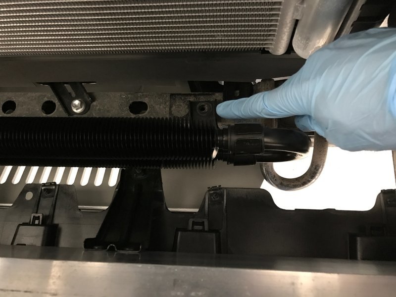

    Just got mine done. Appreciate the help that the walk throughs provided. Couple of items that are worth mentioning for others...
    1 - Below is a pick of where the oil cooler is attached. Don't get too crazy moving it once it's unbolted. It doesn't move too much, just enough to get it out of the way.
    2 - I would recommend that you come in from the passenger side with the light. It makes it a lot easier to get into place.
