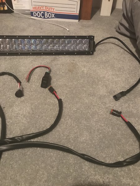

    I used the same light bar,harness and switch but the light to the switch stays on with the key off does yours.

    You've probably got your wires reversed on the switch. Load and supply are probably reversed. Switch them around and see if that's still the case.

    My switch only lights up when the interior / headlights are on, fully lights up when pressed, and turns off when the headlights are turned off. You likely have the wiring wrong like @obz said. Check your wiring against the diagrams I posted. PM me if you need any assistance. Good luck!

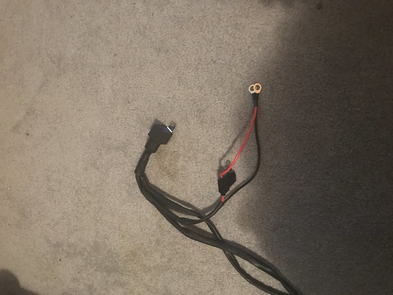

    Help! The wiring harness from Cali raised doesn't make much sense to me. Needing some clarification unless I'm just stupid. Lol.
    I under stand where to mount the relay and hook up + and - to battery.
    What I don't understand is that the harness came with to female connectors on the end but the light bar only has one plug? Also the connection isn't very secure (doesn't clip) and then also making sense of the button inside cab on how to wire. Thanks.

    If you look back through this thread there are plenty of instructions that should be able to help you sort that out. Pretty straight forward. Did it not come with any instructions?

    Thank you for the help, turns out I had a bad switch. I opened it up and repaired it ( some want repaired it) I'll have to order a new one. She's all wired up 32 inch light bar in the lower grill and some Cali raised pods on the hood. I'll post up some pics tomorrow.:thumbsup:

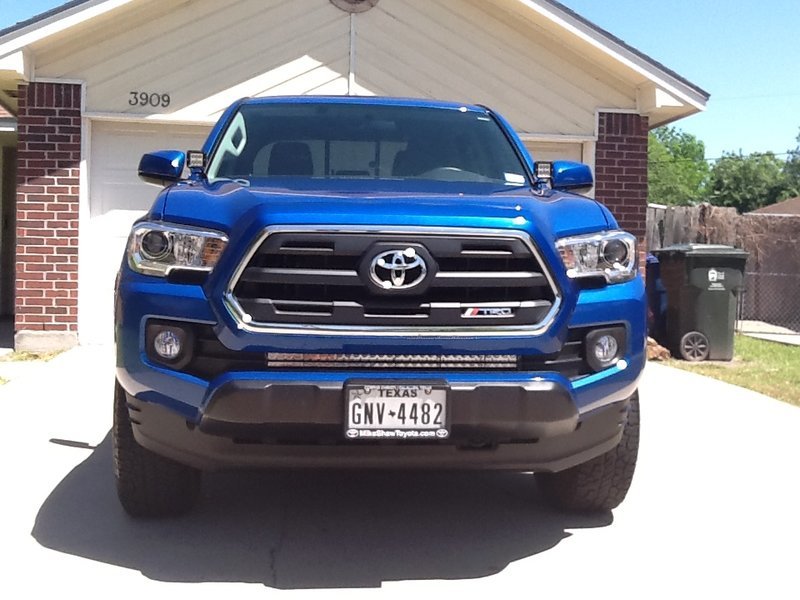

    Gave her a wash,32 inch light bar and Cali raised pods love them!

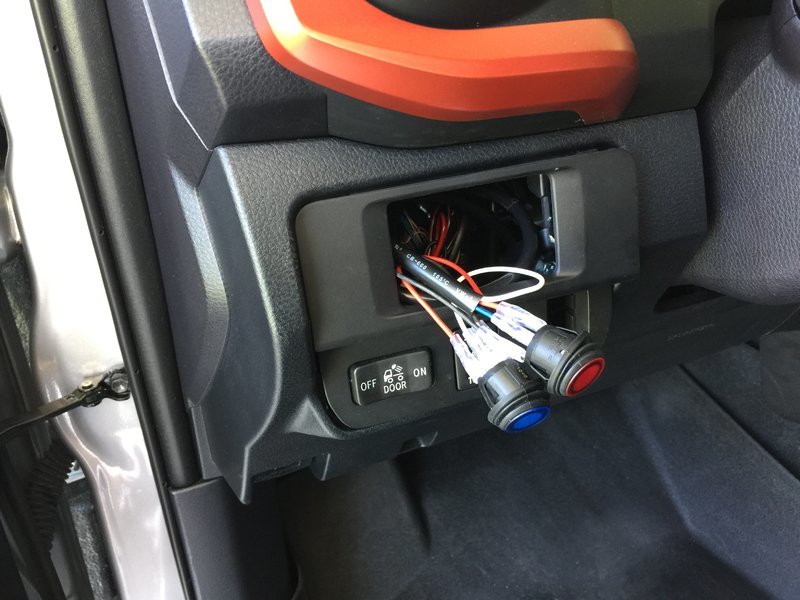

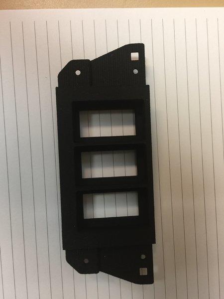

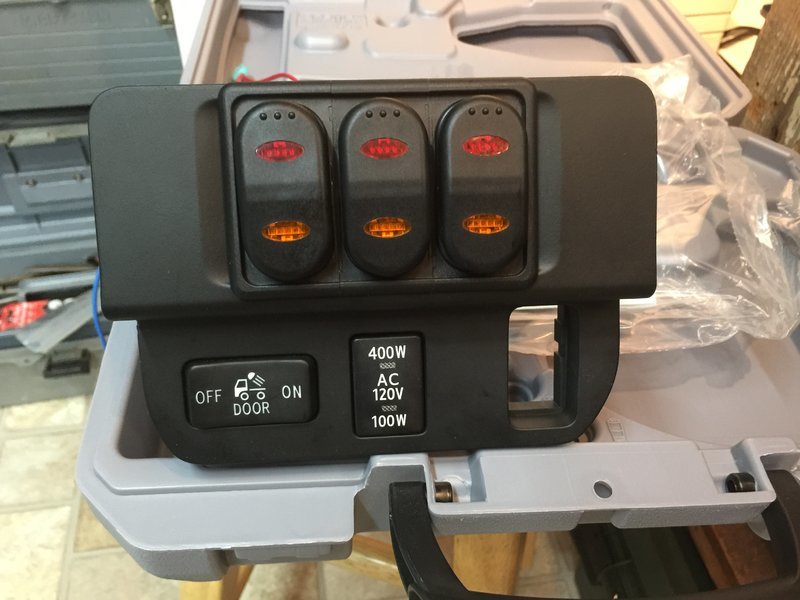

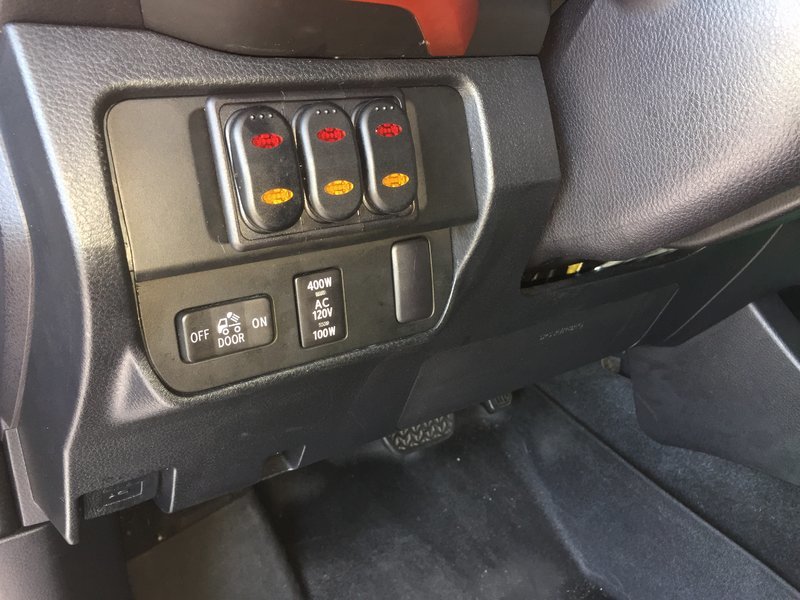

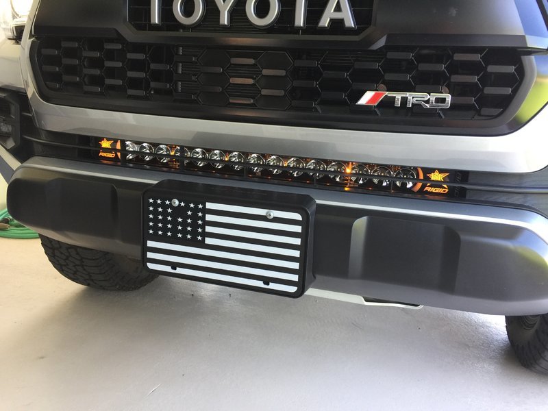

    Put the finishing touches on the light bar wiring. Opting for the Rigid Radiance (30 inch LED bar with an amber backlight) I waited for Gama Electronics three way Switches (on-off-on) and used a Carling three gang mount. Did not like the round switches supplied with the Radiance. They were functional but did not suit my eye and they are merely on-off. The Carling size switches fit nicely in the very under-utilized cubby hole. Removed the cubby and with just a minor trim in the corners the mount fit snugly in. Wired the backlight separately on one switch, the LED separately on another and used the third to trigger the light bar from the high-beam.
    I have an unused Toyota switchIMG_1550.jpg IMG_1551.jpg IMG_1554.jpg IMG_1557.jpg IMG_1558.jpg IMG_1559.jpg three gang mount from Shapeway (3-D printed) for sale now. Just opted not to use it and went with the Carling size. It is black and will fit in the exact slot of the cubby hole with the same four screws that hold the cubby in. $25 and I will pay the shipping.

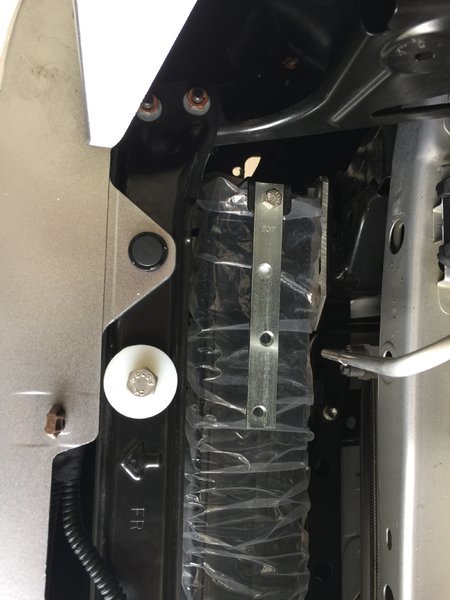

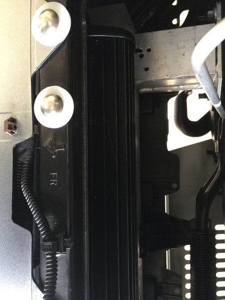

    I have the same lights that came with the original brackets. Trying to look at your pics closely to see where u end up mounting it. Any chance you have better pics? Any help would be greatly appreciated. Thx

    I'll try to help but since the light bar is completely installed and buttoned up I'll try to get some close up pics and some written details. Once you have the grille and surround removed (directions in many threads including this one) you will see a black cross brace which has two plastic clips on either end near each headlight assembly. You will also see a couple of elongated holes in the brace a few inches or so from these. These are the holes I used for mounting the light bar. To get the light bar ready to install, put the Rigid-supplied brackets on the bar as detailed in their instructions but face them up and point the mounting portions to the inside facing the light bar. Then attach to these brackets a couple mending bars (they have pre-drilled holes in them) you can pick up at Ace or any big box store. Use stainless hardware and face these inward as well. I think I used 4 or 6 inch mending bars. I bought both sizes and returned the ones I didn't use. These brackets and mending bars will now be at the top of the light bar as you look at it. Before proceeding to get the light bar in place you must remove the two bolts holding the lower oil cooler and "gently" move it aside so the bar can be inserted carefully down in the space and rested on the crash bar. Then you can then lift the bar up and if the mending bars are in a good position one of the holes in it will line up with the elongated hole on the cross brace (on both sides). Seemed too good to be true when I first attempted this idea. I used 1 1/2 inch stainless bolts with associated washers and nuts. You can use what you want but I also used nylon spacers at the top. Essentially these two mounting points would be enough but I reinforced it by using the holes at the ends where the plastic clips were removed. If you didn't take them out they actually would get pushed up when you pull the light bar up into position. That is why I added an extra bolt on the ends. Depending on how the holes line up you may have to drill an extra hole in the mending bar. I did and I drilled them while the bar was secured with the other two bolts. Bear in mind though these outer clips are used to secure the lower bumper surround and the bolts, if you use them, would need to be removed to get the bumper off. I have no plans in that regard but even so it would be a short task to remove them and the light bar would still remain solid. If all goes as mine did the light bar should be in a perfect position behind the lower grille portion. Before tightening everything down there is room in the elongated mounting points to move the bar from side to side for centering. The vertical position is perfect due to the luck of the Rigid bracket dimensions (3 inches tall). Don't forget to reinstall oil cooler bolts. Good luck and post pics when you are finished.
