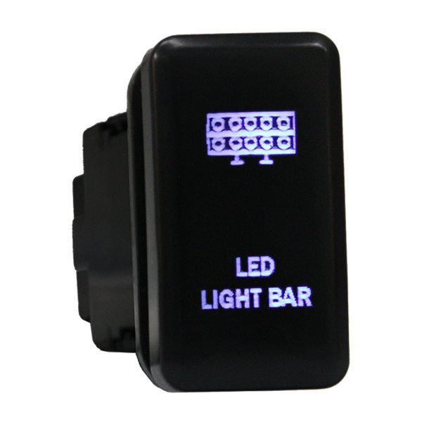

    can someone please tell me where I can get that led light bar switch?

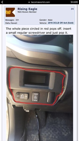

    From the forum:
    "To take the dash pocket/cubby/shelf out you need to pull the kick panel and then the entire lower dash below the wheel. The pocket is held in from behind with four screws.I recommend popping it out from the back by (at least partially) removing the lower dash panel. It's only 4 or 5 screws... very easy."

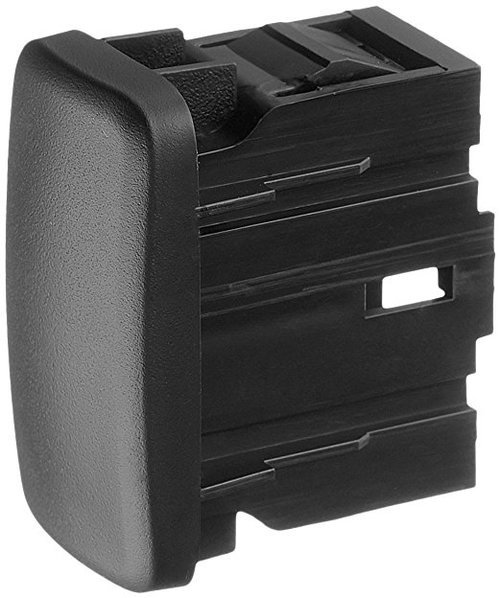

    You may need blank switches as well
    https://www.amazon.com/gp/product/B00J09FREQ/ref=oh_aui_detailpage_o04_s00?ie=UTF8&psc=1
