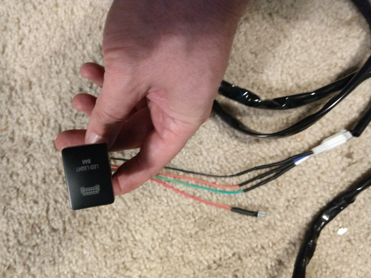

    Was wondering if this is the correct wiring for the led light bar? Was just wondering whats the other red wire close to the black wires for? Any help is appreciated!

    That extra red taps into the green wire of the cargo light switch which allows the switch to light up with the rest of the interior lights. See below.

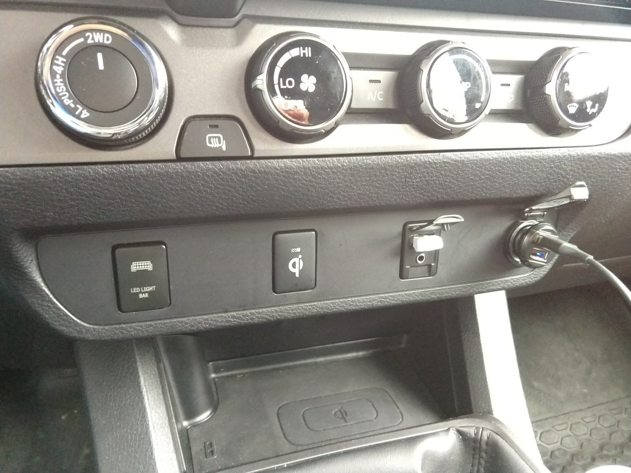

    OK Well got this wrapped up just in time for the weekend's adventure.
    I have a couple slight tweaks on the usual version I see people do here so I figured I'd share.

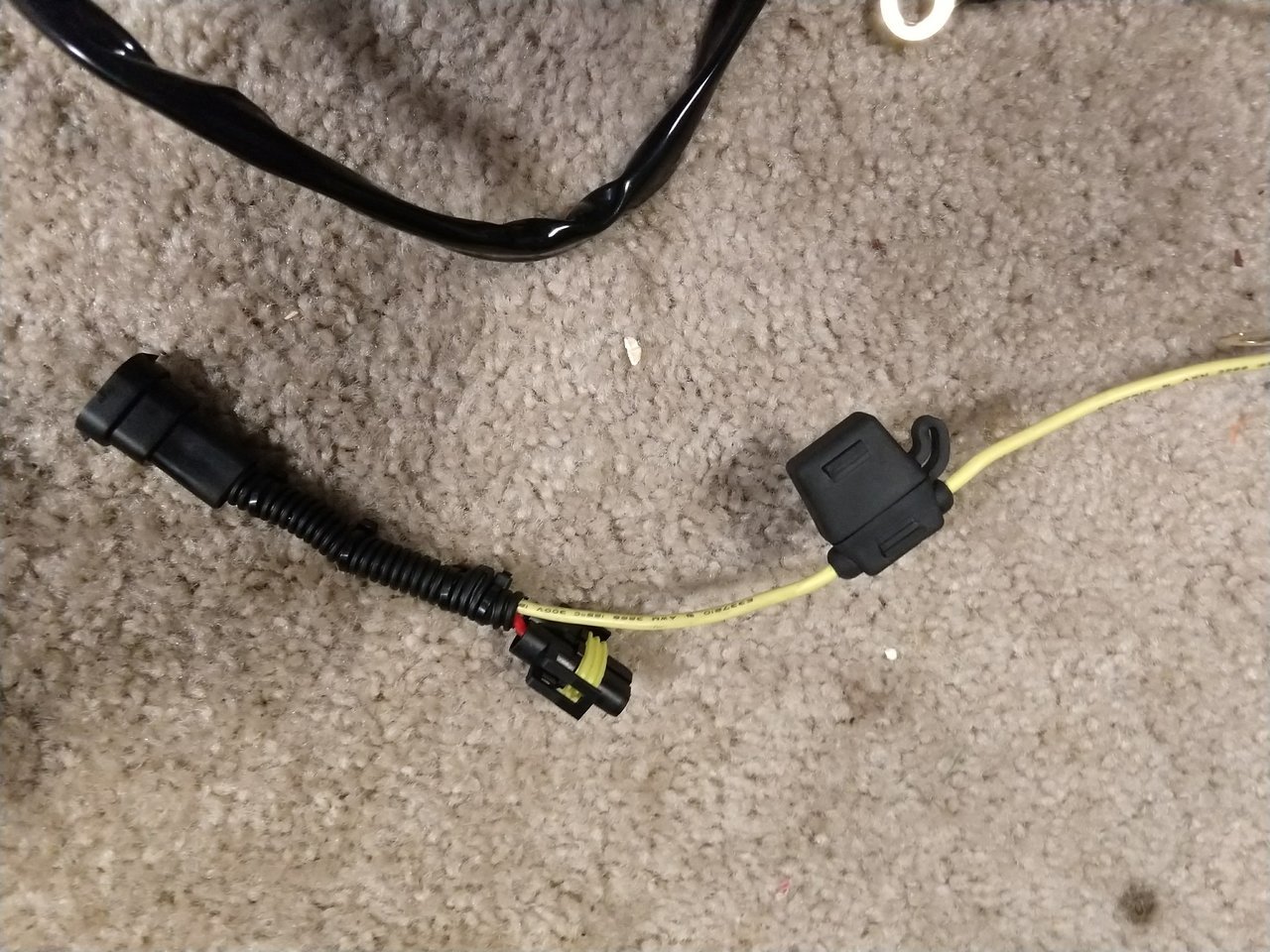

    I wanted this to activate with high beams ONLY, but also be switched. To do that, I got an H9 extension harness from ebay for about $8. I bought the same harness everyone gets in here, but took the red wire that feeds power to the switch off the relay side, and spliced it in to the 12+ side of the high beams. Threw a 7.5 amp fuse in there for good measure. Ran that wire to the FEED side of the switch. So now the relay can only be activated when the highbeams are on!
    Make sense?
    If anyone really wants, I can draw up a schematic.
    Here's a pic of the H9 extension adapter:

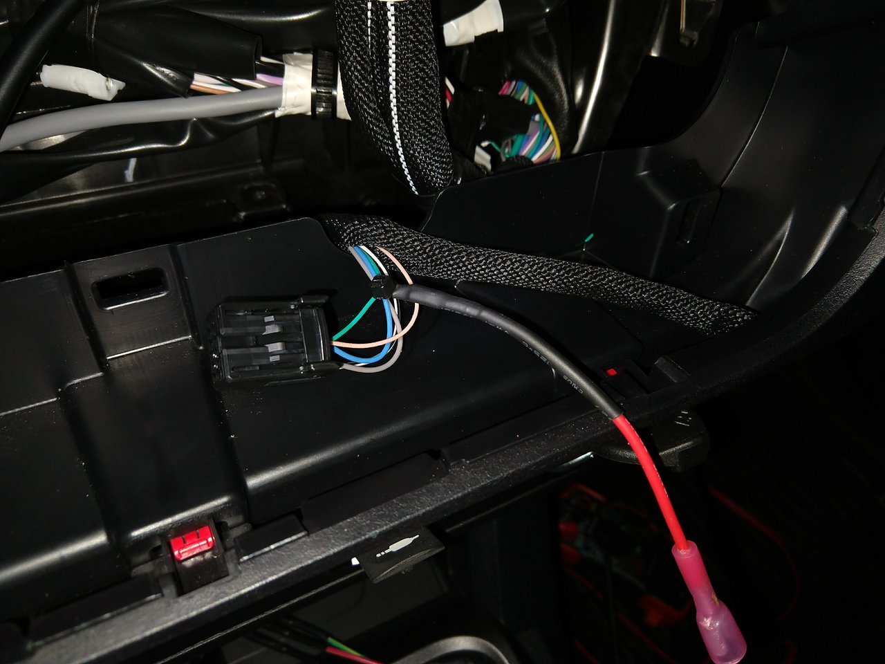

    And my switch - installed in the center section. I tapped in to the dash light wire that feeds the Qi button. Only problem now is this switch backlight is WAY too bright...at some point I'll tear it all apart and put some blue tape or something inside it.
    Tapped into the Qi wire harness... only cut I made to the factory harness!
    Looks like it belongs there.
    Action shot
    The cheapo light bar I got on Amazon is definitely bright.... but maybe not quite as bright as I had hoped it would be? Worthy upgrade, can't see paying $500 or whatever for a Rigid, but I'm curious now how much brighter they would be....

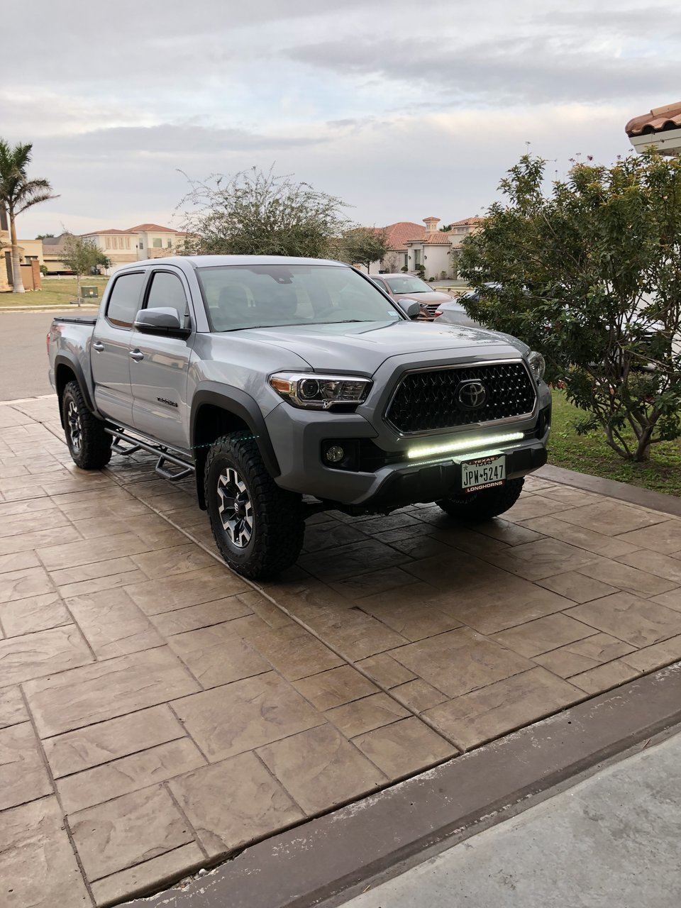

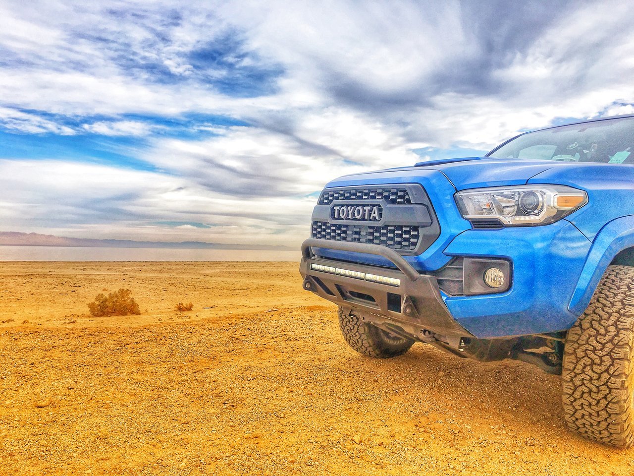

    2018 cement and I just had the install completed on a 30 inch Rigid single row light bar. Came out great!
    Sm32589g, rlx02, 8102 and 1 other person like this.
