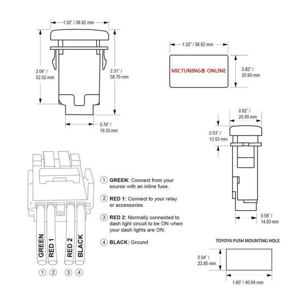

    I get lost around step 7 or 8. Why can't I just tap into a fuse or something?
  9. Feb 22, 2018 at 2:40 PM
    #569
    Falconsfan
    Falconsfan Well-Known Member
    Aug 13, 2017
    #226735
    547
    2017 sr dcsb v6 4x4 black
    That picture is just showing where he ran the wires through the firewall. You can i wired mine wrong and put the illumination wire on the fuse tap for the tail lights, and it illuminates only when my lights are on. I pulled power from the relay harness switch I intended on pulling power from tail fuse so it would only work when lights are on. If this isn't clear enough i can find the wire colors and tell you what goes where, can't remember off the top of my head.

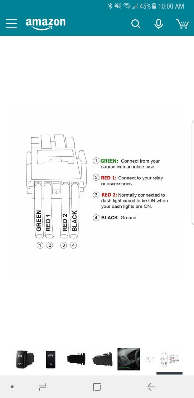

    I cut the little push button switch off relay harness and wired the mictuning switch to the three wires from switch and a add a fuse. I connected red 2 to my add a fuse on the taillight fuse, makes it only light up when lights are on, I should have put the green there too (but didnt, I followed bad YouTube instructions) this way light bar only comes in with lights on. The switch had 3 wires after I cut it off, blue, white and black. I put black wire from mictuning switch to black from relay harness switch and red1 to blue wire from switch, I put green to the white from relay switch harness. This allows it to turn on even with key off because either the white or blue is 12 volt constant from battery through relay harness, I believe it is the white that is 12v and the blue is the relay trigger but I will have to check when I switch my green wire to the tail fuse. Maybe someone else Will know for sure before I get to it. Hope this helps but when I switch it I will take and post pictures.

    I put one in my dad's tundra today and if you look at that diagram of the wires, I wired wire 1&3 together and put them to add a fuse on tail lights, wire 2 goes to relay(blue wire if you cut button off relay harness and have white black and blue wires) wire 4 to black from switch wires from relay harness. The white wire from relay switch wire is 12v constant, make sure you isolate so it can't short. Hope this helps a little more.
