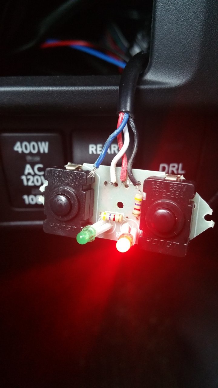

    This one has me stumped...Please help me wire this into 2 switches. The button on the right turns the light bar on/off, the button on the left turn the DRL LEDs in the light bar on/off. Do I need to add jumper wire to make this work on 2 separate CH4x4/MIC tuning switches???

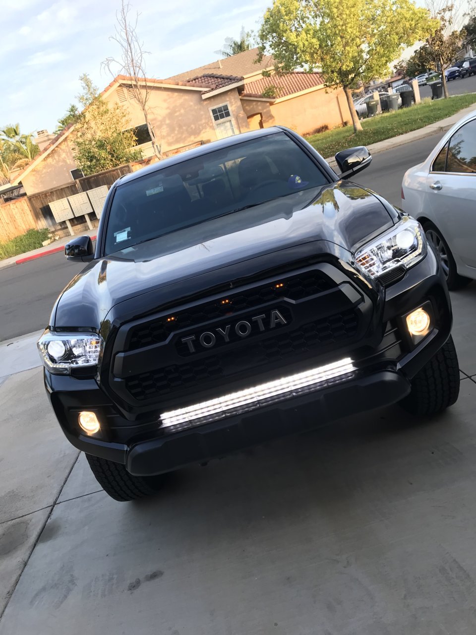

    Sneak preview 4CD18AAF-9D7D-474C-B5A7-8F7569BFD280.jpgtook a couple hrs start to finish, don’t have any good after pics yet

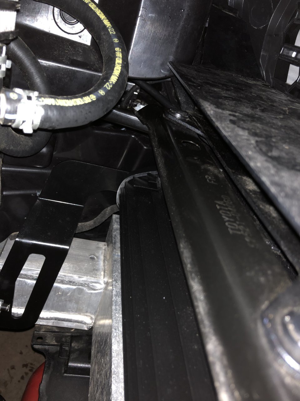

    I’m thinking of purchasing the same brackets. Do you have any pictures on how they mount onto the truck?

    These are the best I could do, I actually mounted it to the inside of the crash bar instead of the outside. This way I could leave my air dams in.

    Thanks for the pictures.
    Went with the same Randy Ellis brackets and an Auto Feel light bar.
    Quick and easy install.

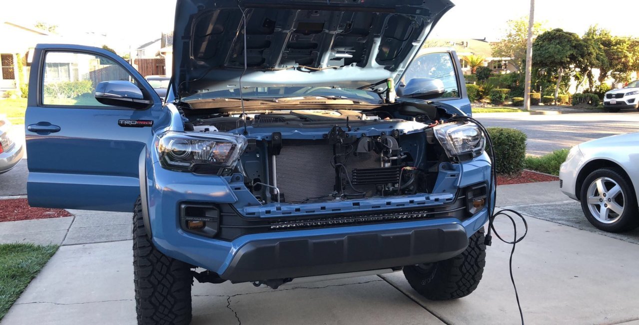

    Just installed my Cali Raised 32" light bar today with brackets and the mictuning oem switch, and wanted it only to turn on and illuminate when the lights were on. After brainstorming the wiring diagram I finally got it to work the way I wanted it to. I went and bought (2) create-a-fuse taps (one for the engine fuse box, and one for the under dash fuse box) and utilized the wiring harness supplied and the OEM switch. Included my diagram that I created for my installation.
    The ground from the harness I grounded to the frame, and the power wire from the harness I ran to the engine fuse box #15 fog light fuse (see diagram below)
    Connected the light bar harness to the lightbar.
    And ran the remaining harness (blue/white/black wire) through the firewall to the OEM switch. Ran the green wire (switch) to the white wire (harness), and black to black, and red1 (switch) to the blue wire (harness). Red 2 I ran to the under dash fusebox and used the other create-a-fuse to tap into the #20 D/L fuse (see diagram below)
