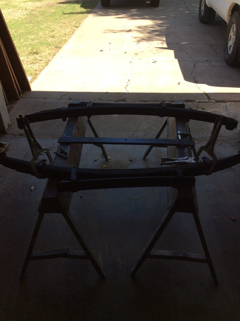

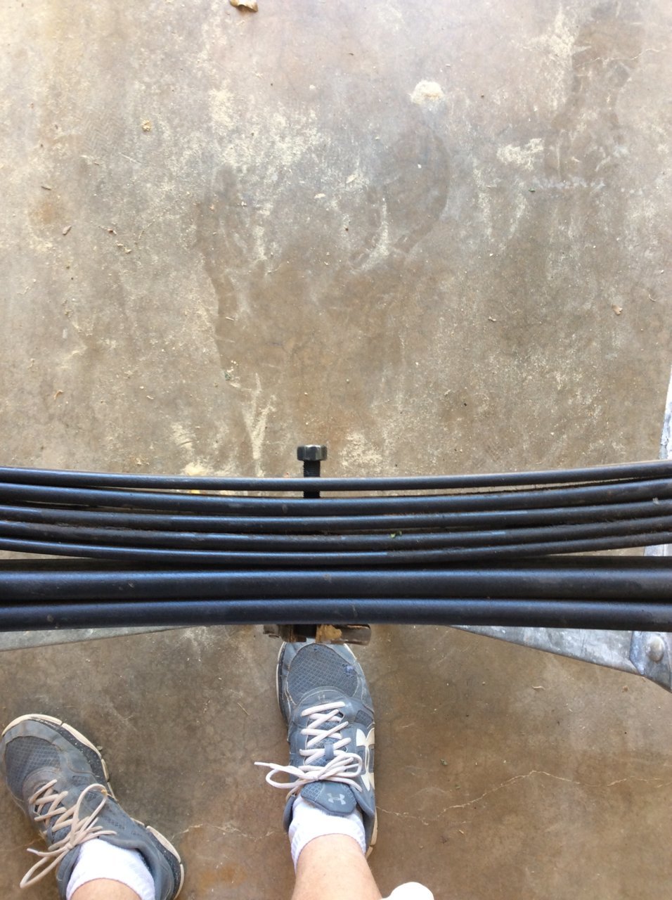

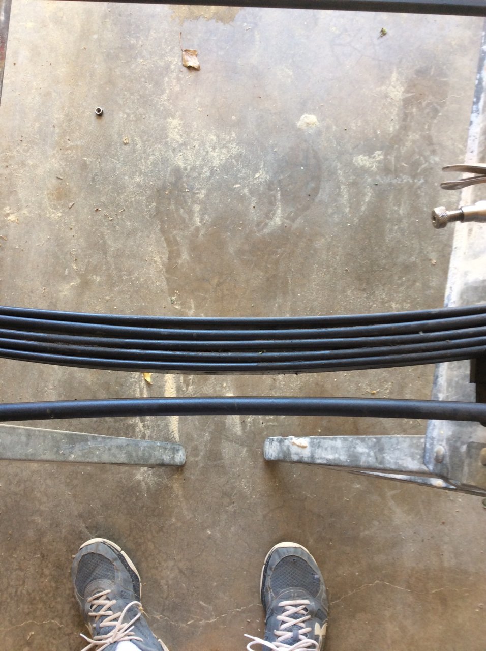

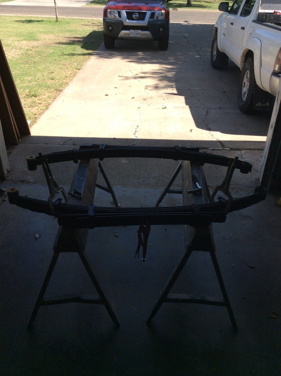

    Today I put on bilstein 5100 set all the way up
    OME Dakar leaf pack with the biggest over load removed. Took the thickness of the pack from 2.5inch to 2 inch even.
    Next will be all of the differential fluids, trans fluid, spark plugs and possible radiator switch. I’m at very least going to have to take it out and clean it. It’s packed with mud and weeds at the bottom. Gets hot when idling during the summer.
    Getting started.

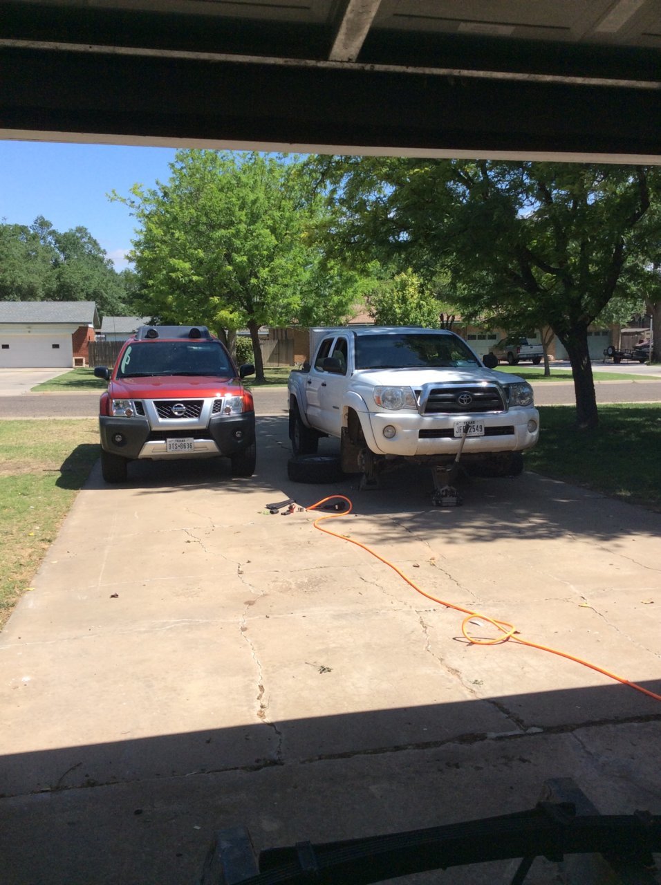

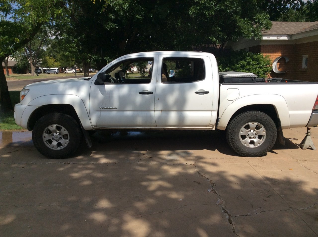

    Here’s the front with the billies in.

    And here it is stock height

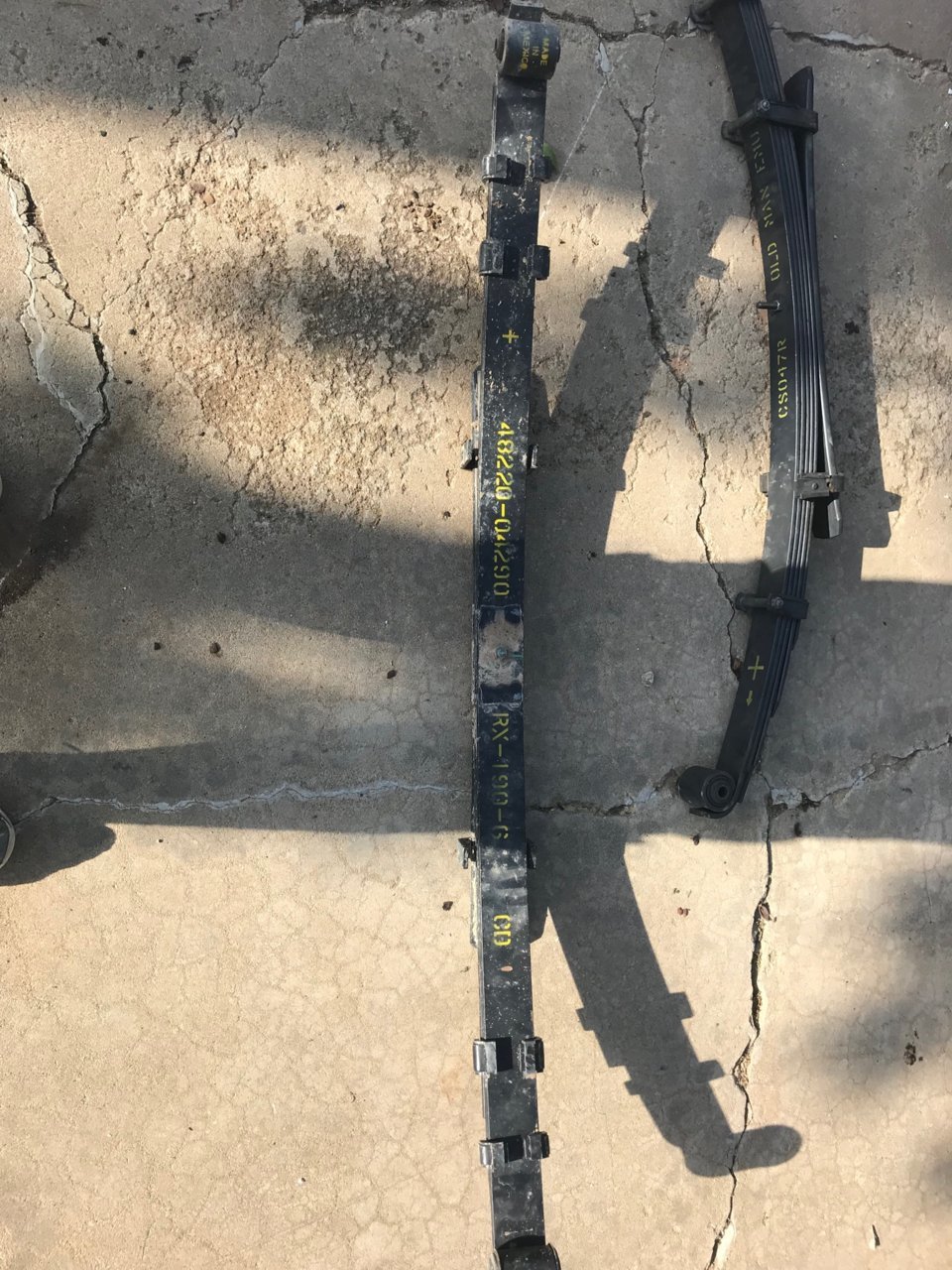

    Are these TSB springs? They look new like the frame. I’m wondering if the frame was replaced and new springs put on at some point.
    And a pic showing the difference.
