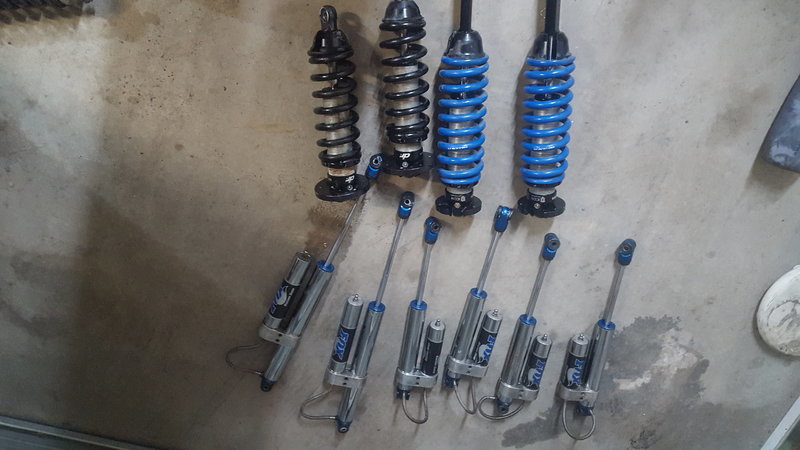

    Thanks!
    That was a busy night, not including the 4 Icon's I did on Monday.

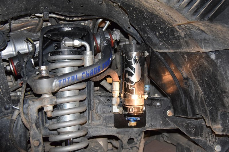

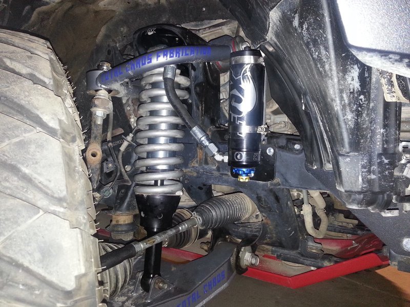

    I had a CO FJC guy with some Fox 2.5 Remote Reservoirs that wanted to change his reservoirs hose to match his new mounts.
    This was his old setup, it worked but didn't look great and had the possibility for rubbing or failing down the road.
    Here is the new setup
    Installed
    So if you deleted the front sway bar and don't like the reservoir mounting down low and forward on the frame I can get you setup like this FJ.
