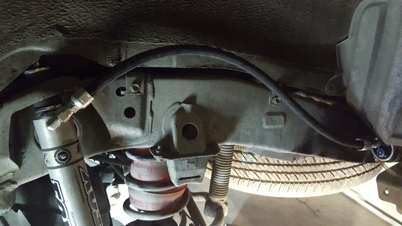

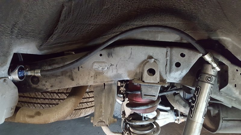

    I picked up some Fox 2.0's for my T4R and didn't like how the resi's mounted so I made some new hoses and welded on resi mounts I had laying around.
    Just need to crimp the fittings and put the shocks together. These shocks are for a 2nd gen Tacoma but bolt into a T4R by changing the lower bushing.
    Passenger side
    Driver Side

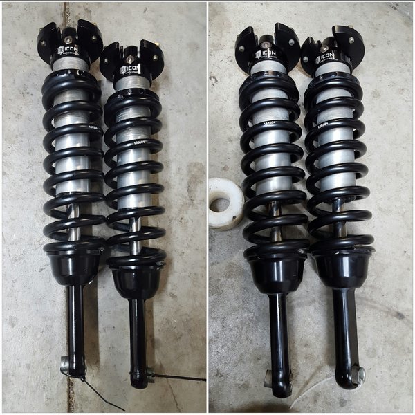

    I rebuilt @iRideMTB Icon coilovers tonight, and replaced his lower bearings.
    Here is a before and after, they were super clean when they were dropped off. My guess is @aero3685 drooling all over them cleaned them up.

    Thanks for the quick turn around Tim!
    She looks all dressed for prom and ready to be romped on again :D
