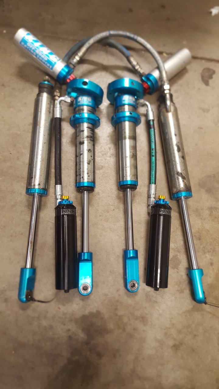

    Got some Kings knocked out for a local LT 2nd gen, added some Fox DSC resi's to them. I can add the Dual speed adjusters to any 2.0 and 2.5 resi shocks, Pm for pricing and availability.
