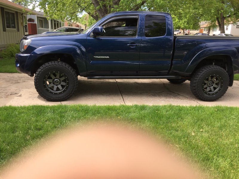

  5. Jun 4, 2017 at 9:55 AM
    #325
    AR15xAR10
    Apr 13, 2013
    #102024
    57,196
    2013 TRD Sport 4x4 V6 ACLBFTMFW
    Sooooo much better. Cept for the fanger in front of the camera :rolleyes:

    Hey Rebecca! That truck is looking awesome!
    If you really want to know for sure where you're going to rub at full stuff and full lock the best way is to put the front end on jack stands, pull the coilover, and put the wheel back on. Then you can stuff it all the way to the bumps without fighting the coilover. It's more of a PITA on 2nd Gens, but it is the best way to tell where you're going to rub without finding out the hard way on a trail.
    Check clearance at full bump straight ahead, full bump full lock left, and full bump full lock right. Typical problem areas are the back of the wheel well at the bottom by the cab mount, the top of the fender well up front under the battery, and the frame rearward of the LCA.
    Good luck!

    Not sure.
    But my wheels are 17x8 4.5bs 0mm offset
    Same exact tires.

    Mine are 17x8.5 -10offset 4.3bs

    Thats why i couldn't go SCS.
    No matter how much i love those SR8s and Ray10s. Their sizes suck.
    The extra half inch of width is why it rubs. But the offset narrows that down some...so they should only barely rub....but still....

    Its weird how you don't have more tire poke than me

    Yeah I know it's just a little trimming
    And a CMC
    No matter how much research I did:frusty:
    I guess I'm not good at research:D
    And I got an awesome deal on the sr8s I just couldn't pass up
