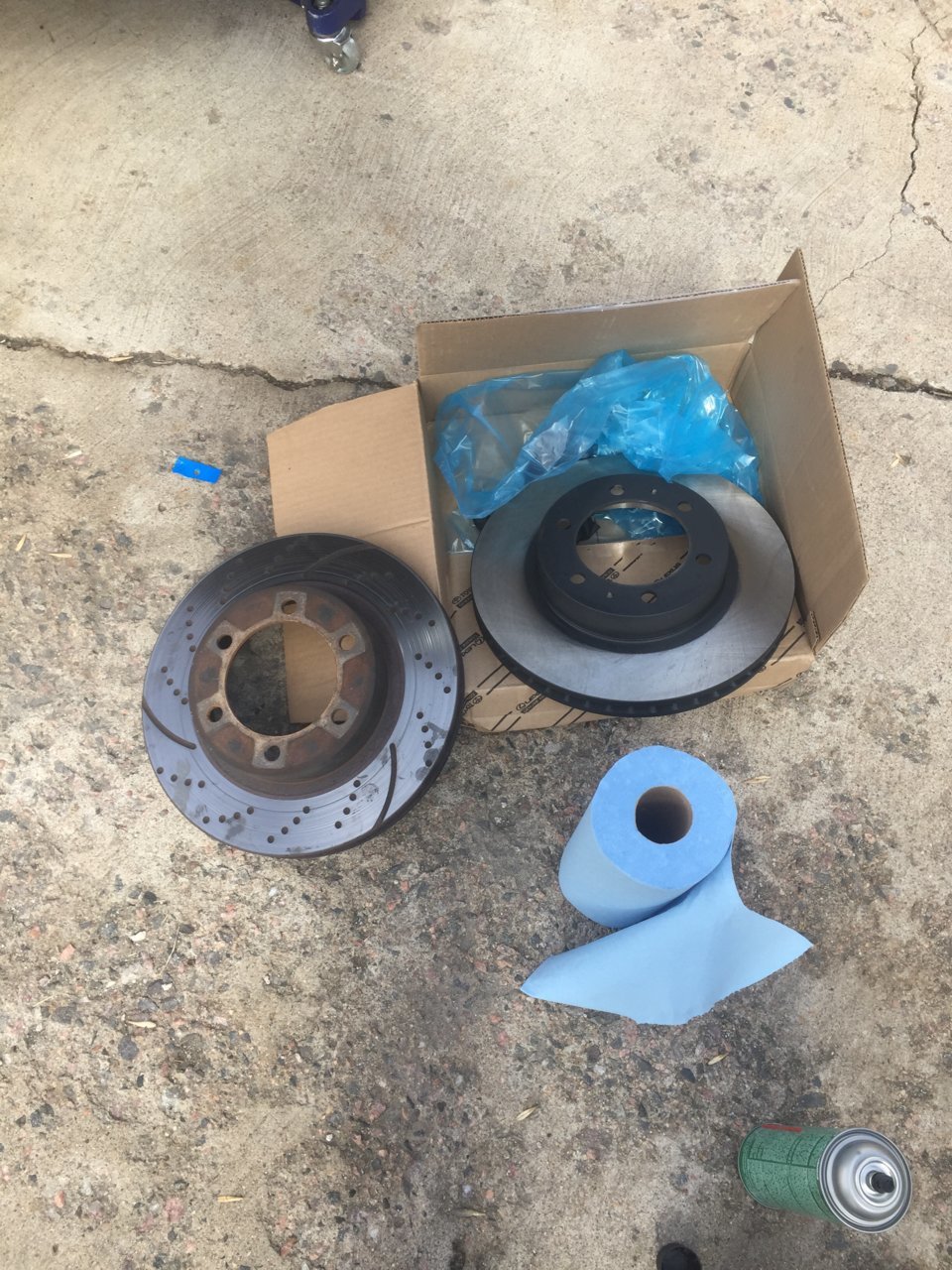

    Nice!!
    I though about that,but wanted to stay away from the drilled rotors..

    I normally dont recommend them since i have changed them out for people who have cracked them however, these are the most expensive rotors i’ve ever personally owned...so i thought i would try something different.
    Next time i’ll stick with slotted

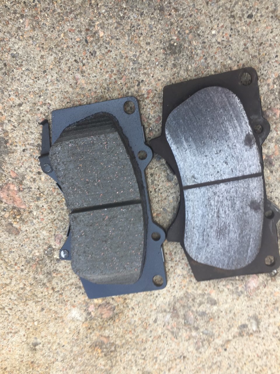

    Ya I thought about slotted, figured I’d go back to the OEM rotors,and try the ceramic pads..
    Trying to find a place to do the break in with the slotted rotors and more aggressive pads is a pain in the ass..
    Traffic is so heavy all the time

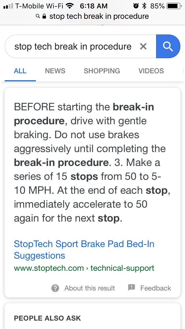

    I-25... break in on the way to work with all the stop n go

    I just use the right lane of rt40 and leave my flashers on lol

    Depends on the time of day
    It’s almost impossible to do this

    I did 10 60-5mph stops and they were hot. Had my fluid almost boiling.
    So now its time for new brake lines and new fluid.
    I’m also now at 90k, so i’ll be doing new rear brakes at 100k

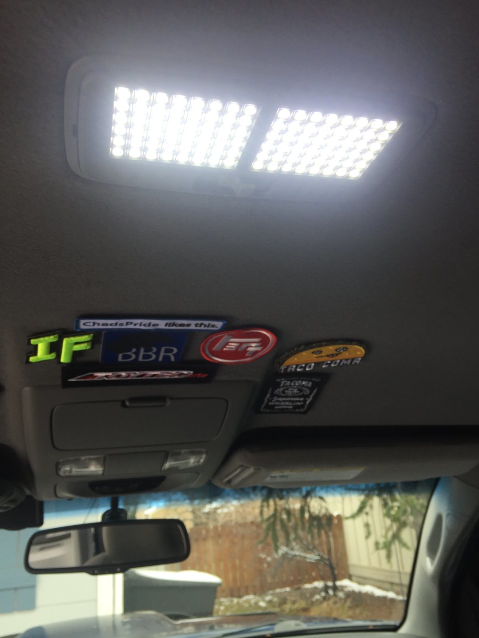

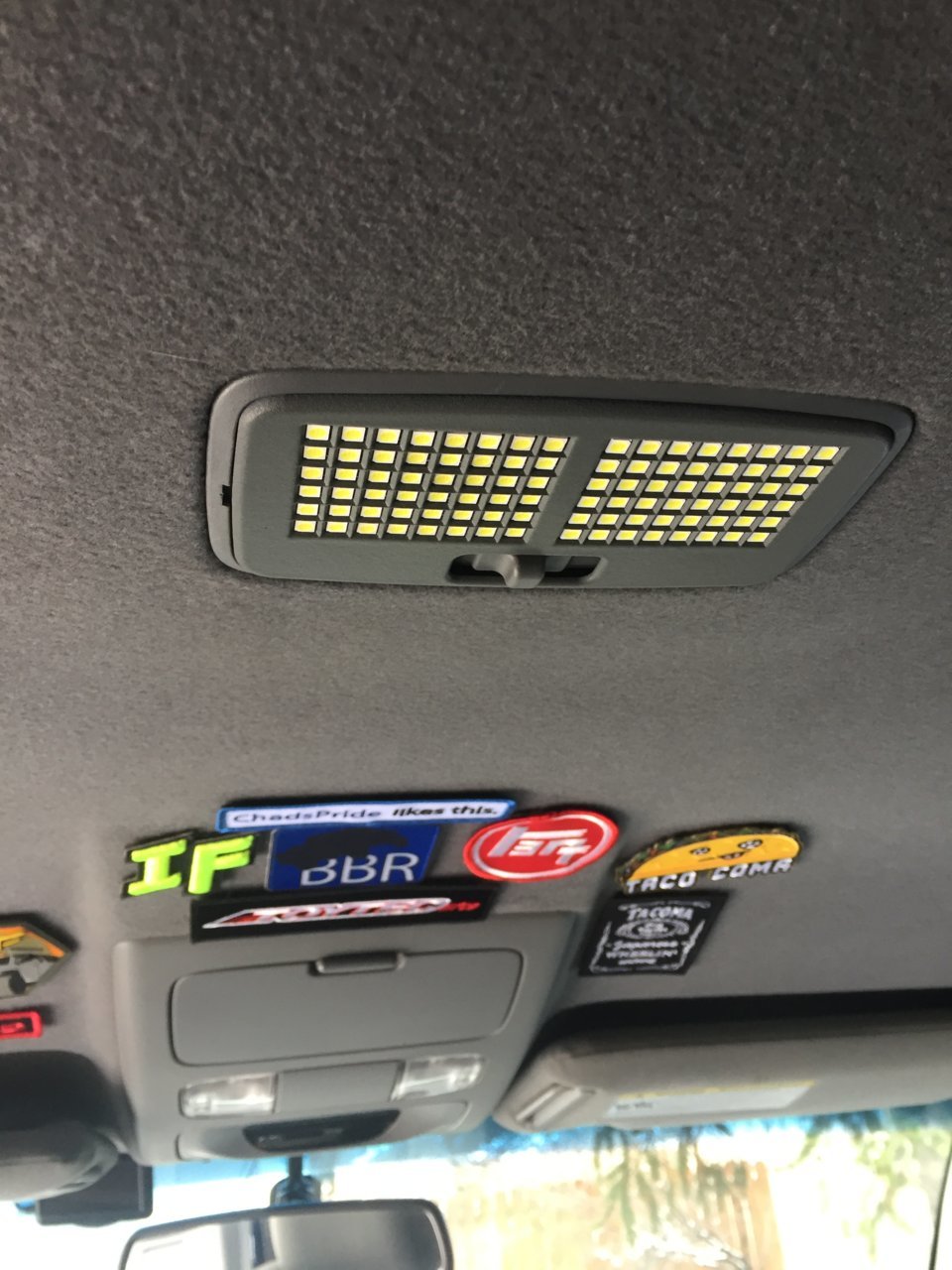

    424E52D3-6F20-4D64-89FF-5C212F1F5DBC.jpg 223EA0A3-24AB-4DE9-A8AD-89D693F7EF6A.jpg @mesojdm dome light in
    This light is bright
    :bananadance:
