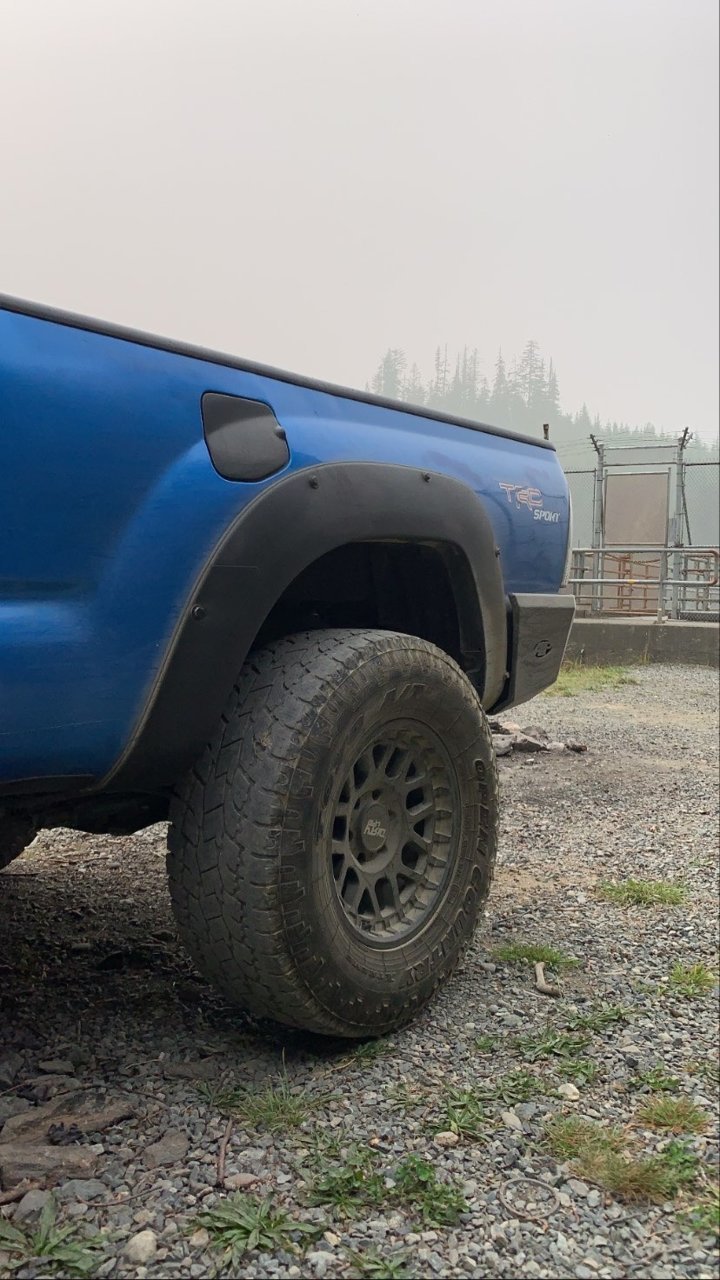

    Bilstein 6112 & 1/2” Spacer Bilstein 5160, 2 1/2” AAL & 1/2” block KMC Impact (17x9, -12mm) Toyo Open Country 285/75/17 JBA HC UCA
    305/70/17 open country ATs on dirty life mesa (4.5” backspacing, 9” rim width). Still running stock UCAs, got a ~2.5” Bilstein 5100 + OME 886 lift in the front, and 5100 + AAL in the back netting ~2” lift.
    To fit these: Flattened the pinch weld, cab mount chop, and cut the lower corner of the fender near the cab mount. I don’t feel like that’s much work in order to fit these tires, took me about 3 hours (about 45 mins of that 3 hours was cutting plates to close the CMC).
    Haven’t taken it wheeling yet, but so far on paved road and semi-violent logging road no rubbing whatsoever. I didn’t think I would clear my UCAs with only 4.5” BS, but I’ve got about a half inch between them and the tire’s sidewall. I’m convinced this is the perfect tire size.
    DISCLAIMER: I expect to do more trimming as I flex the suspension more over the next couple weeks. Totally worth it though, IMO.

    Taco_Jacko --
    - Any updates on rubbing?
    - Are those aftermarket fender flares? Did you have to trim those?
    - What kind of headlights and are you happy with them? How long have you had them?
