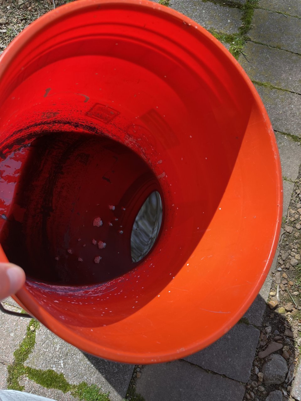

    image.jpg Wanted to post an update here - went ahead and changed out the rear fluid today. Glad I did! Thanks for the tips

    I’ll be doing both diffs next weekend. If the rear is anything like the color of my engine oil at 6k it won’t be too soon. Front gets used pretty often and I try to stick to the recommended minimum 10 miles a month in 4x4 to keep it lubed. 25k on the clock as of today.
