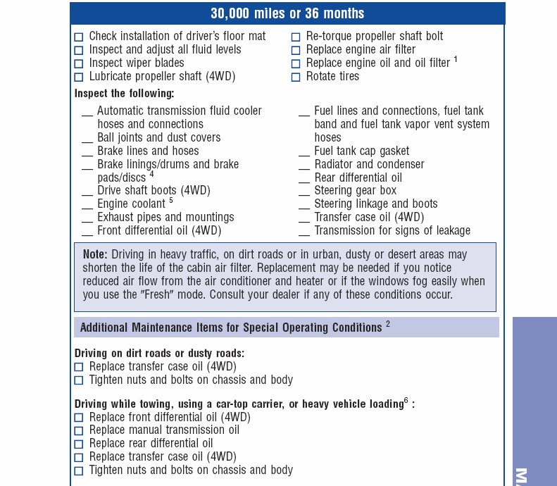

    You can pre-buy maintenance service contracts called Toyota Care. It's in addition to an extended warranty contract.
    It includes all major services but not those on the OPs list, only what's listed in the maintenance manual like the screen shot above. Also anything that's in "special condition" category isn't covered. I bought one & fought like hell for the diffs, trans fluid changes because I tow and bought a truck with a factory tow package. My dealer said it was "extra" and Toyota Care wouldn't reimburse it. I wish I had known enough to ask specifically about that when I prepaid. :( That's on me :(
    Also any work you do yourself can get entered into the Toyota Owners section on the toyota.com website where all services are noted by the dealer.

    Snake Oil for the most part. OEM does NOT recommend that at ALL, here is the ACTUAL OEM 30k.
    30,000 Miles or 36 Months Recommended Service
    Check Installation Of Driver's Floor Mat
    Rotate Tires
    Inspect Front Differential Oil (4WD/AWD, If Applicable)
    Inspect Rack-and-Pinion Assembly
    Inspect Radiator, Condenser and/or Intercooler (If Applicable)
    Inspect Transfer Case Oil (4WD/AWD, If Applicable)
    Inspect Transmission for Signs of Leakage
    Inspect Wiper Blades
    Inspect /Adjust All Fluid Levels(1)
    Inspect Ball Joints And Dust Covers
    Inspect Brake Lines And Hoses
    Inspect Rear Differential Oil
    Inspect Drive Shaft Boots
    Inspect Engine Coolant
    Inspect Steering Linkage And Boots
    Inspect Brake Linings/Drums And Brake Pads/Discs(2)
    Inspect Exhaust Pipes And Mountings
    Inspect Cabin Air Filter (If Equipped)
    Inspect Fuel Lines And Connections, Fuel Tank Band And Fuel Tank Vapor Vent System Hoses
    Inspect Fuel Tank Cap Gasket
    Replace Engine Oil And Oil Filter(3)
    Replace Engine Air Filter
    Lubricate Propeller Shaft (4WD/AWD, If Applicable)
    Torque Propeller Shaft Bolt (4WD/AWD, If Applicable)

    1. Is total BS
    2. Is total BS
    3. No issue
    4. Is total BS
    5. Hahahahahahahah BS
    6. Lollers BS
    7. Nothing to it
    No, see daddy o's post.

    Brake fluid exchange service, LOL. Be glad you found this forum! Not sure what the manual says for a 2.7, but probably the MOST you would need from the dealer is:
    - Oil change
    - Retorque flange bolts (I know they always list this, have never had mine loosen but nice to check while under there)
    - Engine air filter
    - Tire rotation (check your psi after, they always overinflate)
    - Lube driveshaft if it has zerks, but don't think yours does
    - Front, rear diff oil and transfer case oil (if 4x4, and if you don't wheel it you could probably wait to 60k, if 4x2 only rear diff is needed)
    - If you've never replaced the cabin air filter, might as well do that too
    You shouldn't need new transmission fluid at this point, nor new brake fluid, and all that cleaning and conditioning is crap. I assume you can buy a bottle of washer fluid and pour in yourself.
    Take it somewhere else with the maintenance schedule doc and just ask them to do what is listed for the conditions you use the truck in (towing, etc.).

    This may already be mentioned. But the service manual tells you what you need at 30k and it’s just an oil change. Tire rotation. Air filter.
    The service manual doesn’t even have half that shit in it.
    https://www.toyota.com/t3Portal/document/omms-s/T-MMS-17Tacoma/pdf/T-MMS-17Tacoma.pdf

    Looks like they automatically assume you need the 'Additional Maintenance for Special Operating Conditions' Tell them you don't have those conditions and ask for a NEW quote.
    30,000 miles or 36 months
    Check installation of driver’s floor mat
    Inspect and adjust all fluid levels
    Inspect wiper blades
    Lubricate propeller shaft (4WD)
    Re-torque propeller shaft bolt
    Replace engine air filter
    Replace engine oil and oil filter 1
    Rotate tires Inspect the following: _ Ball joints and dust covers _ Brake lines and hoses _ Brake linings/drums and brake pads/discs 4 _ Cabin air filter _ Drive shaft boots (4WD) _ Engine coolant 5 _ Exhaust pipes and mountings _ Front differential oil (4WD) _ Fuel lines and connections, fuel tank band and fuel tank vapor vent system hoses _ Fuel tank cap gasket _ Radiator and condenser _ Rear differential oil _ Steering gear _ Steering linkage and boots _ Transfer case oil (4WD) _ Transmission for signs of leakage NOTE: Driving in heavy traffic, on dirt roads or in urban, dusty or desert areas may shorten the life of the cabin air filter. Replacement may be needed if you notice reduced air flow from the air conditioner and heater or if the windows fog easily when you use the Fresh mode. Consult your dealer if any of these conditions occur.
    Additional Maintenance Items for Special Operating Conditions Driving on dirt roads or dusty roads: Replace transfer case oil (4WD) Tighten nuts and bolts on chassis and body Driving while towing, using a car-top carrier, or heavy vehicle loading : Replace front differential oil (4WD) Replace manual transmission oil Replace rear differential oil Replace transfer case oil (4WD) Tighten nuts and bolts on chassis and body
