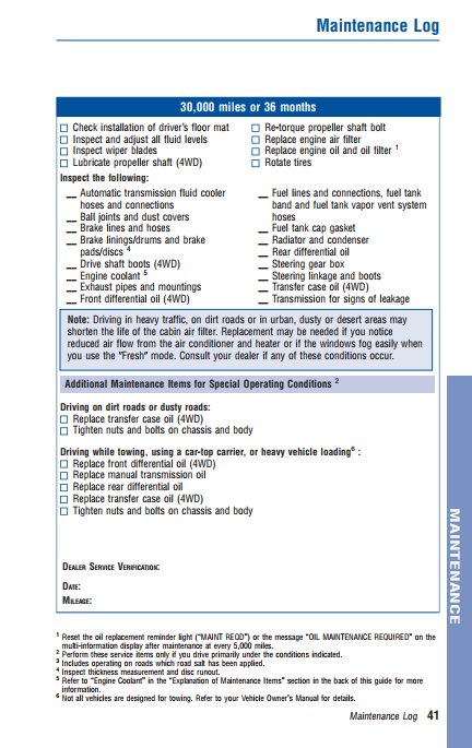

    Engine filter is only needed if dirty
    Coolant - good till 90K
    Battery terminal cleaning is only corrosion is present
    Drivers floor mat - WTF?
    Install premium engine oil and fuel system conditioners - maybe this is a fuel service? Ford recomends that at 30K but not needed if you use higher grade gas.
    Crackcase oil cleaning service - WTF?
    Fuel/Air induction clean up service - maybe part of fuel service
    Rear diff - good till 70K
    Brake fluid - good til 70K
    Mass air flow sensor cleaning - maybe part of fuel service
    Auto trans fluid - good till 90K
    Front diff - good till 100K if you use 4x4 like every fucking day for 80 percent of your driving, if you dont use 4x4 much then bump that up to 150K
    Transfer case - same as front diff, fluid does not heat up(oil breaking down) unless when in 4x4
    As a tech at a ford dealer (toyota dealer wasnt hiring) these specs are what we use for fords but they should transfer over to toyota.
    At my dealer someone comes in for a oil change/tire rotation package and I look at the mileage then do a quick(27 point) inspection, then check the history before recommending any of the shit on the list they gave you.

    All this shit is in your owners manual, but regardless you should not need any fluid flushes till you hit at least 60K, im lowering it cause i dont know toyotas recomended service intervals. 30k service wise is basically still a new car.

    $20 they don't even change the fluids in the transfer case and diffs.
