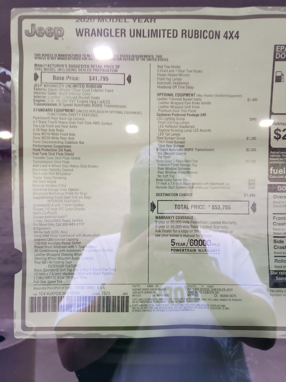

    What are u pointing out? Price?

    Pointing out how the 285s look on the jeep, only 1" taller than 265 70 17s. The price sheet confirms the tire size in lower left corner.

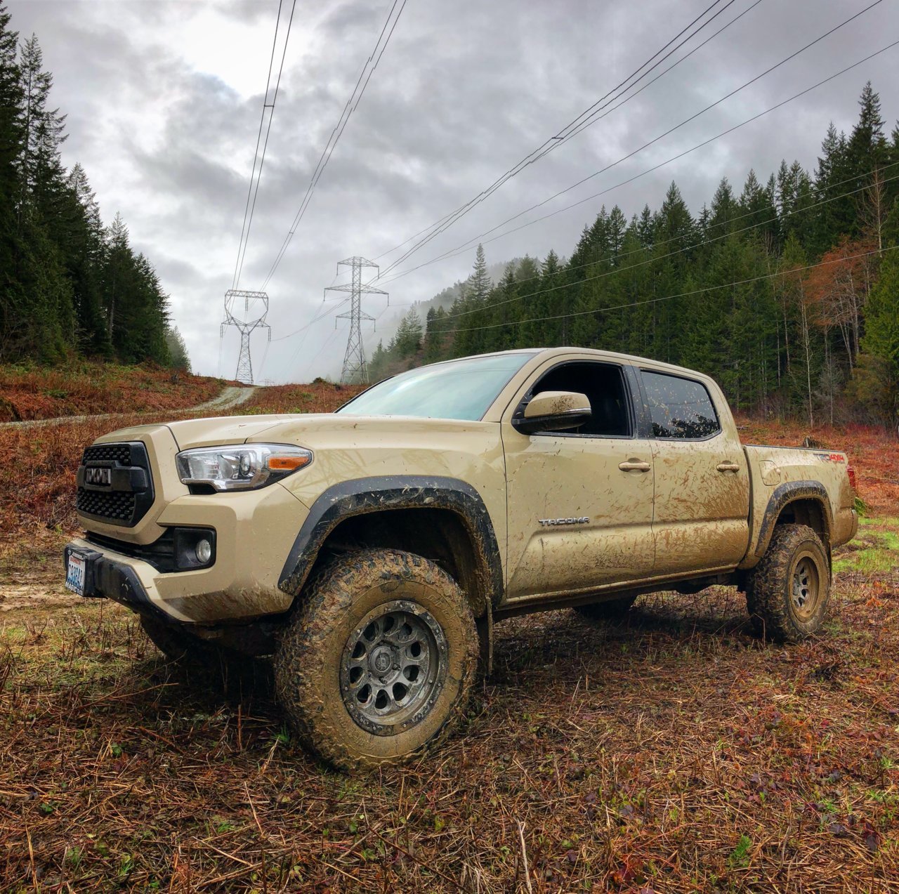

    I agree with you! I'm on 265/75/16 C load ATs. Although 33's would be great for clearance I haven't been anywhere yet where I felt super limited by 31's. Unless you are doing some serious crawling, you can definitely go have fun and run a lot of trails with 31's!
    Also the 33's with methods are a pretty tired look around SoCal...
    Here's my current setup.

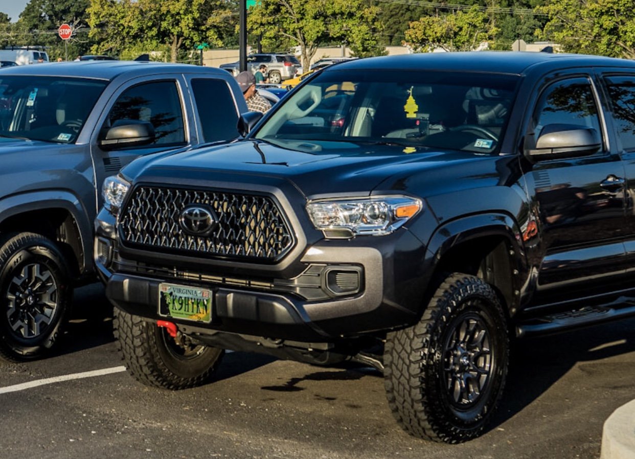

    Really not sure why more people dont run a 275/70/17 on these trucks. 32.2" X 10.8"
    Lifted on OME medium lift, stock UCA, no CMC and mudflaps in place. No rubbing wheeling the truck and its been lifted for 35K miles :shrug:

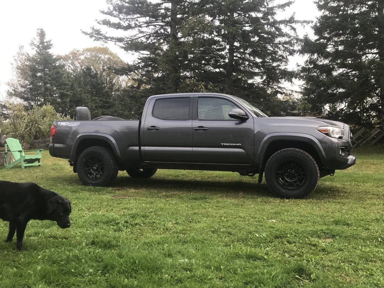

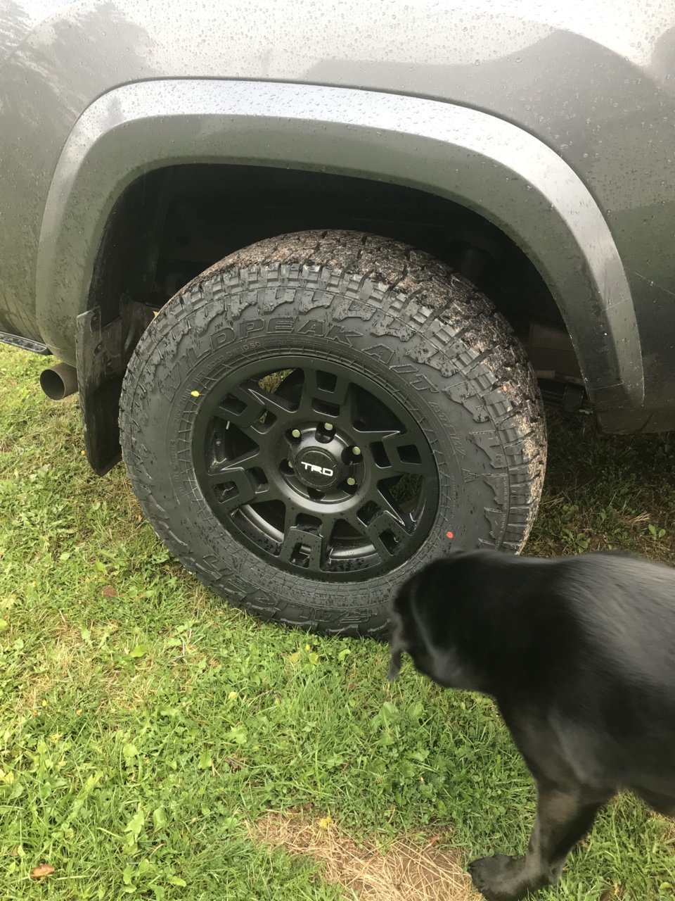

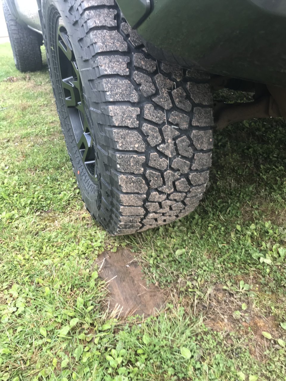

    Here we are folks, also you’ll notice I have a TRD decal on the rear wheel. Trying to decide wether to run with or without them.
    Edit, yes they rub never checked to see what. I’m guessing the mudflap, but they are staying on so I’ll have to get out the heat gun.
