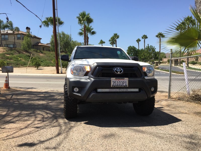

    Hello everyone in the 5 lug community, I am going to talk about the 31 inch tires and how I feel about them so far. Knowing very little about how a car works our how tire size can effect a car I would like to tell you what I have learned so far. @4wheelparts I got my lift,rims,tires,alignment, and everyone else done there with a huge price tag. Originally I went in with wanting to get 30 inch tires, but the quick salesmen got me hooked on the 31s. Now this is my fault for not researching before hand and seeing many of you rolling in those 31s I was very interested and hungry to put the biggest shoes on. I honestly don't like the drive with the automatic transmission stock gears at 3.58. I feel that I am very under powered and need better gears or smaller tires every time I hit a hill. I mean every time I hit a hill and even before hand I had to push the truck hard up hills with the 215s but it wasn't as brutal to say the least. I am most of the time in 3rd gear, unless I'm on flat or not on the highway. I was wondering what you guys think I should do I honestly am thinking about just going down a tire size from 365 to 335. I have seen 5lugfurys 335s and I honestly think those would be a much better spec for my truck and hills here in California. If I lived somewhere flat I wouldn't mind the 31s with stock gears, but as of now I am considering removing the 31s and going down to 335s. I recommend anyone who is considering the 31s to please research and think twice before you go to that size. You will be in 3rd gear majority of the time to get up any hills. I just thought I would inform anyone on the site about my experience as it has not been as much as planned. I will hopefully be getting some smaller 335 size tires.
    I did some math and here is the calculator on gear ratio just as a estimate of what size tires ect.
    215/75/15 effective gear ratio 3.21
    265/75/15 effective gear ratio 3.91
    new tire size
    335/75/15 3.7
    still trying to figure out what to do any advice guys I don't know if I should just keep the 31s till they wear out which will be a long as time or just try and sell them and buy the 335s or even 325s.
