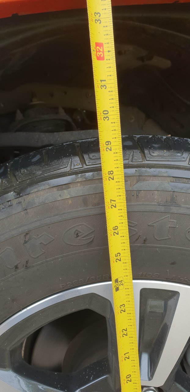

    They are 30.6”, 31” tires fit without modification. Using a tape measure with the tire on the ground is not how tire diameter is measured

    I don't know where the tires came from that are currently on your truck. That looks like 265/65/? I assume 16", can't see it for the ruler. If so it is 29.6". But 30.5" tires are what come from the factory on Tacoma's. You won't have any issues with a 31" tire on a stock suspension. I'm using 31.6" tires and have plenty of room.

    Tires compress when a heavy truck is on top of them. Thus, 30.6s meaure out to 29s. Same will be true with a larger tire.

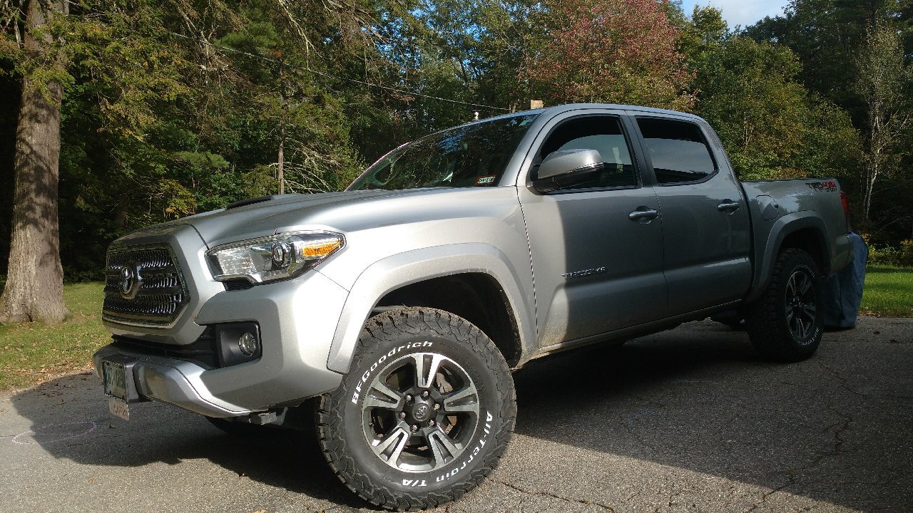

    I have 265/70/R17 BF-"Bros" and do not have any rubbing. I do not have mud flaps and took off my "chin strap," but it did not rub on that either. IMG_20180924_164342501.jpg
