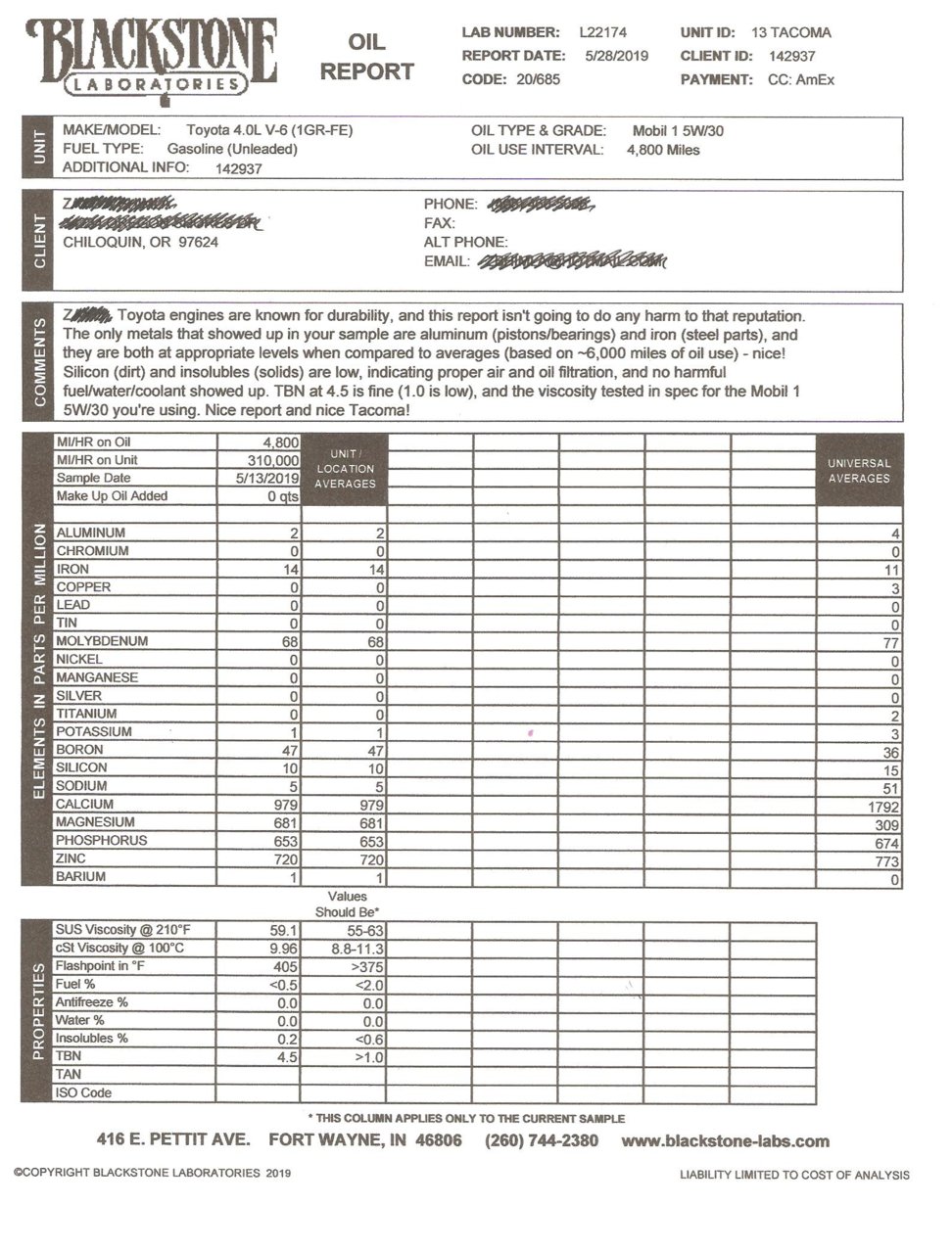

    I have never done an oil study on my taco
    here is the results from the first one at 310k miles
    I think I will stick to changing my oil every 5k miles

    wondering where that '15k oil change interval' troll is?????
    sure he will pop up soon
    ha
    honestly, I dont care how often anyone changes their oil
    life is toooooo short to worry that much
    to each their own
    I just want to share that I found great success in motor longevity by changing my oil every 5k like toyota suggests
    my main reason for changing oil every 5k miles is so I always arrive to my destination
