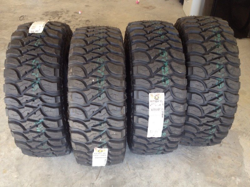

    I just bought some new 315/75R16 MTZ's and seeing how no one really has a good review thread here for them I'd figure I'd make one for as long as I have them. Will review at 5k mile marks during the duration of their life. Tires will be subjected to on-road including highway driving as well as heavy off-roading. They will also be rotated every 4k.
    Bought them from 4wheelparts for $1160 to my door with a $100 warranty that covers lifetime of all repairs as well as full replacement, no questions asked before half tread mark. I figured, what the hell.. wouldn't hurt.
    Specs
    Actual Measurement: 34.49x11.9
    Weight: 67lbs
    Ply: 10(E)
    Tread Depth: 19/32
    These are some seriously badass tires :D

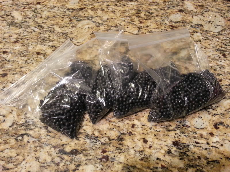

    Tires are doing great.. I'm actually bout to rotate them before a 3 day event at the ORV park next weekend. Pretty close to the 10k mark I think, if not over a little. I'll have to check my initial mileage written down somewhere. I'll take some pics of the tires and write a review soon for the 10k mark. Also, gonna be throwing these in once I get some time.

    why do you put stuff in the tires??? what is the benefit there?

    ^^ Correct. I plan to leave what wheel weights I have on but the beads will help with loss of weights and reduction of tread wear over time.
