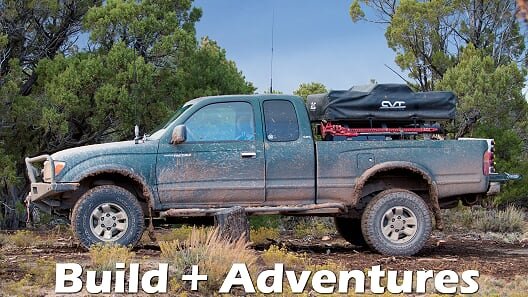

    Yep, these will fit just fine. Here's a pic of mine (these are Duratracs @ 31x10.5 R15).
    Generally you don't need to do much up through 32's, and then you just have a bit of rubbing in the front on 33's where you have to bash the pinch weld behind the fender liner.
    y4m7gyfqmiizyVaPaSodzMWGV9W3qtJN3SVK-5JJ_f385f866fad00c814ccaa106edcee96c27d404f6.jpg

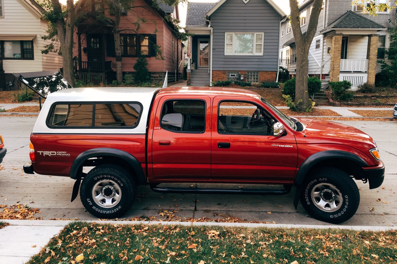

    31X10.5X15s fit just fine on my 2003. Granted, it does have the TRD pack.vsco-photo-1.jpg

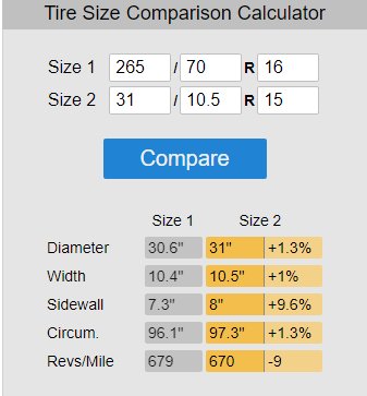

    One more point mentioned here that I'd like to add on to also is that those pickups, like mine, that came from the factory with the 225/75r15 tires have speedometers and odometers internally geared for the larger 265/70r16 tires.
    Meaning, my speedometer has always been about +5% off; Actual speed of ~65mph reads ~70mph on the speedo and my overall mileage on my odometer is 5% higher than actual total mileage. So, putting on the larger 265/70r16 or similar 31/10.5r15 tires would actually make the speedo and odometer accurate.
