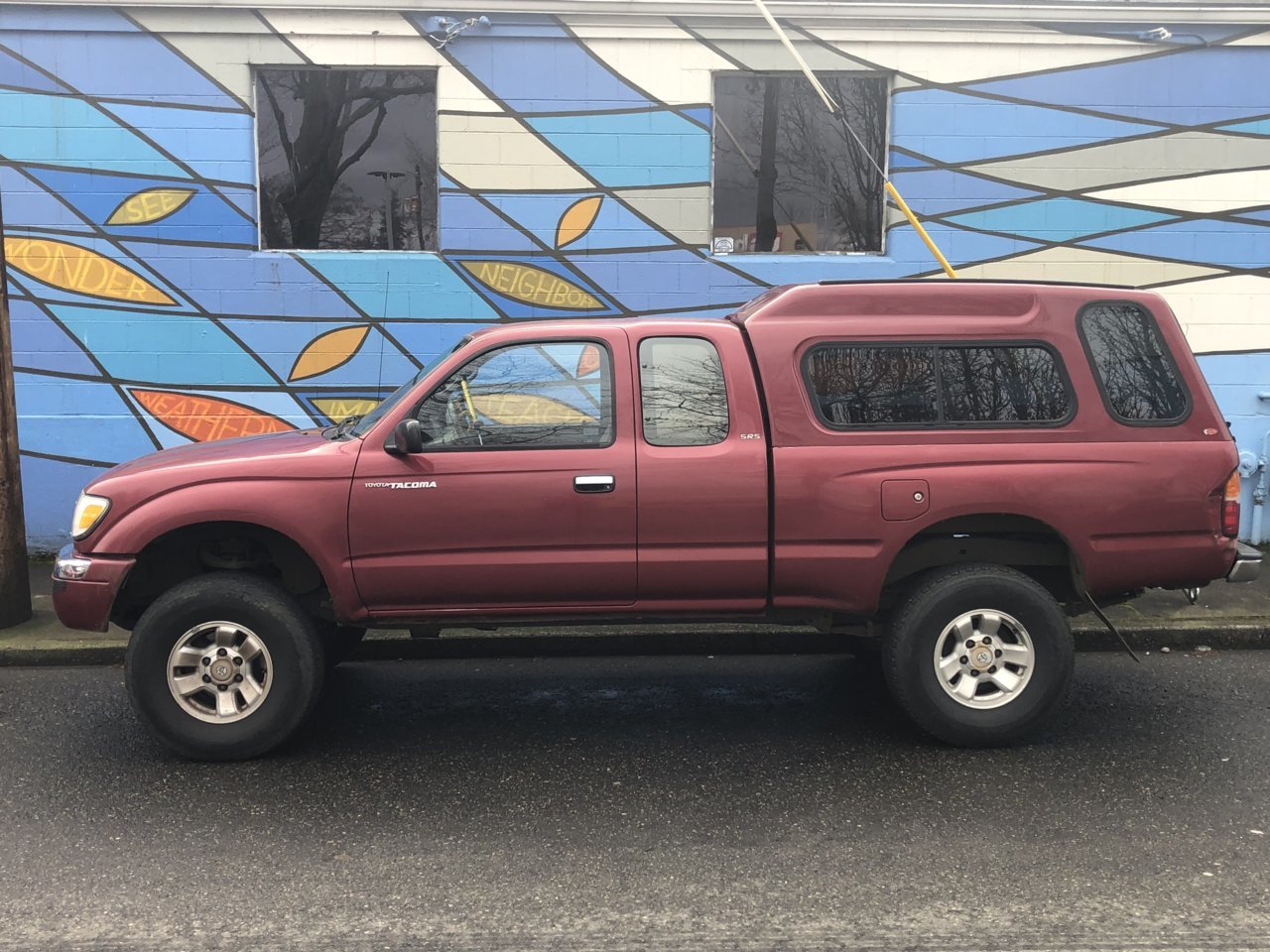

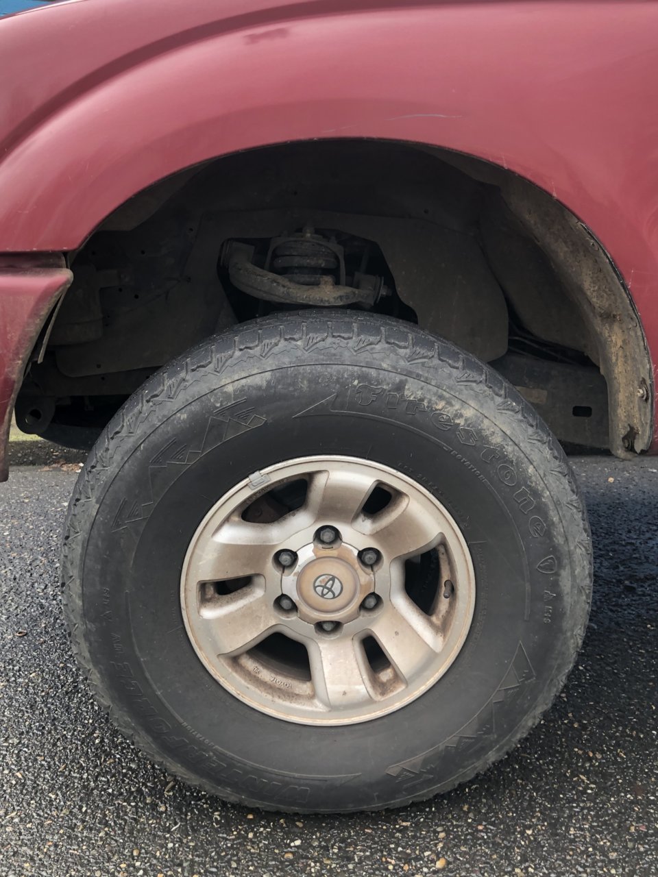

    Hello all! I’ve got some questions about new(ish) tires….

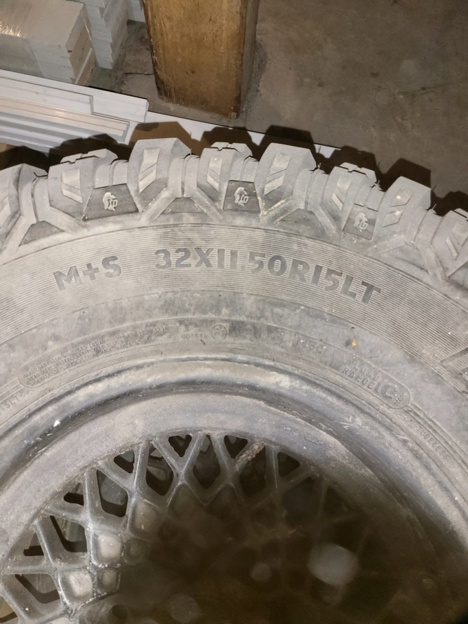

    Back story, I’m driving a 98 Toyota Tacoma SR5 4wd with stock 15x7 alloy wheels on it right now (photo #1 & #2) with a 3” old man EMU lift. My current gear ratio is 3.9…and I won’t be able to re-gear for a few more years ($$), however I’d like bigger tires!! Right now I’m cruising on some Firestones (p265/75/r15).. I have an opportunity to purchase some decent tread used tires; Cooper Discovery SST’s (32/11.50/r15LT, photo #3); $500 for 4, or I can buy some brand new tires that are also 32’s (BF Goodrich LT32/11.5/r15 KO2’s, photo #4) for $900, for 4.
