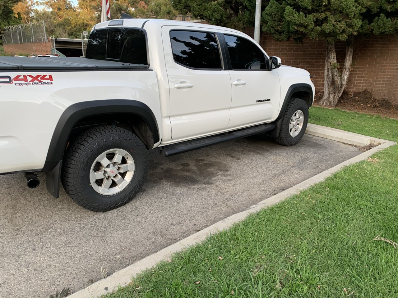

    Just picked up these wheels yesterday. Just had questions on the stance.

    Looks good, leave it alone!
