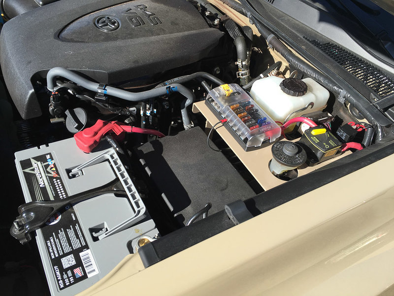

    Installed mine earlier this week. Well designed and fabricated parts. Thanks again Chris.

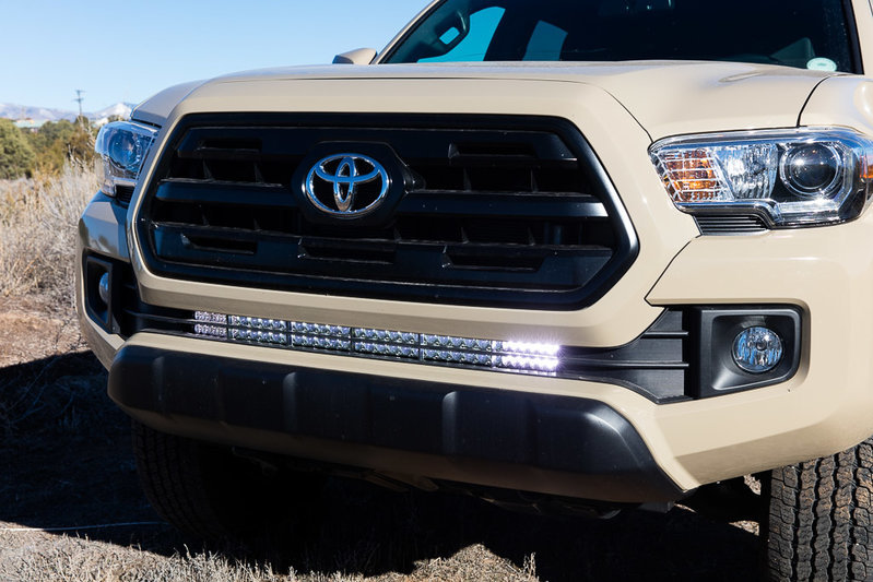

    I installed a Rigid E2 30" LED light bar (Hyperspot/driving) with the Apex mounts. The slightly shorter length of the Rigid bar (31.5" between mounting faces) compared to the Cali Raised bar required the use of three stainless washers on each end. Solid as a rock, light pattern not obstructed by the grill and not easy to steal. Great mounts.
    Powered the Rigid E2 30" bar from my Aux Fuse Block (See https://www.tacomaworld.com/threads/aux-fuse-block-install-with-clutch-fluid-reservoir.412165 )
    Controlled by an Air-on-Board switch in the center dash.

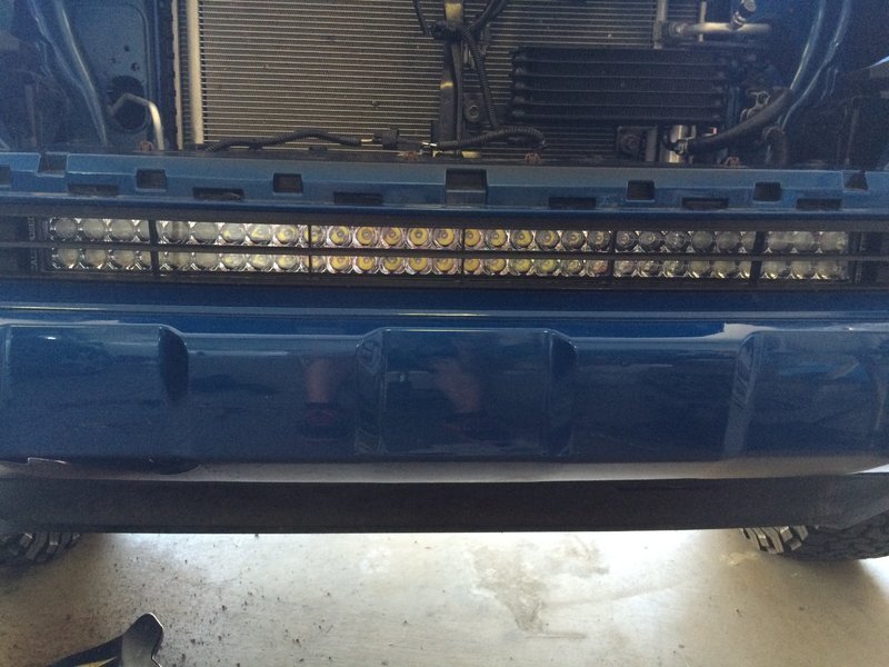

    Installed my light today. Sent Chris a PM at my most frustrated moment and he wrote back almost immediately and gave me the info I needed. Very awesome customer service. BTW if you got the Caliraised bar you'll need to use washers along with the short bolts in the package. Chris recommended a flat followed by a locking Washer. This worked perfectly. I followed @Woody79's wiring instructions to the letter and it went perfectly. Very happy with the light output and the mounts are solid as hell. image.jpg
