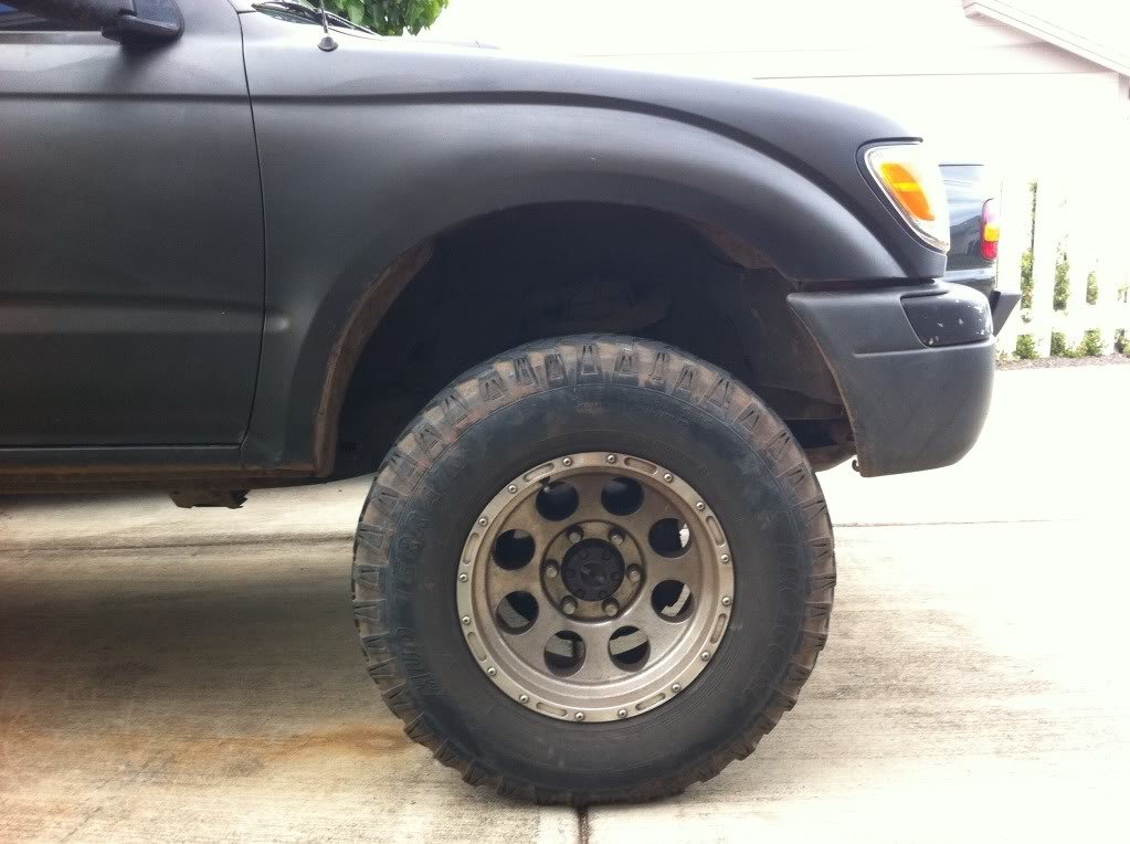

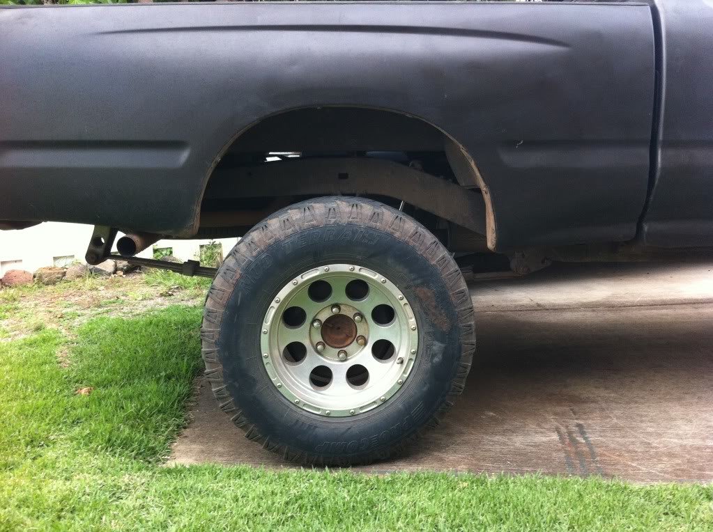

    Do you guys think it will fit 32 x 11.50 x 15? Is it to wide? Currently I have 265/75/16. Any help would be appreciated.

    I got 33x12.5/15, I had to trimm my front bumper just a bit

    What size rims are those? (width)
    I ran with 32x11.50's on the stock alloys (15x7 - not sure what the backspacing was) on my 96. I had to run a lower tire pressure to ensure even tire wear. I also had 2" of lift and I offroaded the truck a lot.
    11.50 wide tire should be on an 8" wide rim minimum.
    Your tires now (265x75/16) are 31.6x10.4/16.
    So, you're only gaining less than 1/2" in overall height and 1" in width.
    The width of the wheels & the backspacing will make a difference in if you get rubbing or not. I'm gonna guess, you'll get minor rubbing at full turns.
