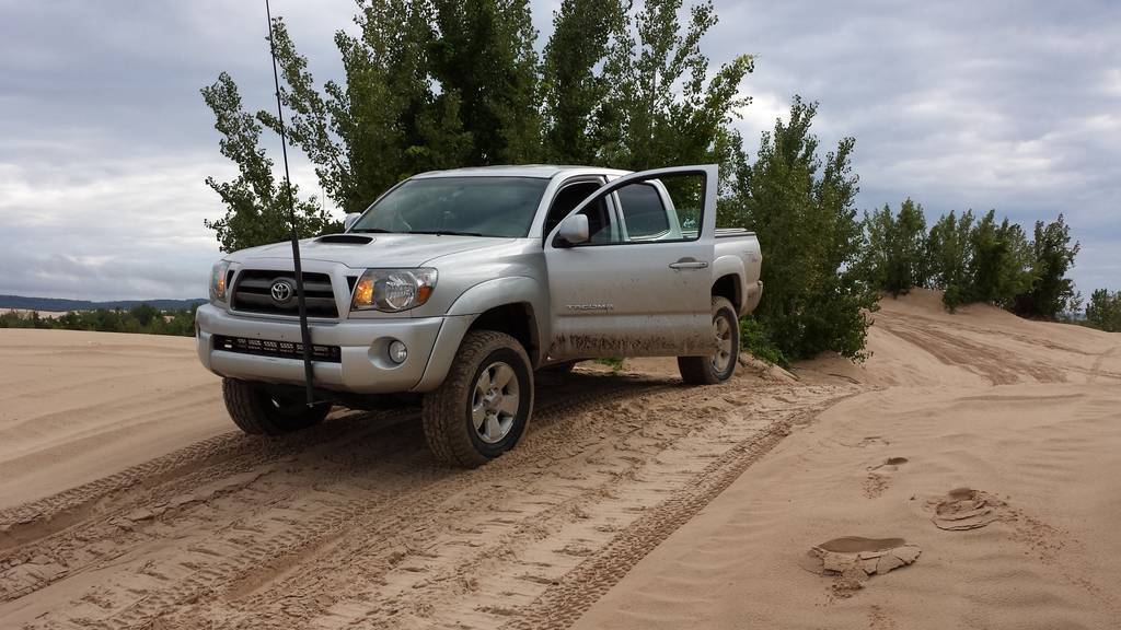

    I have cooper AT3s 275 70 17 on my stock 7.5 X 17 sport wheels.... Great tires for all around use but they are rubbing on the upper and lower control arms and the inside of the frame... So I want to get some after market wheels with less back spacing and STmaxx tires... For now I'll keep my At3 for winter, they are better on the road but the maxx are better offroad...
    So the big question if I go to the St Maxx should I stay with the 275 70 17 a 32" tire or go to the 285 70 17 a 33" tire??????? The maxx are about 1/2" wider than the at3s in the same size...
    My concerns are rubbing on the cab mount, it would be real close with the 285s, from 0 - 1/2" from my measurments... the wheels I want are a 8 1/2 X 17 1mm off set with 4.8 bs.... I don't know anyone that has done a cab mount chop in Wisconsin...... Or I would just get it done.... I do offraod and use full travel and I have a 2 1/2" OME full lift...
    2nd is reduced power and mpg... going to the 32s really dogged the motor down, I have overcome the 32s with a ton of tuning but I don't want to loose a ton of power going to 33s.... same with mpg I don't want to loose anymore mpg.... I lost 2 mpg going to 32s and got about 1 back with tuning... more for maintaining range than saving money.. I have a 3 to 5 hr drive to go offraoding and this is my weekend vehicle not my daily driver...
    I do offroad, lots off trails and sand dunes in MI, the 285 would be much better in the sand and look great the main reasons I want them....
    Is it worth going to 33s if I'm getting new tires or just stick with the 32s.... What do you guys think......
