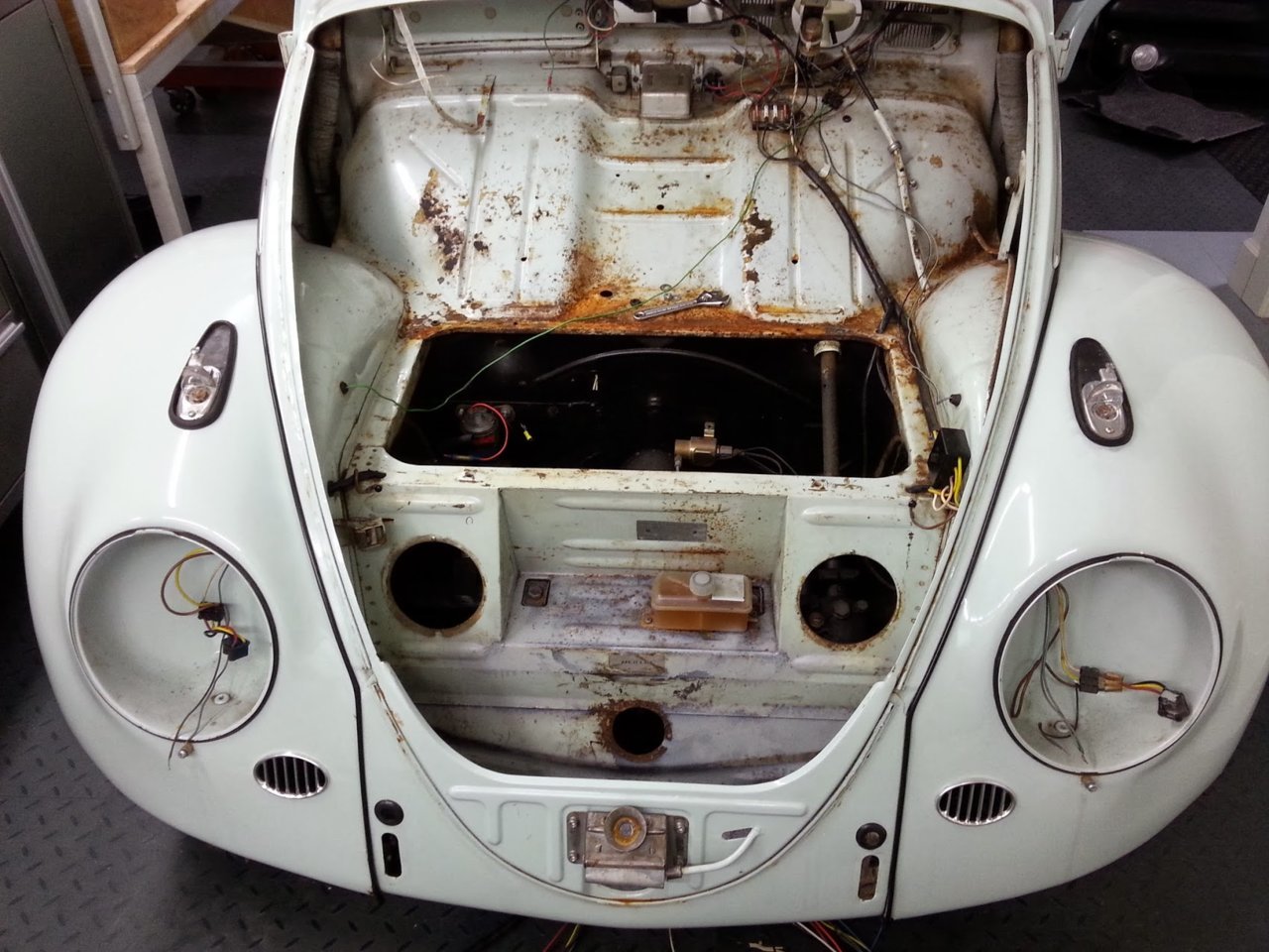

    This build has been ongoing for a few years now so it's going to be fairly time lapsed. It's a 1960 Canadian custom VW beetle - translation it was ordered as a stripper model giving it some unique features or lack there of.
    It's been a west (wet) coast car for most of it's life which means the more you dig into it the rougher it gets. Car has a fairly built up 2275, a built trans and some disk brakes, other than that it's pretty much you're standard early 60's beetle.
    Time for some pics....
    Original paint code for the car... 1 year only color

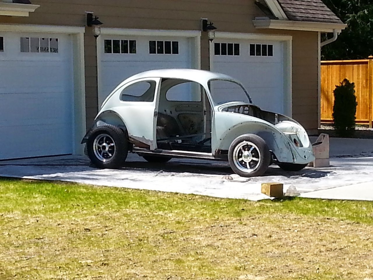

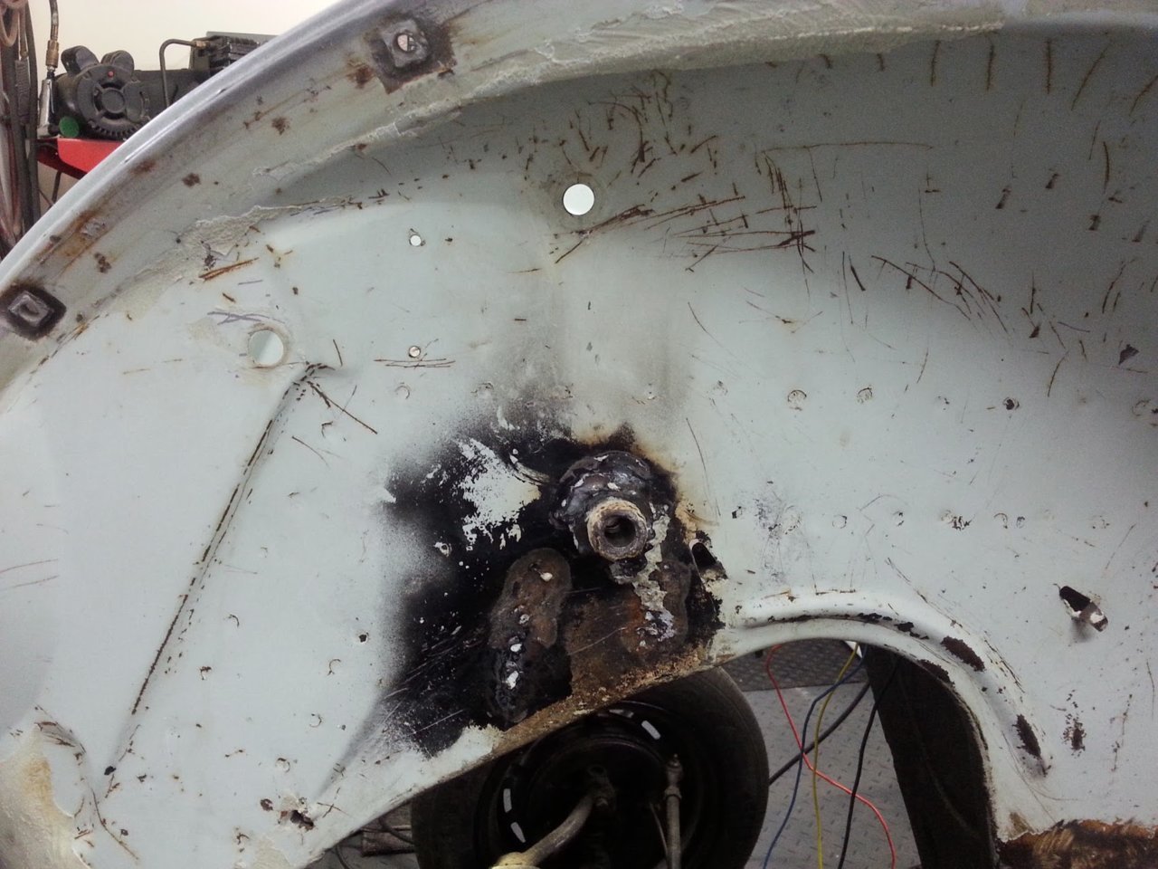

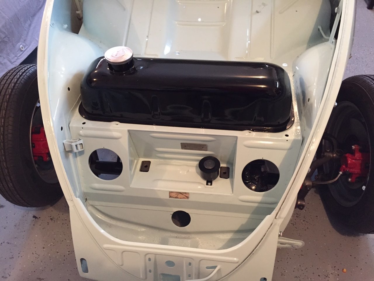

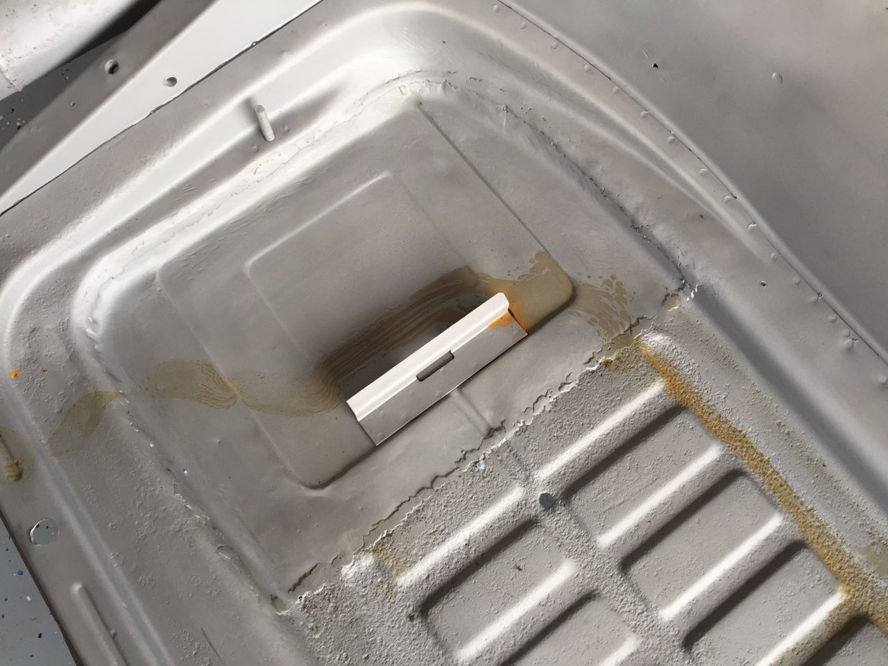

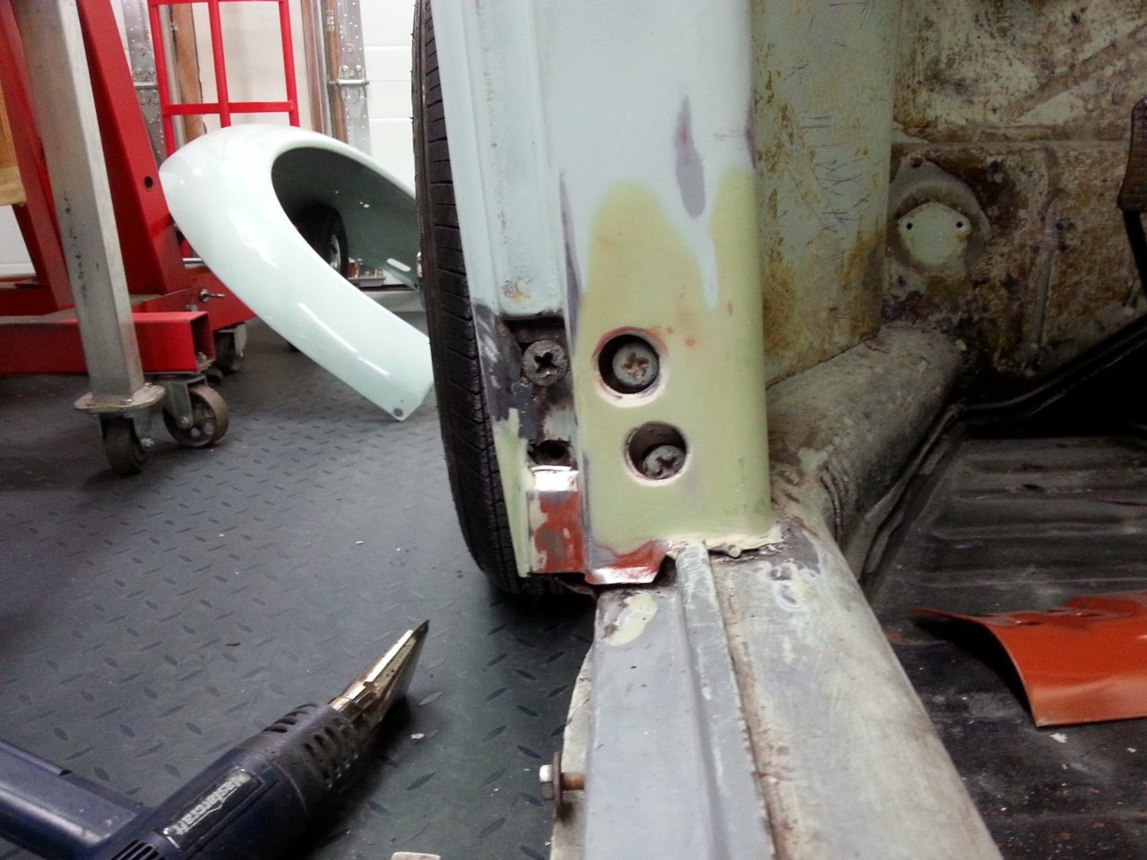

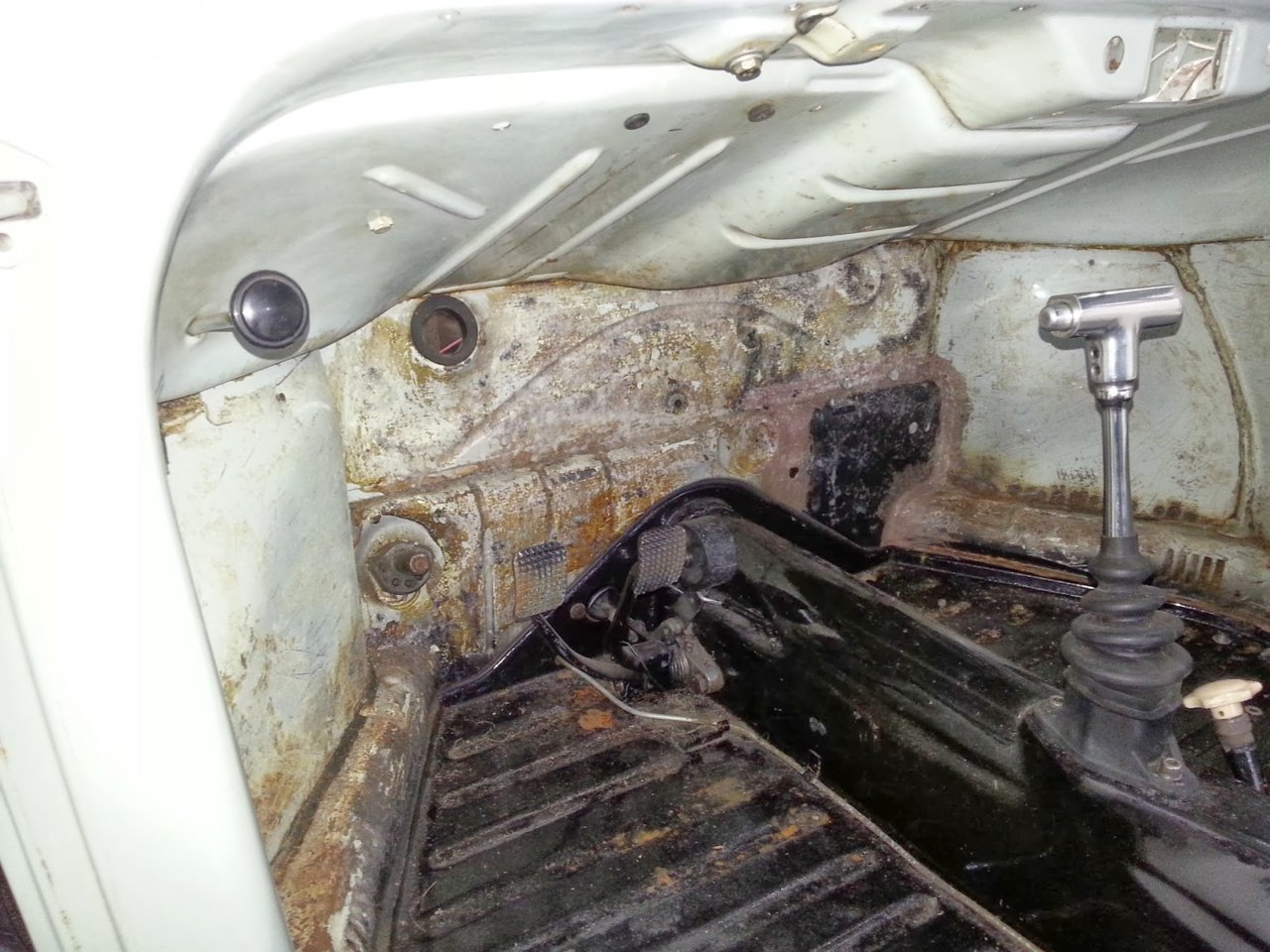

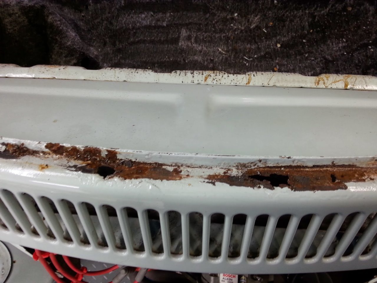

    Ok so this was unexpected. Car came with a lowered/narrowed beam and no shock towers, the answer to this was welding a nut to the sheet metal of the body and using it as a shock mount.....seriously?
    Heater channels required on both sides... of course

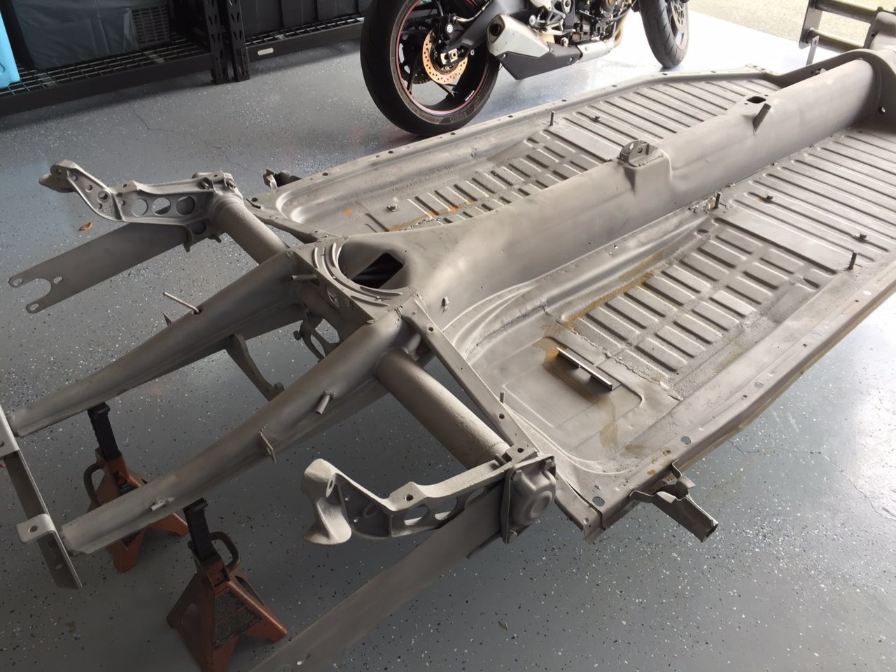

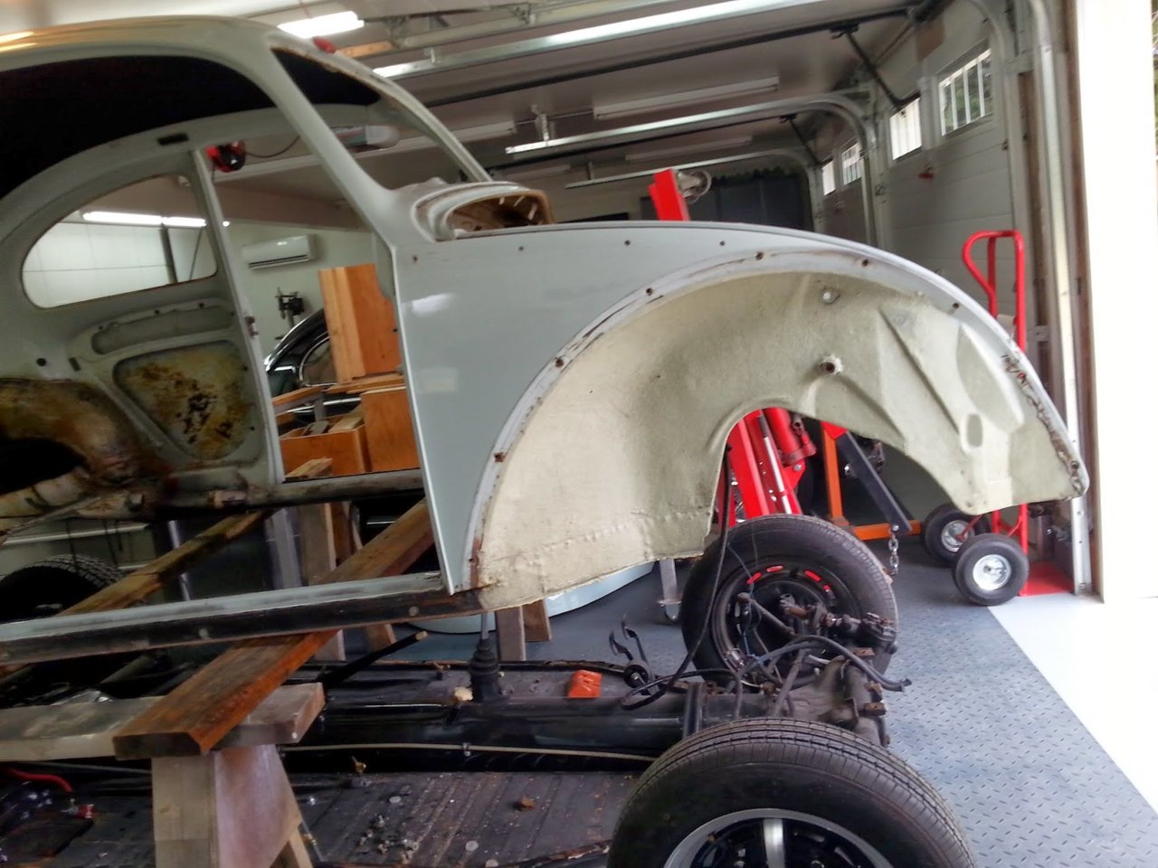

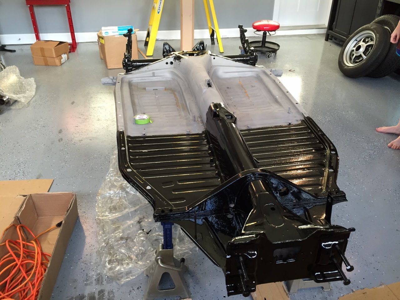

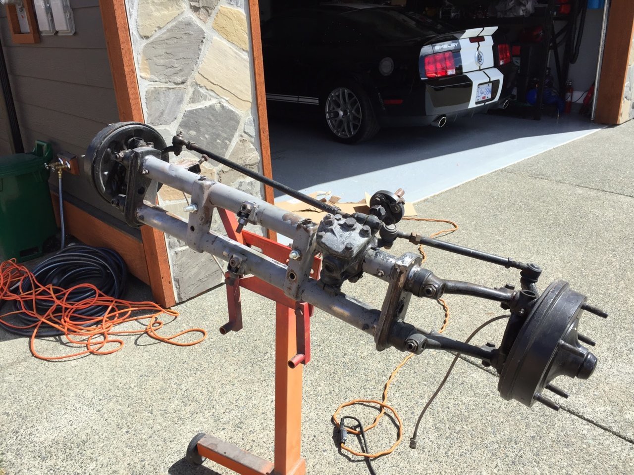

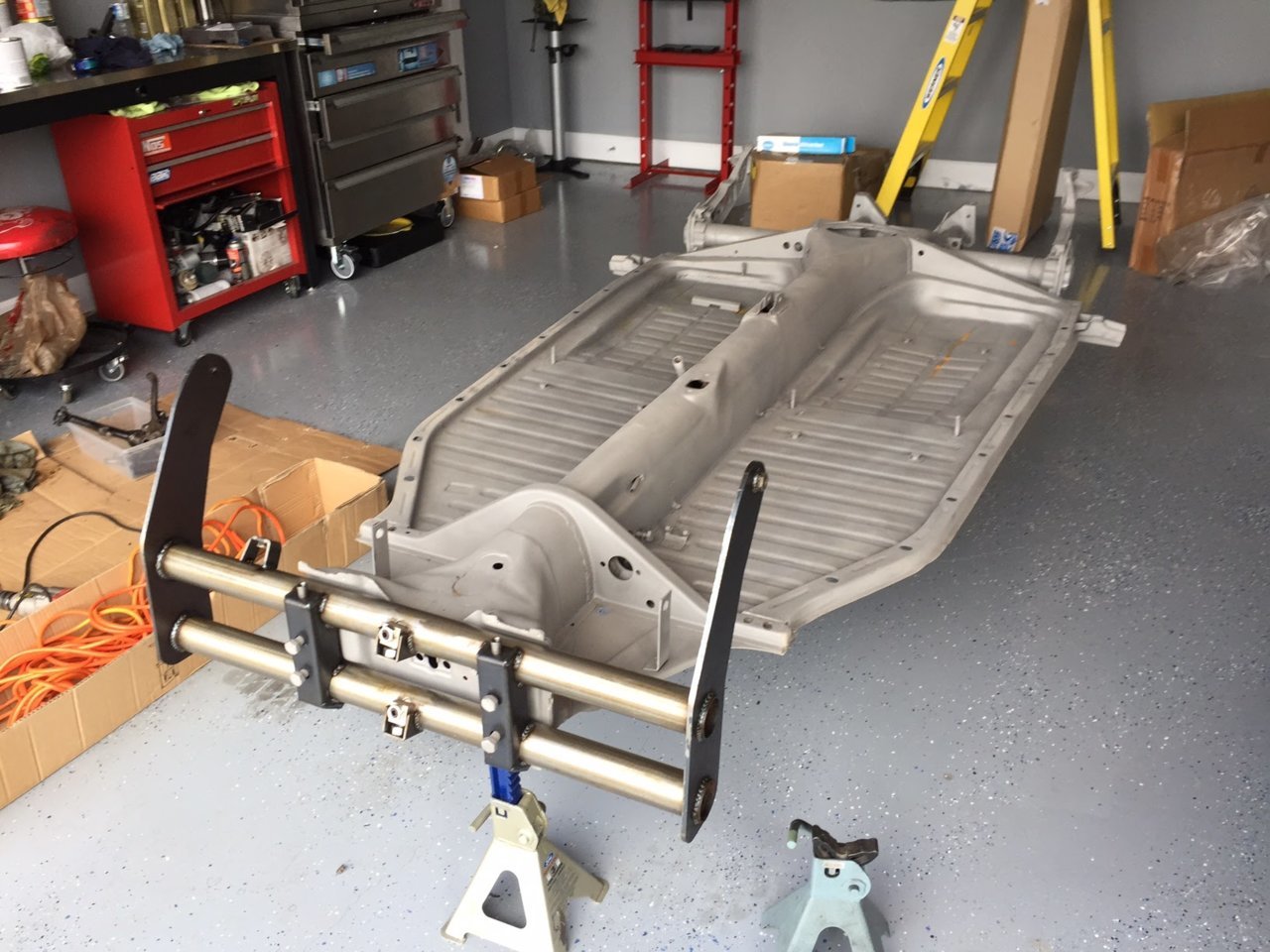

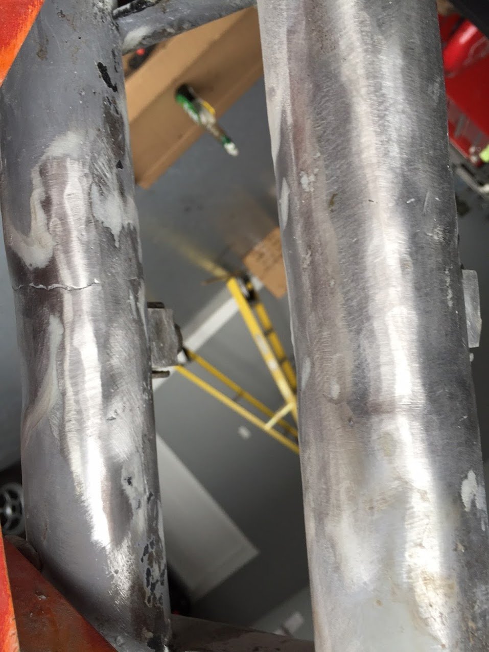

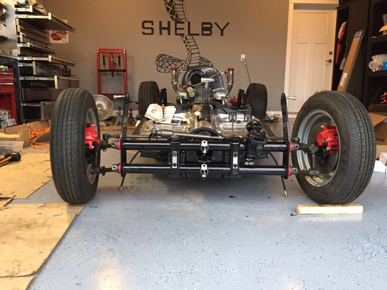

    Took out the beam to clean it up and prep for paint... and found the scariest splice that was covered in 12in of bondo
    Had the pan blasted and replaced the beam with a new 2in narrowed unit

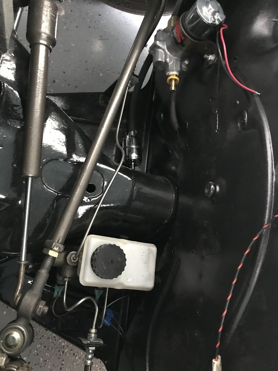

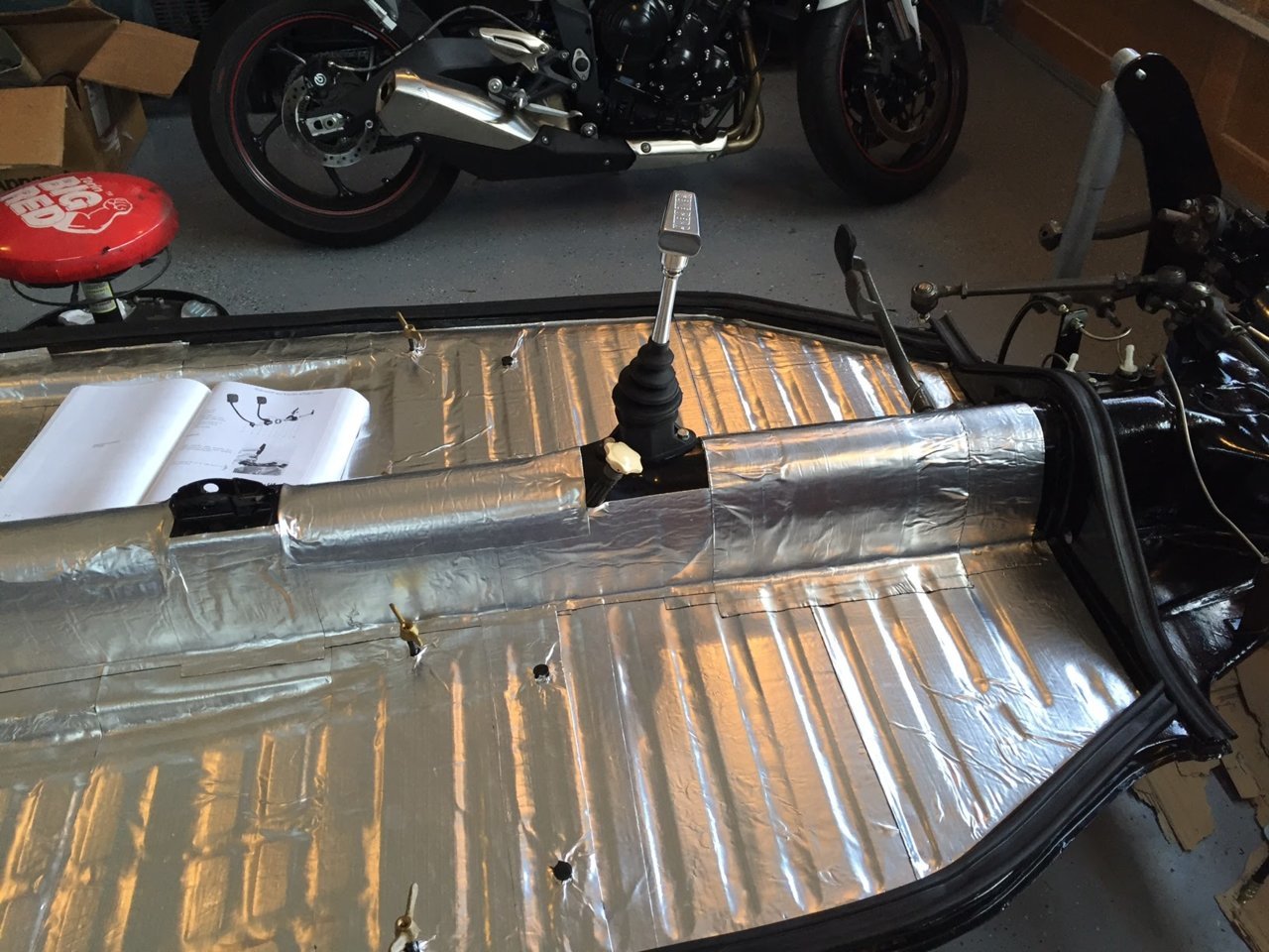

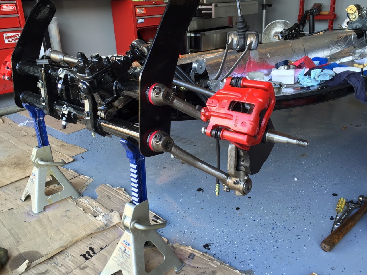

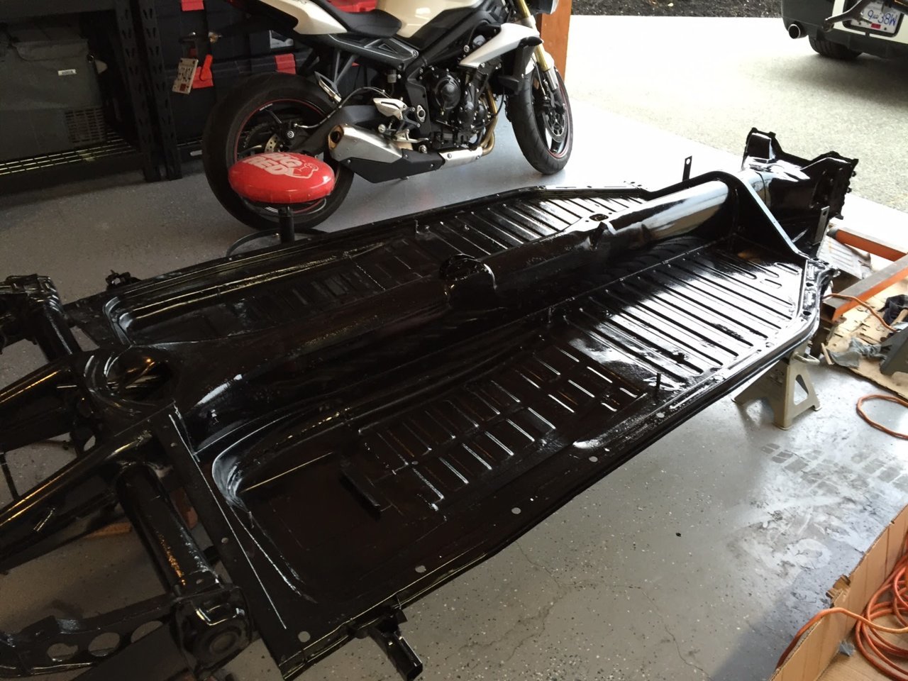

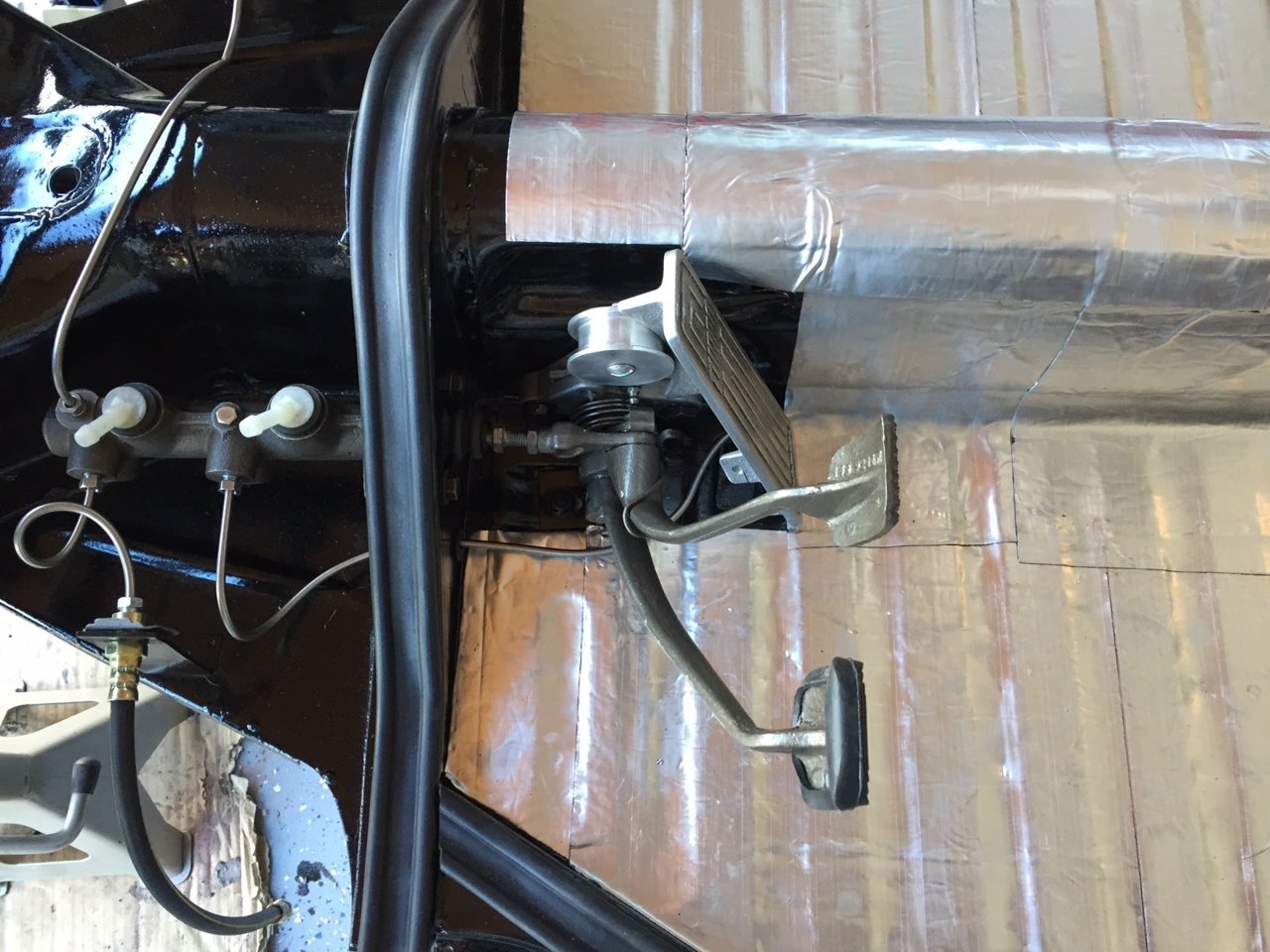

    Por 15 on the pan

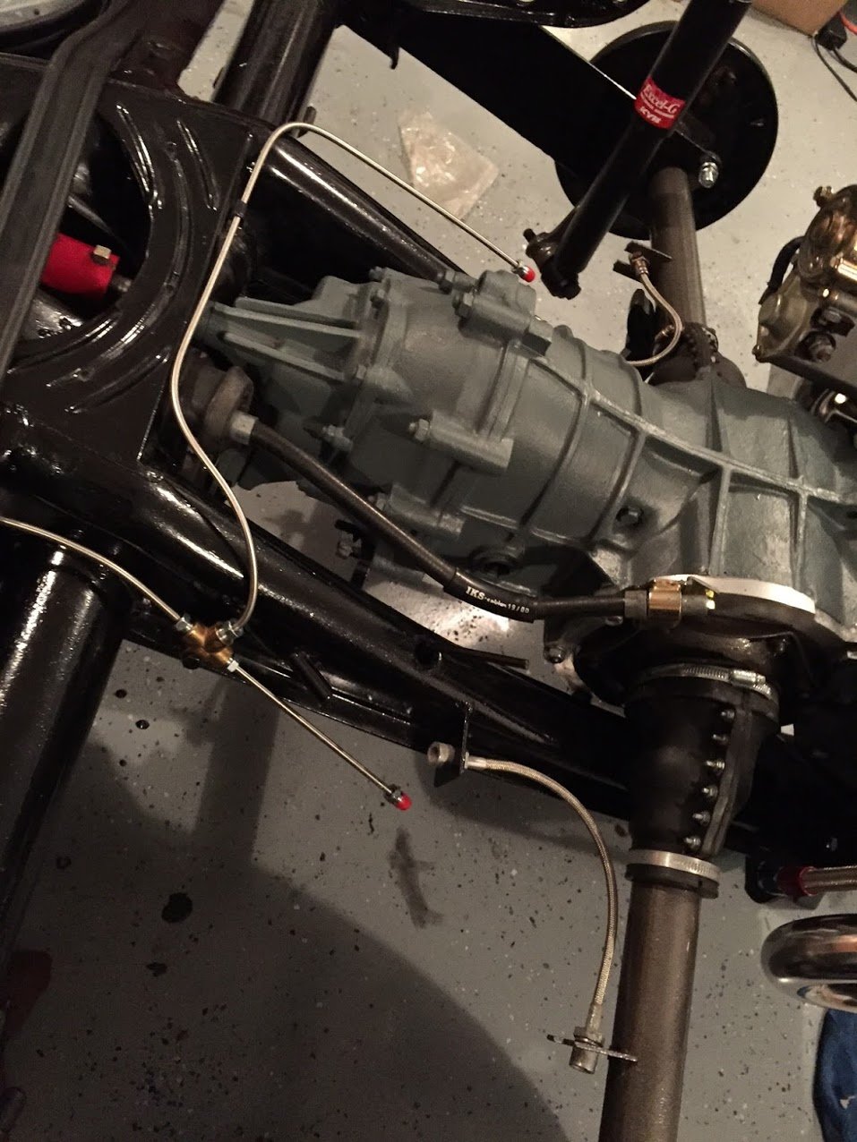

    Added disk brakes to the front and some tin foil to cut down on the road noise

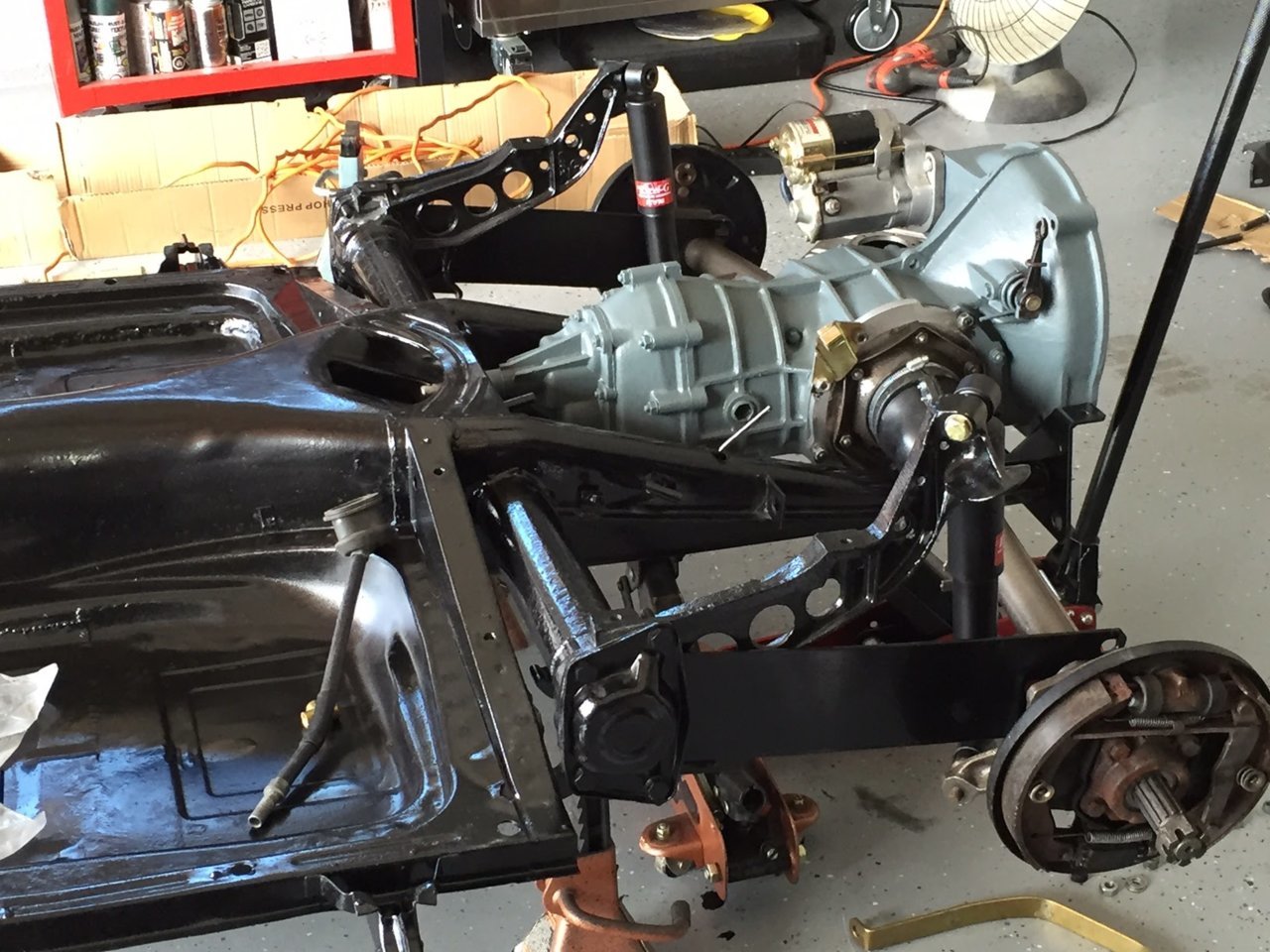

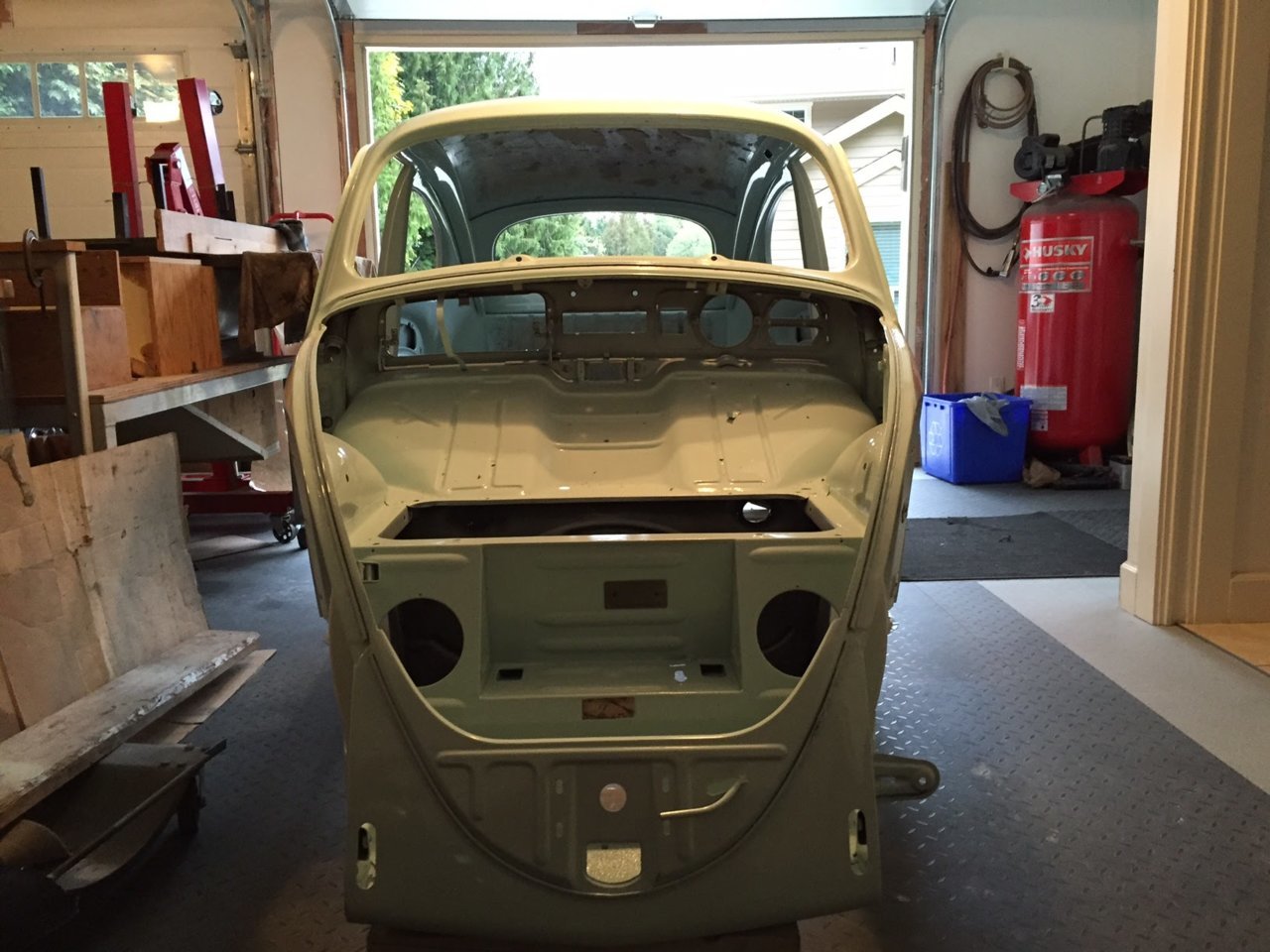

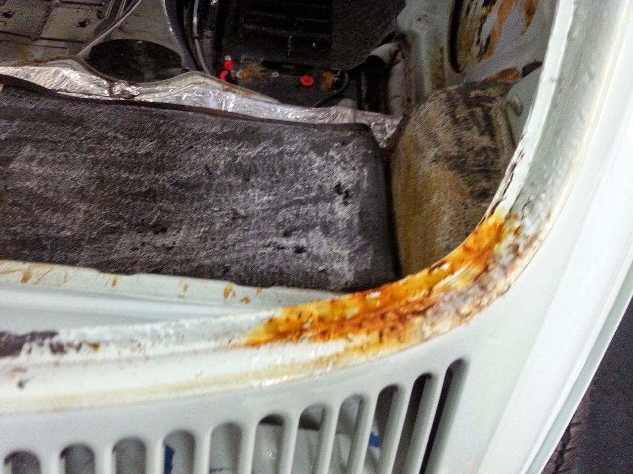

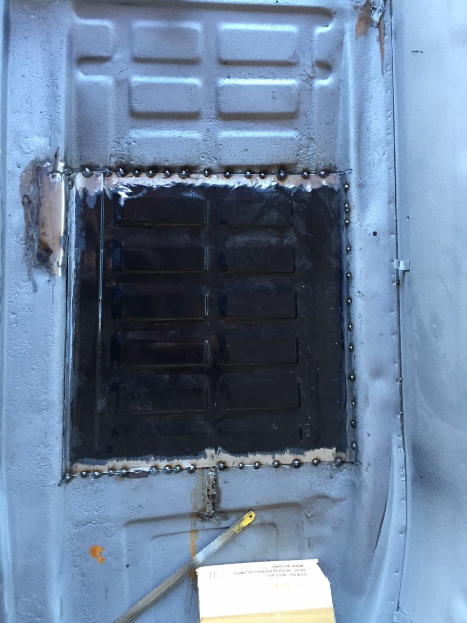

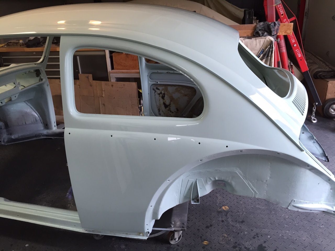

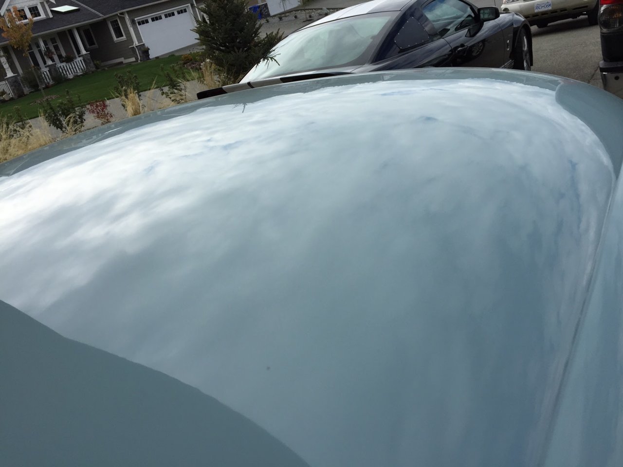

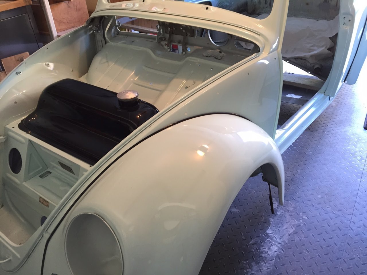

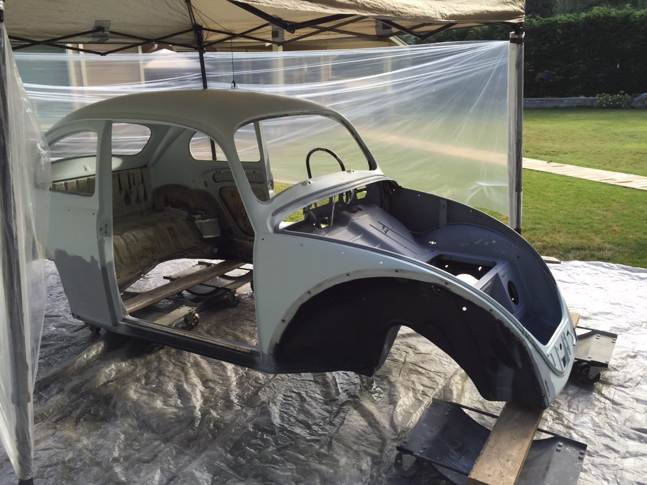

    After replacing metal and fixing way to many rusty bits.... time for paint- hillbilly style
    Cloud reflection in the roof... paint turned out ok

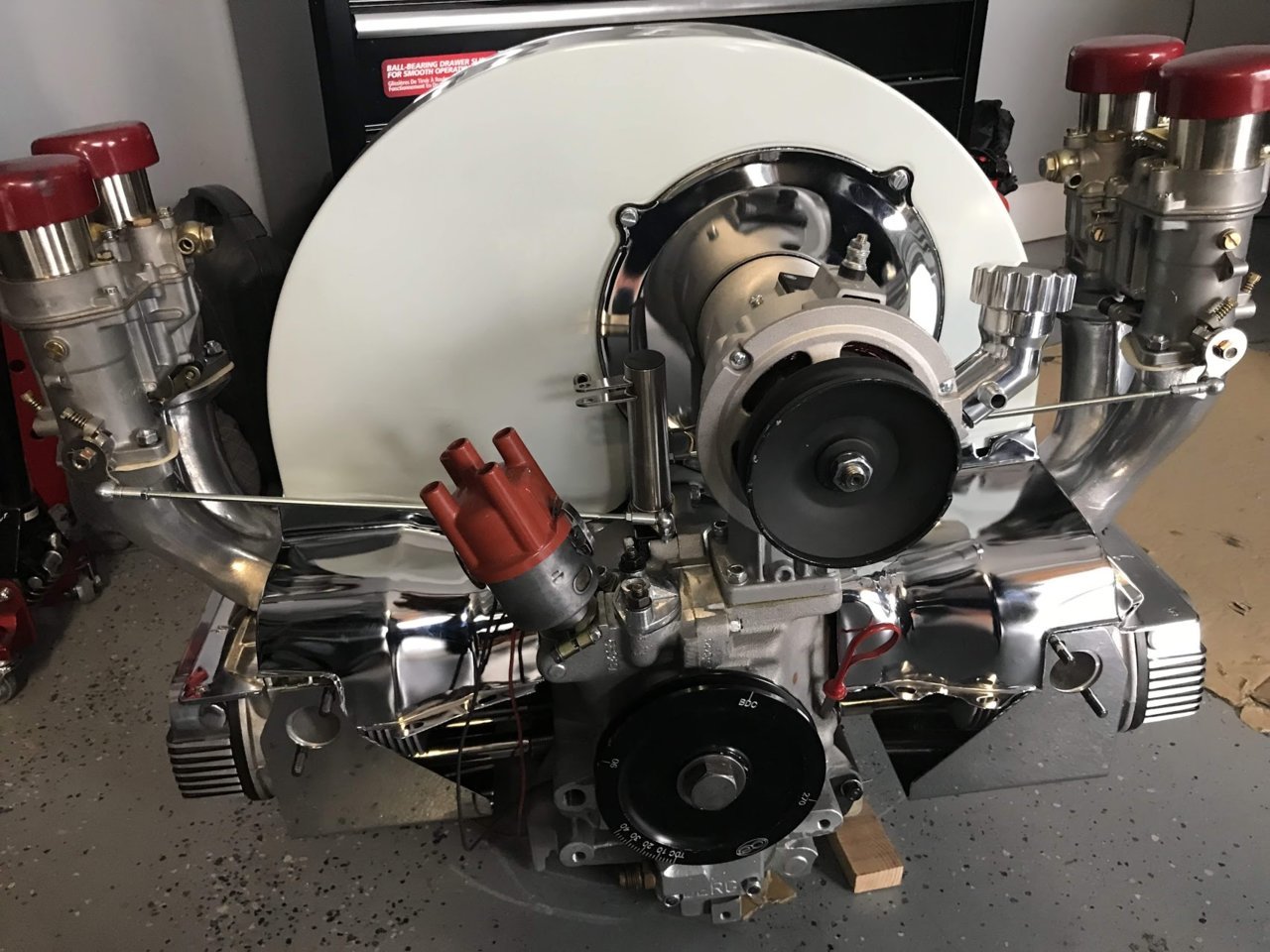

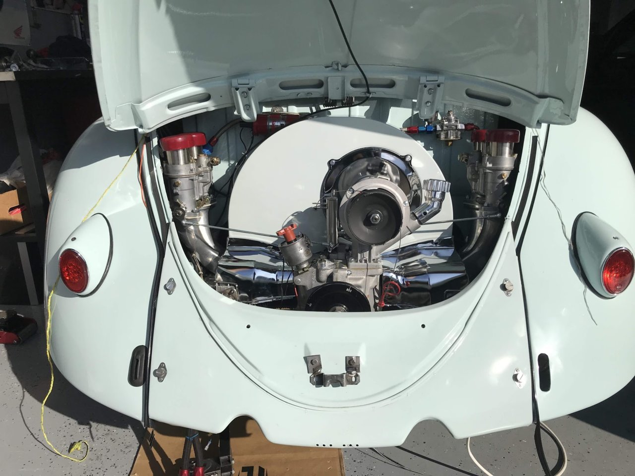

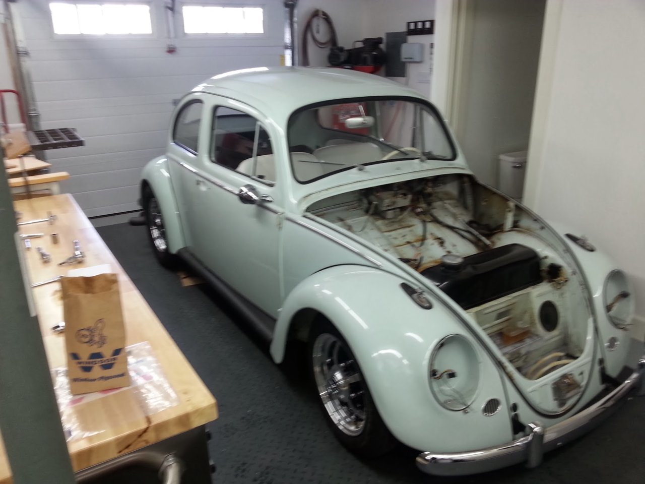

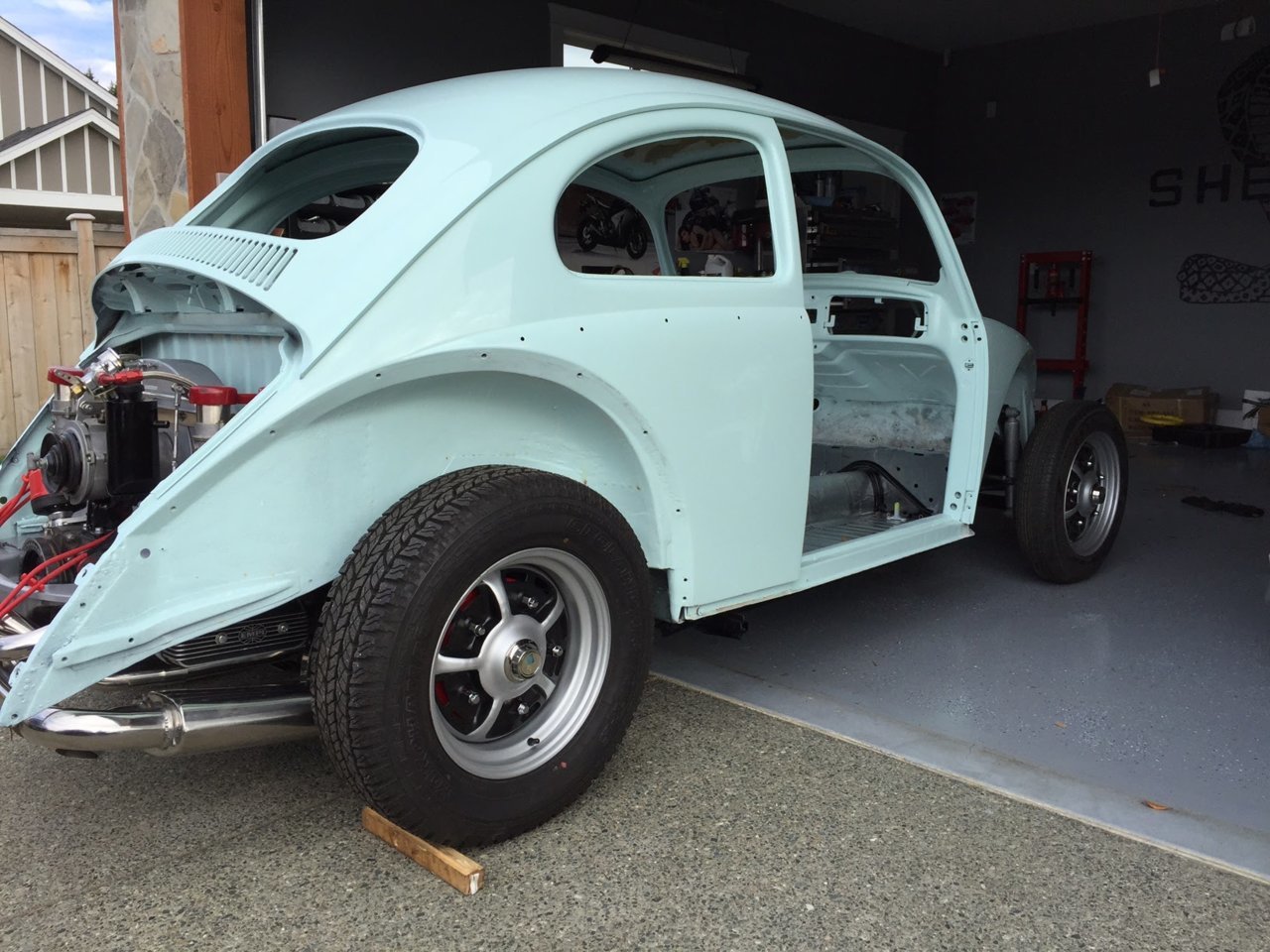

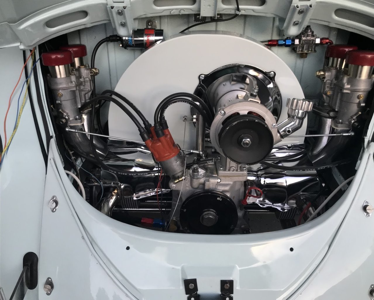

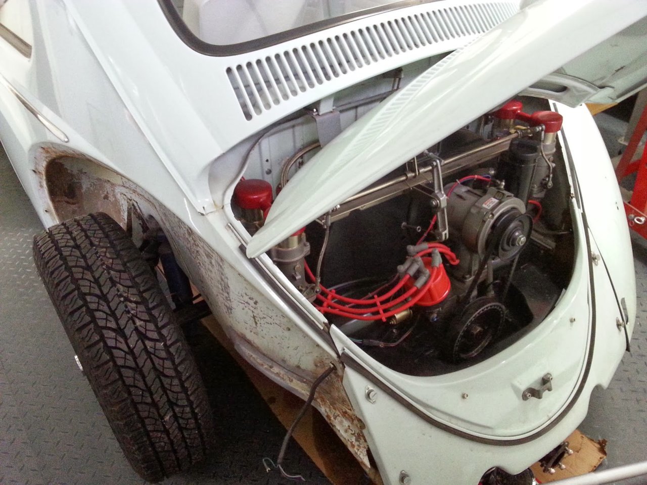

    Had a manx buggy that I was working on and decided to sell. I had a built 2275 for the buggy but the purchaser thought it was to much engine for a 1200lbs buggy... fair enough. He wanted the lesser built engine out of the 60... so this was pulled
    And replaced with this... not ideal and it set back the 60 build time
    AD67661A-23C6-4D95-A4AA-CBF267D1CCD4.jpg 58D96D2C-5D2A-4C21-B311-D3D888625622.jpg

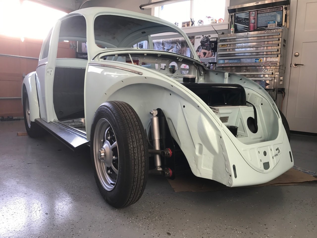

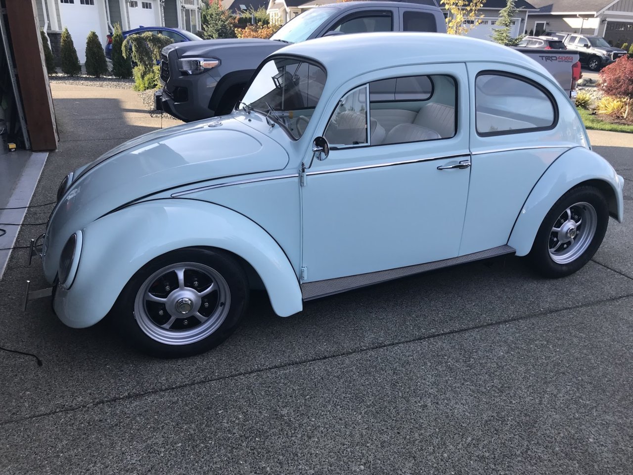

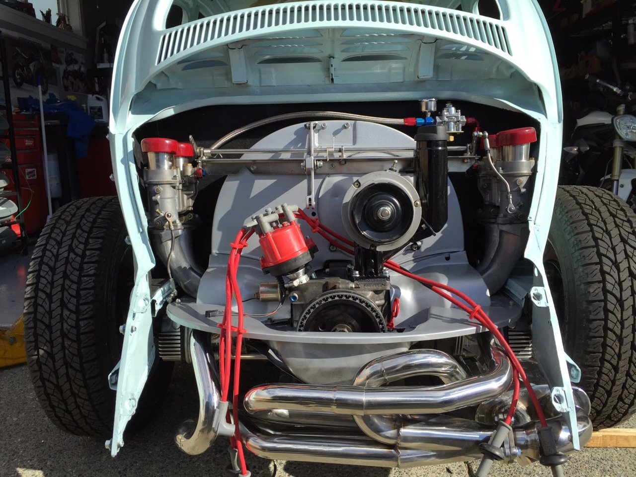

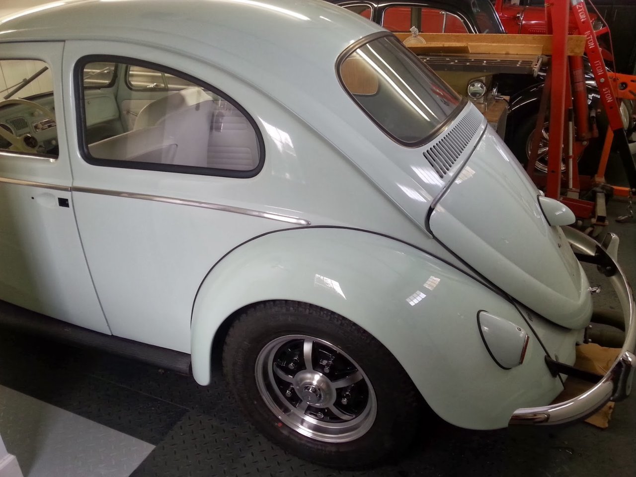

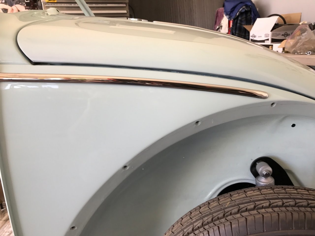

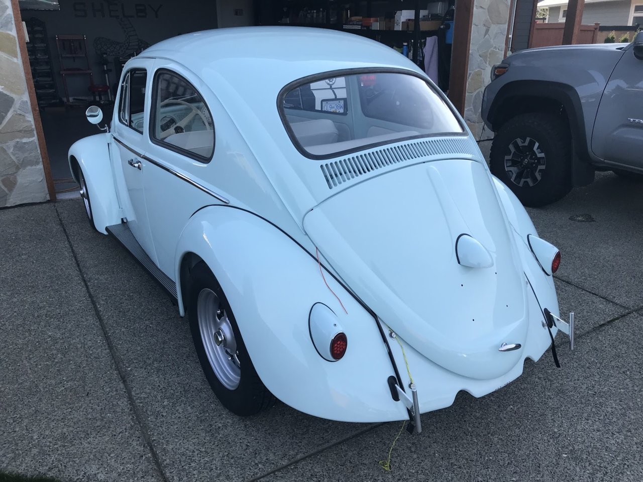

    And how it sits as of today.... close but not close enough
