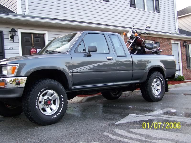

    my last 95 was 32x11.50x15 on stock later model wheels 15x7 as seen below
    the ONLY time anything was was at full lock turn and it was so slight of a rub it didn't do anything

    did it rub at all?

    BARELY, as in full lock and it wasn't even enough to show a mark on the tire
