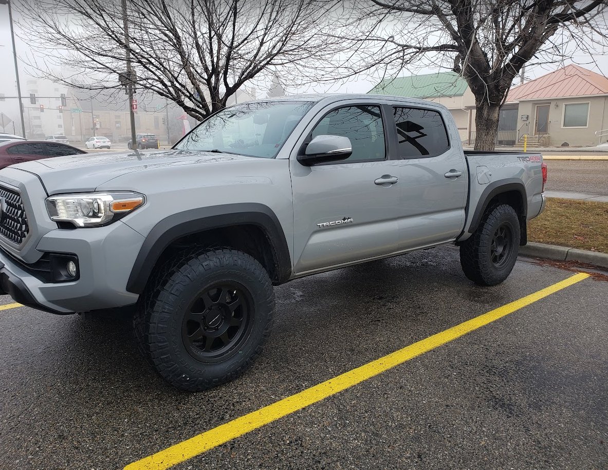

    Depends on the tire/wheel combo to be honest.
    I'm running the below without rubbing on stock suspension. LT255/80R17 (33.31" x 10.04")
    Method 17x8.5|6x5.5|0/4.75" - Link
    I never cut anything and haven't run into any issues so far.

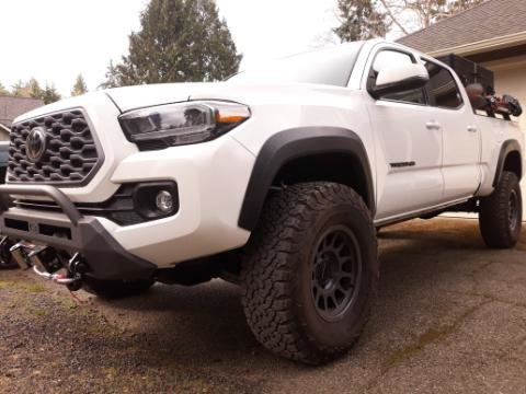

    King 2.5’s with adjusters from accutune front and rear, 88 rotors rear add a leaf, Camburg X-joint UCA’s, Factory style trd pro 16” wheels with 0 offset, 285/75/16 KO2’s, pro grille, Front bumper viper cut, trd front skid plate, full RCI under skid plates, Cali raised trail sliders, exhaust cut dump, KDMax 10.0 tune
    I’m running a 3” king 2.5 lift with 285/75/16 on a zero offset wheel. I did a cmc and viper cut just to be on the safe side. I’m not having any rubbing, but if you go stock wheels, you will definitely need spacers.
