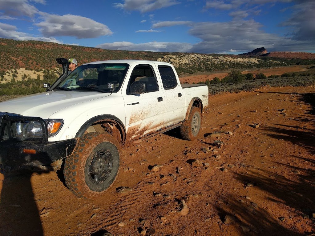

    3" OME - 33x12.5x15 Wrangler Duratracs - They should have come like this stock.

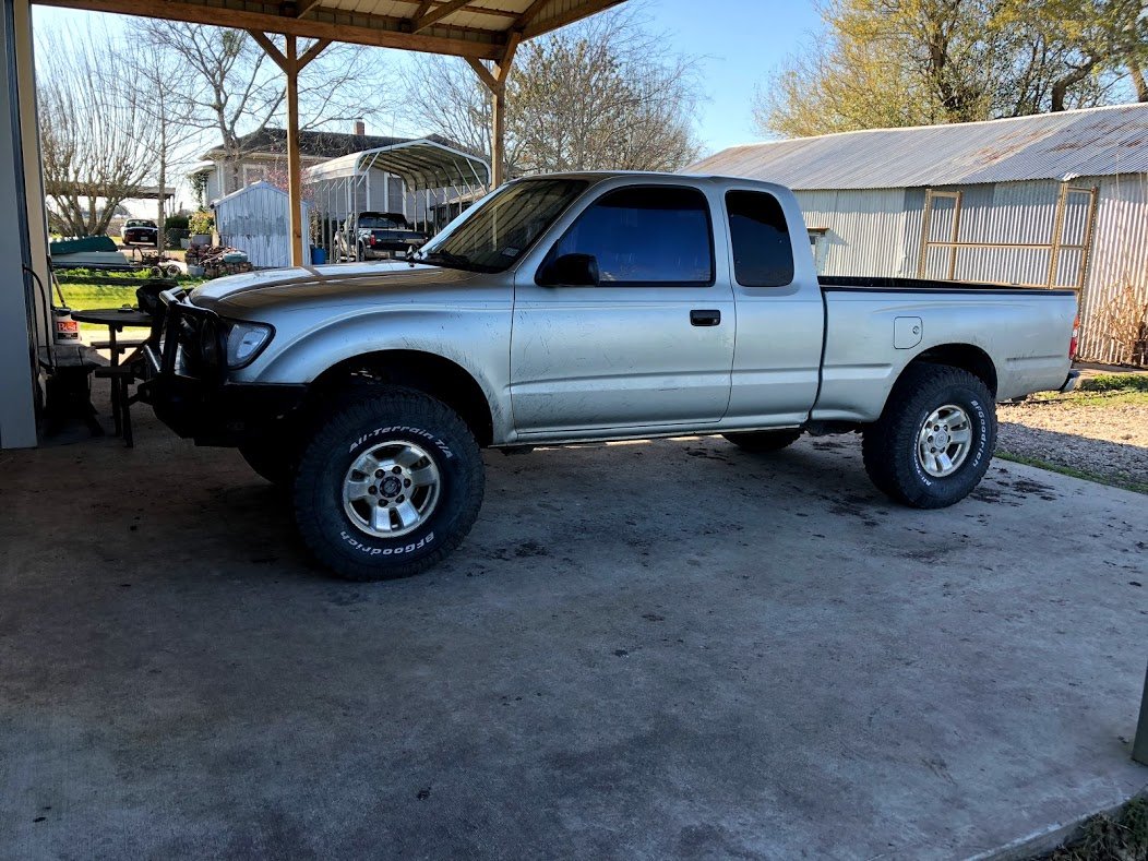

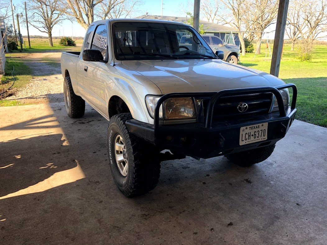

    First pic is old setup right after installing 3” supreme suspension lift, I was running 33x10.50x15s with minimal scrubbing only at full turn
    Second pic is the new setup before I added 2” more lift. But in that pic I’m running 33x12.50x15s with offset and 3” supreme suspension lift. It scrubbed so I added 2” more lift to get to 5” total.

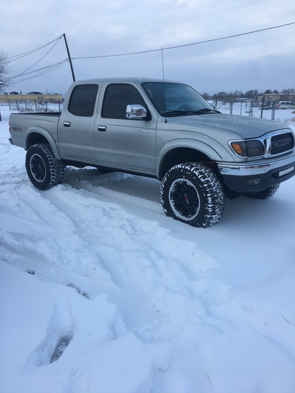

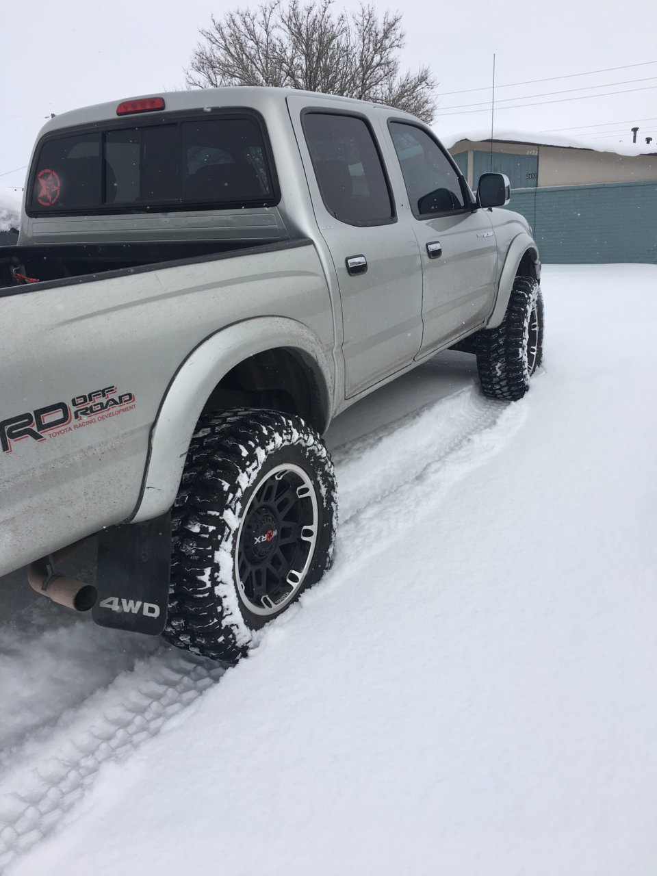

    First timer here on TW. Got a lot of ideas from all of you here for my Taco. Felt it was time to share. 33”X12.5”R18 3” toytec.

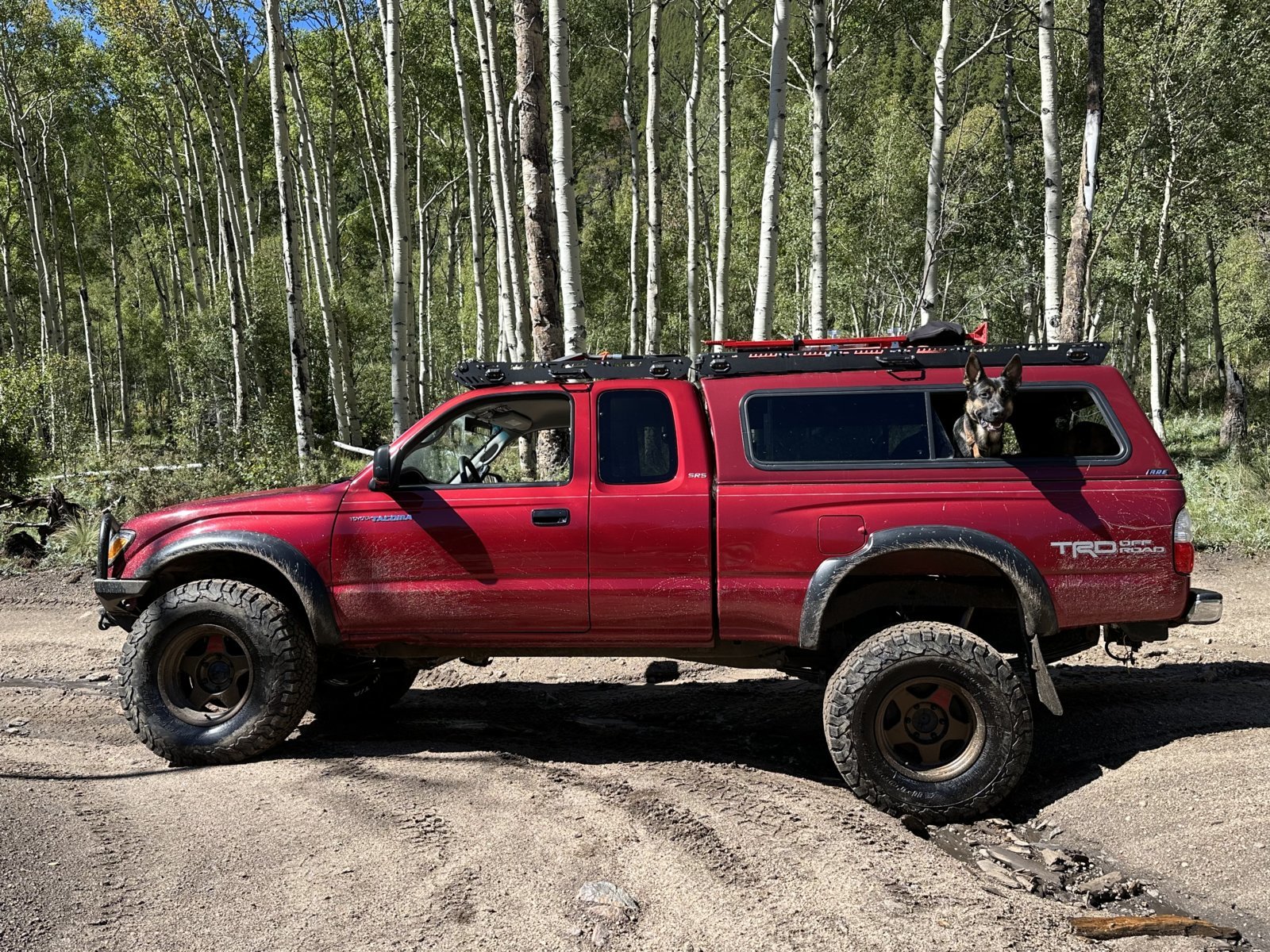

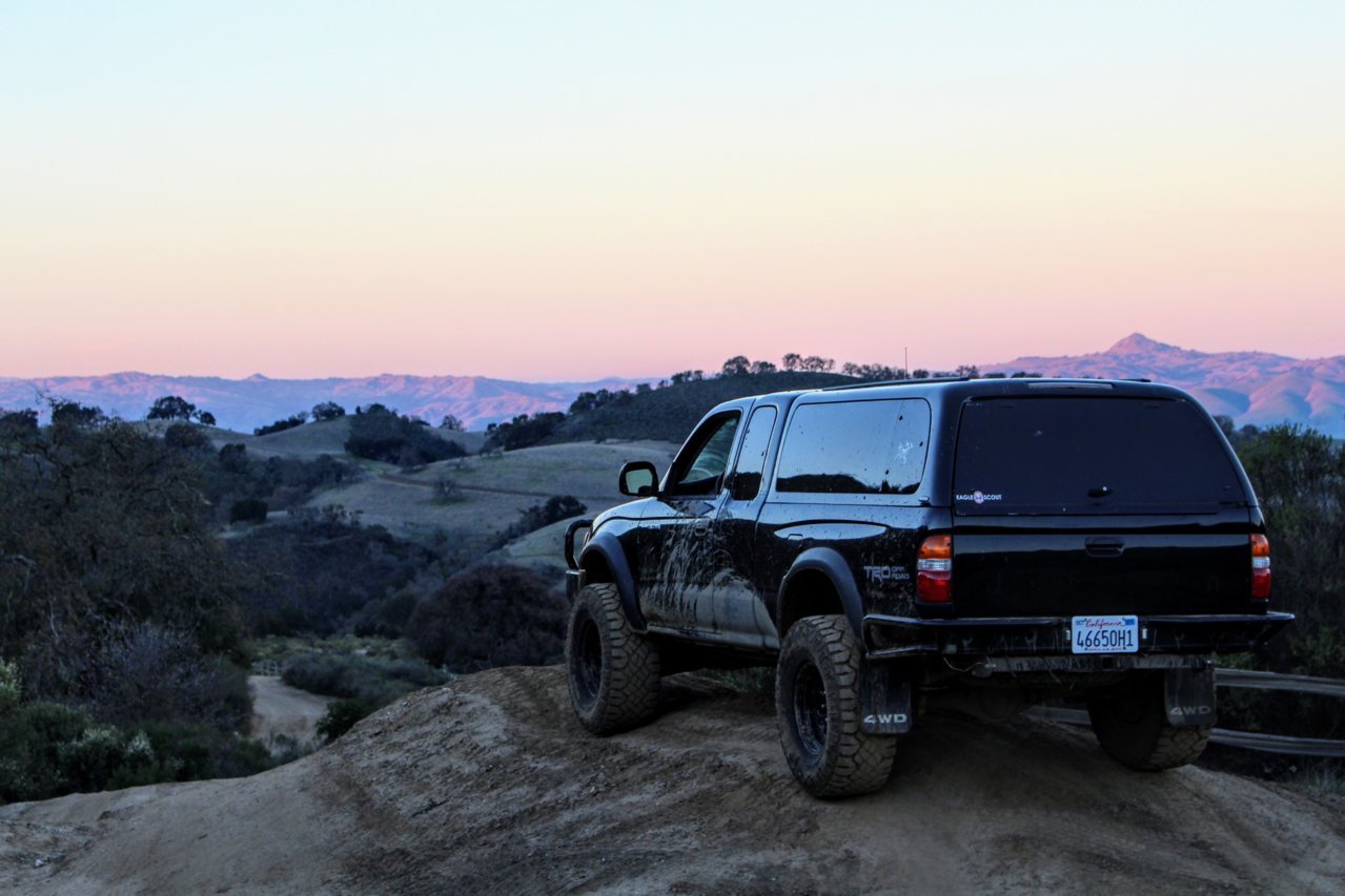

    Running 255/85R16 Dick Cepek Extreme Country with OME 2883 and Dakars.
    YJ7H6uG3XO-WQlVx8nH6Hr5aJjlKb1zSvJIYyMg9_4ab28767426e48384bdf01c6a5cb570aa5ae2650.jpg
    Got slight rubbing on the rear flares under compression, removed them but probably could have gotten away with a trim. The front has always rubbed on the frame and part of the inner fender, but a hammer mostly fixed that. Things are super sensitive to alignment, I've had some where the front rubs hard on compression (no more pinch weld hamming to be done) and some where it's fine. Looking at SPC UCAs so I can push the tire forward with the control arm and not have to worry about it anymore.

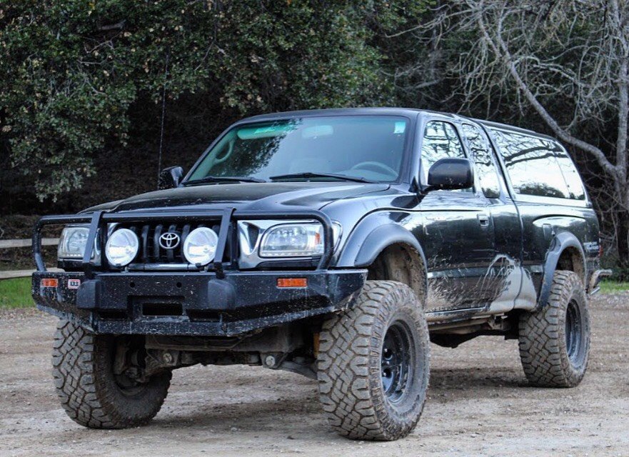

    2.5" lift and 33s
