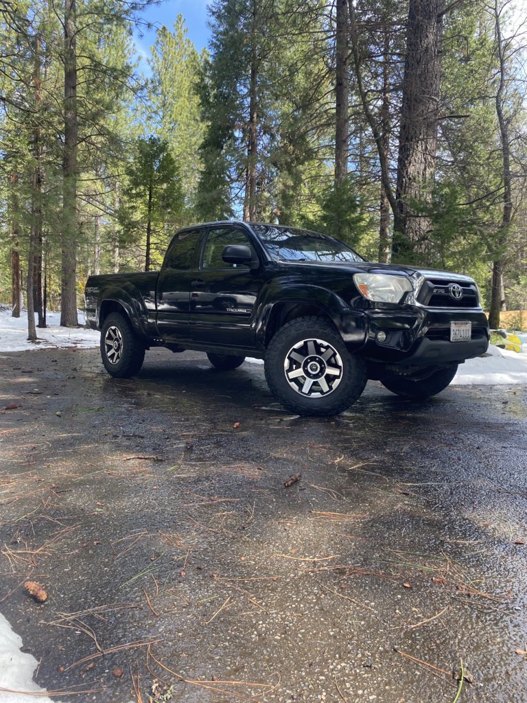

    First off let’s get this out of the way, suspension lift dose not help you clear taller tires. Up travel is determined by bump stops, lift coils have nothing to do with that and only add down travel. The key to fitting 33’s stock without cutting the crap out of fenders body mount and other things is to run a wheel very close to factory offset and don’t try and fit wider because you increase your scrub radius or will rub your uca. If you really want to do this I highly recommend watching tinkerer adventure on YouTube, you will understand how the ifs actually works. Dude shoved 37’s under stock 2nd gen tundra without a lift or bmc just had to remove the sway bar. Definitely worth a watch. I have 255/80/r17 ( true 33” tall 10” wide) with 5th gen 4Runner OR wheels on stock suspension and no rub at full stuff and wheel lock

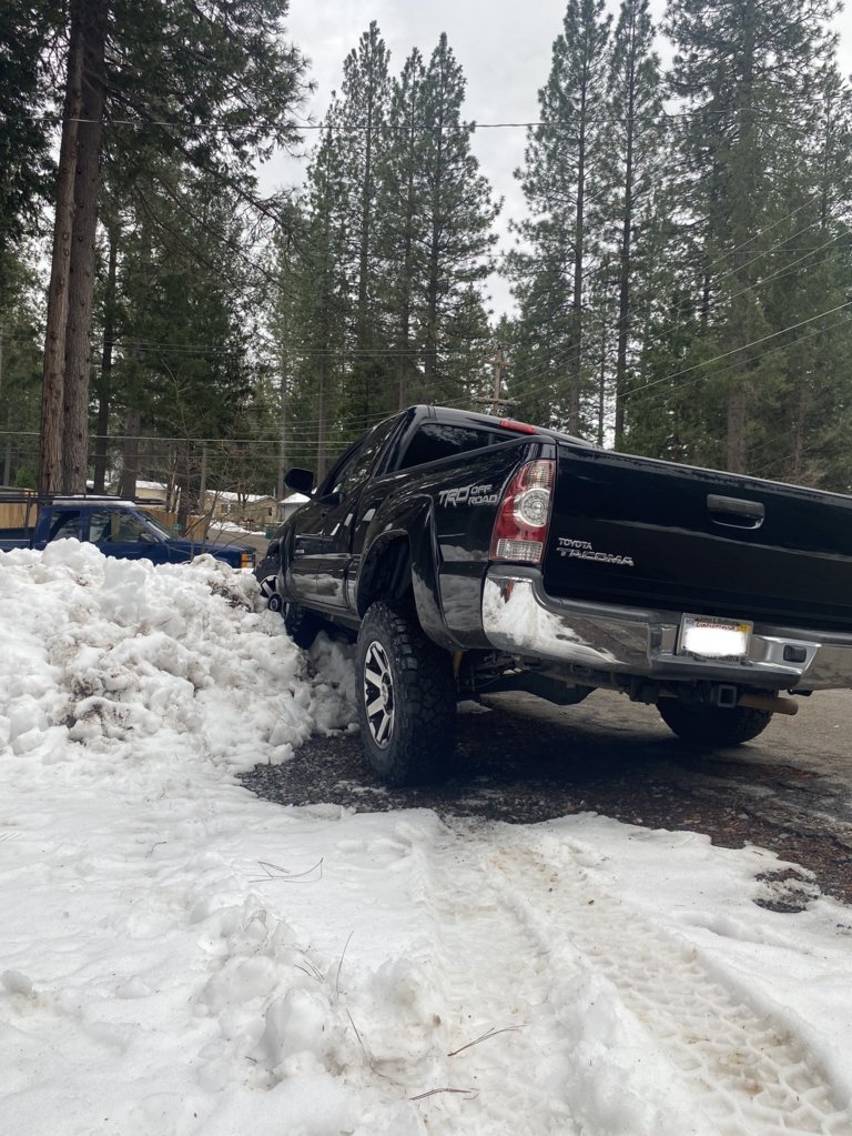

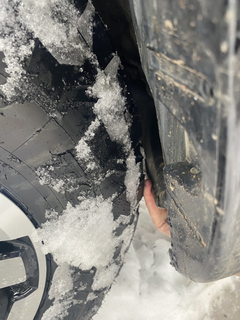

    Mounted a snow pile today to fully max suspension, soo close to rubbing front and back but completely in the clear

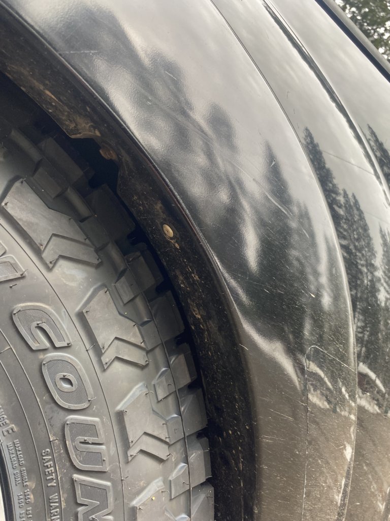

    Back fully tucked

    4h tell it slipped rear driver, could have kept going with more skinny pedal but just a simple flex for y’all

    Thanks for sharing the resource! I’ve really liked running 255/85r16s as my 33s.

    I hadn't noticed those wheels before, and they might be my new favorite. Uncomplicated but attractive.
