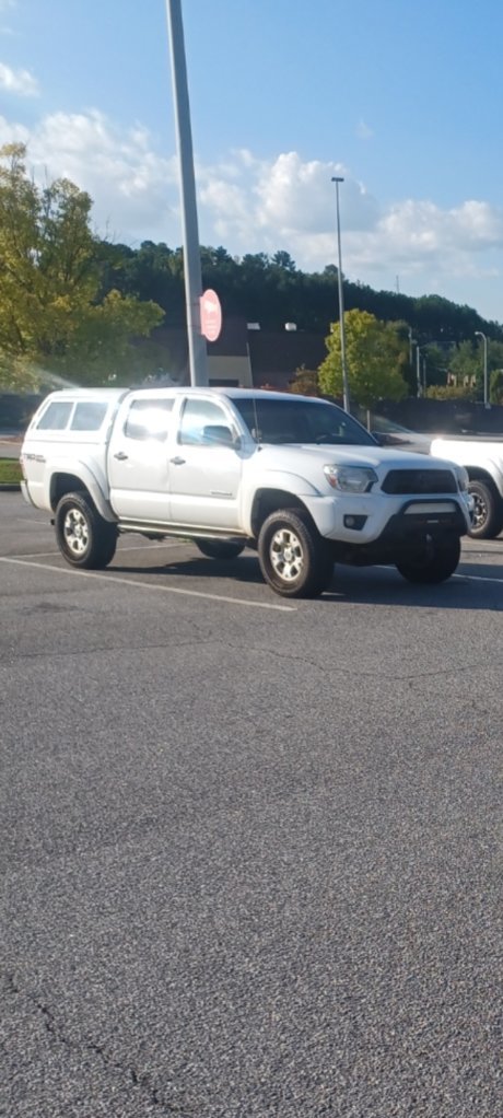

    2015 Super White DCSB Off Road
    I don't have photos at the same angle. I feel if the 285s were on machined wheels they'd look even bigger. Also wheel offset plays a role in making them look bigger I think. I didn't notice power loss and the mpg isn't a lot different either. But 265s are cheaper.

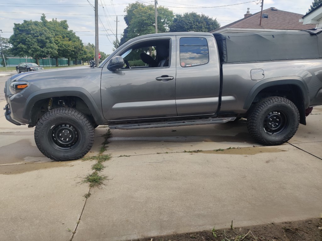

    2012 Silver Access Cab 4x4 I4 MT
    265/75r16s from a different angle. Slight lift maybe an inch? (3rd gen suspension swap)

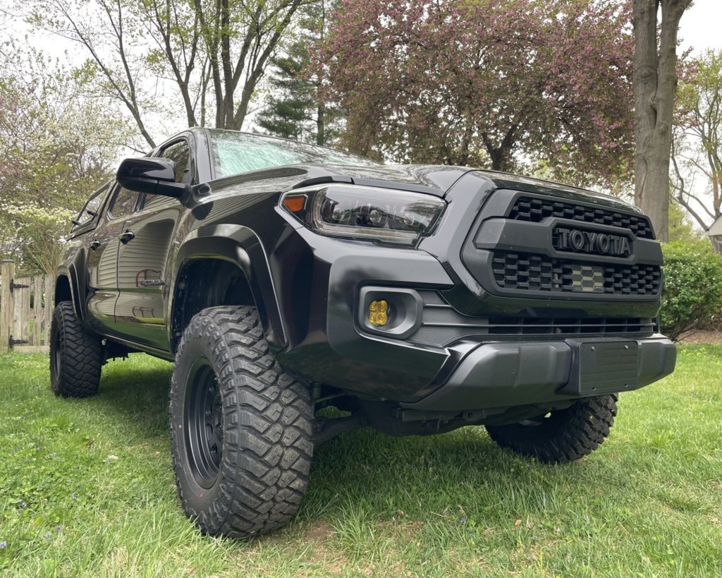

    Yep. I have done it. I run Bilstein 5100’s on all 4 corners, set to 1.55” in the front. Icon AAL in the rear to help with the added weight of the ARE cap and gear inside.
    I downgraded size to help with acceleration, braking and MPGs. I drive the truck all over the US and Canada and the 265’s do everything I need. Also, for those who care, the speedometer is dead accurate with the 265’s.
    Then — LT285/75/16 Yokohama g003’s:
    Now — LT265/75/16 Maxxis Razr MTs:
