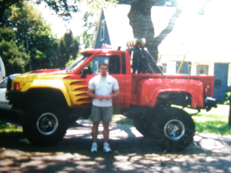

    i had 35"x12.50 on 10" rims on my 4 banger. i had 5.29 gears and a 5 speed and still was able to do over a 100mph. big or long hills killed me
    edit: i think this pic i had 36" swampers

    Is that the original Bed?
