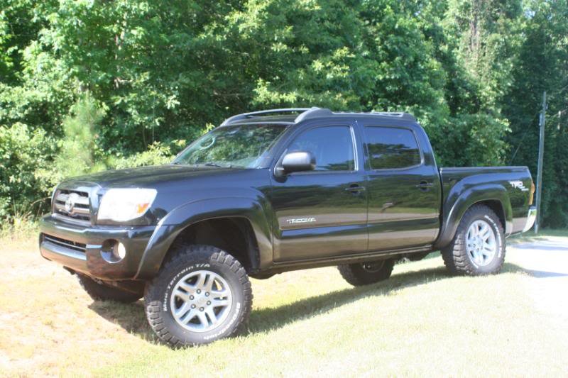

    I wanna know if you can fit a 33x12.50 on the 17 inch tundra limited wheels that are split spoke . I think they are a 17x7.5 but just curious if that size tire would be too big for that wheel , and or if anyone has pics or can find pics of that size tire on that wheel???? DOES ANYONE HAVE GOOD PICS OF THIS SETUP??? I have seen this setup in a crappy pic but cant really tell.
    I wanna do wheel spacers of course but wanna fit a 33.12.50 on my tundra wheels. This is a pic of my truck with 285.70's

    did you have to do the cab mount chop w/ those 285's? Also, can you put 285's on the stock wheels, or was that the reason you now have those tundra wheels? they look good by the way.

    no just slight cutting on the plastic flares.
    yes 285's will fit on stock wheels
