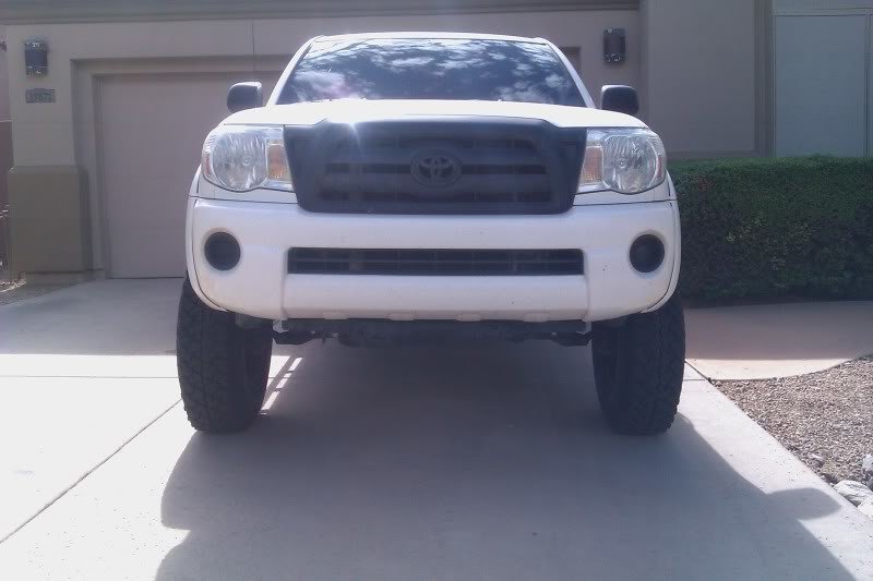

    I know this issue has been beat to death with people trying to fit 33's with their 3" block lift or 2.5" setting on their bilstein's with stock rims... but what about going with a tire that isn't so wide like a 255/80/17 or 255/85/16? This will make em not so wide but still pull off the 33" height. I know it's not a common tire size but BFG MT T/A KM2 has em and that's what Im looking to buy (actually cheaper at 255/80/17 than the 265/70/17) Does anyone know if this will work with the billy's at 2.5" + 1.5" aal without rubbing the UCA's or anything else that cannot be trimmed a bit? I'm not looking to do any other mods to my truck. Will I be better off sticking with the 265/70/17?

    08pretaco is running 255/85/16's on a 3" lift. Look him up.
