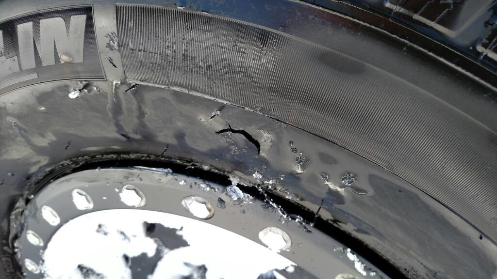

    Considering I sliced the sidewall on one of my Michelin's today that doesn't sound great. :( One video I saw claimed it was a 2ply sidewall which seems odd for an of road tire? Though folks day they flex well which makes sense if it is 2 ply.

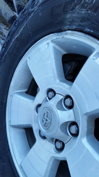

    Would that make it a 10 ply then? The tire that got sliced today was during snow wheeling and was never seen. It also gouged the rim near the tire laceration.
    So a tougher side wall is important to me.
    The snow was deep enough I didn't notice the flat tire until we stopped for someone with a broken axle (old vehicle). I saw the flat tire and at first thought I lost a bead. Was wrong.
