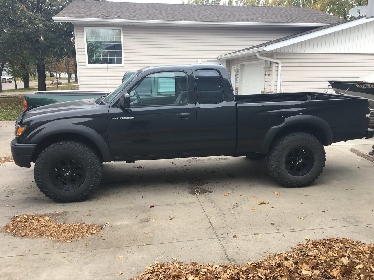

    I just put 285/75/16s on and I have no frame rubbing just had to cut off my flare a bit as you showed in your video btw great job on the vid showing guys what to do if wanting to put some bigger tires on there first gens.

    My truck is completely stock with no lift on it and I have a bout an inch of space with no spacers or nothing on the truck. @Styx586

    I think I want to get 1.5” spacers and a 2” lift. What are your thoughts on that?

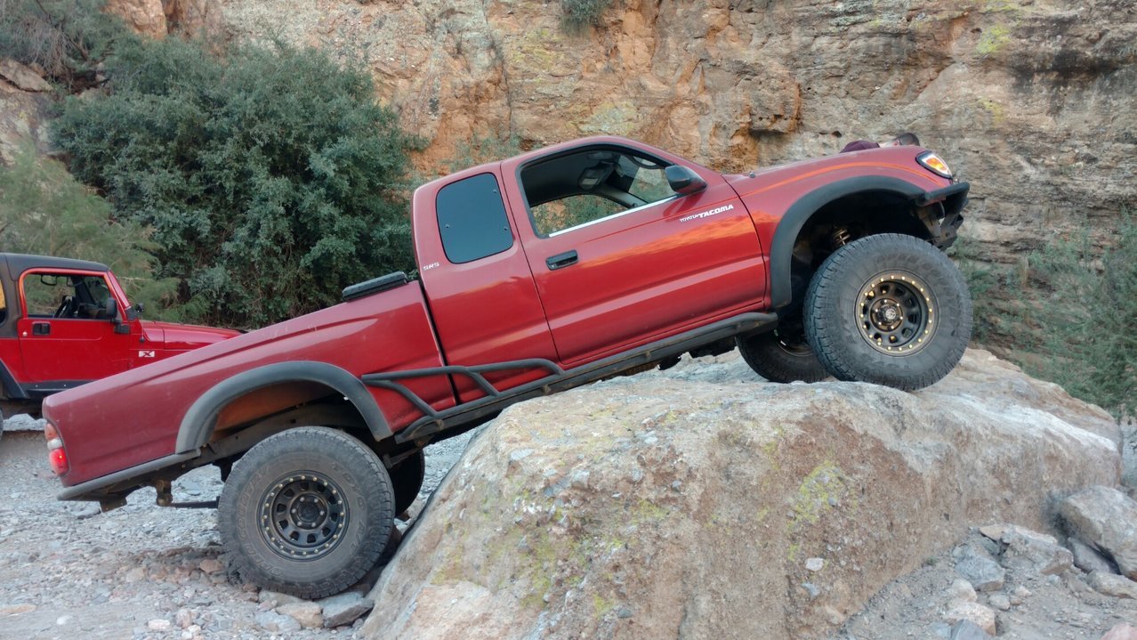

    I call bullshit on this photo having no rub issues.
