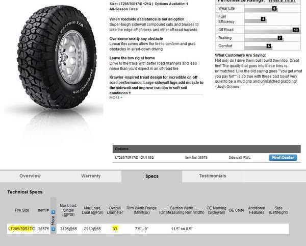

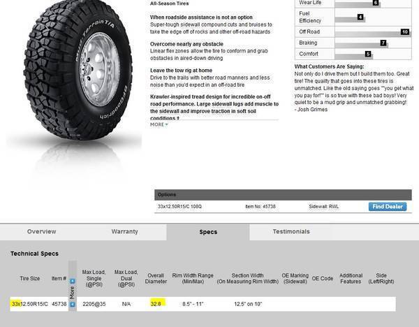

    Actually, true 33's are not necessarily wider nor larger than a 285. There are WAY too many variations of "33" to make this statement. 33x9.50=narrower than 285. 33x10.50=narrower than 285. 285x16? 285x17? 285x18? 3 different sizes.
    Your tires for example: 285/70/17 KM2=33", not 32.7"
    33x12.50x15 KM2=32.8" (so-called "true" 33)

    pure math is NOT what it is...and a miata forum as your tool of choice over the manufacturer itself? click these if you want bigger versions; snapshots taken straight from bfg:

    you can find this with almost any tire manufacturer. another example straight from the manufacturer: goodyear: 285/70/17 duratrac=32.8", mt/r kevlar=33"
