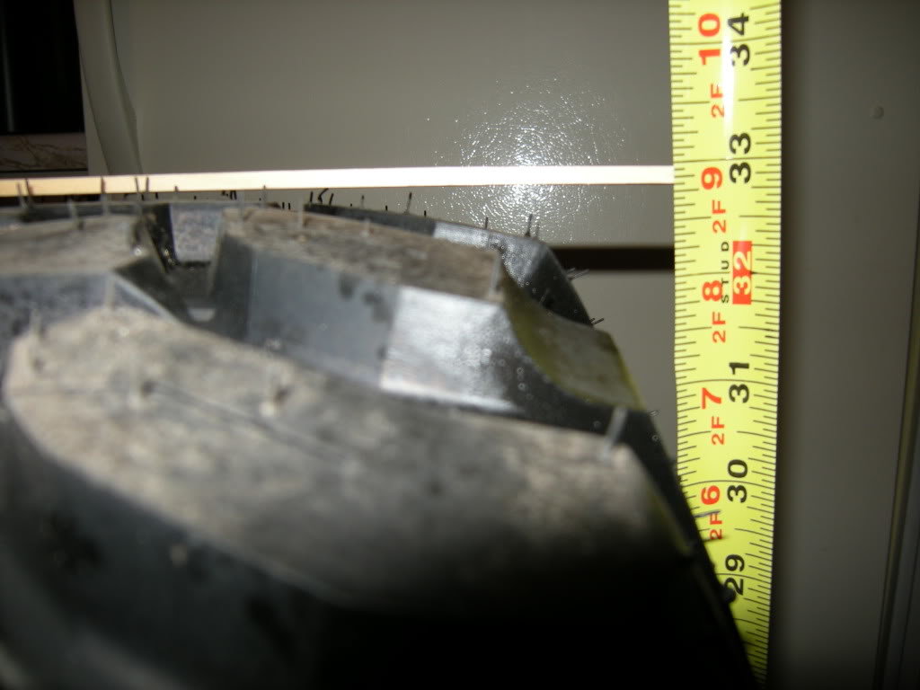

    I'm sitting here with a brand new 285 MTZ with 40lbs of pressure in it and its measuring out as 32.75 ish and Mickey thompson claims its 33.1 overall high..
    So a little bit of false advertising going on there me thinking

    Completely agreed:D.... the size difference is neglilible..was just showing that the websites arent always accurate in there measurements.
    However this tire is sitting in my kitchen right now unloaded:p.. the ones on my truck are measuring 32ish i believe..

    I thought you said it had 40lbs of pressure in it?

    It does, I just had it mounted onto a new rim for a spare a few hours ago while i was picking up my winter tires, and they filled it to 40 lbs.. Sorry when I said "unloaded" I ment not on the truck, I wasnt refering to the pressure .. was that the confusion??
