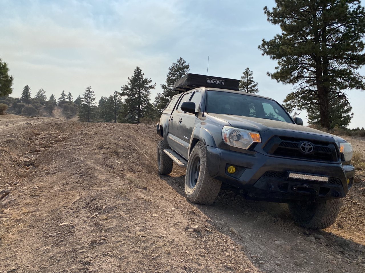

    I recently went from a 265/75/16 to 285/75/16. The truck is noticeably slower from a stop now and hunts gears a bit on the highway. Also, be prepared to do some cutting...fender flares, and wheel well liners were quick and easy but the cab mount chop might be something you have to pay a shop to do (I cut the frame myself and had a shop weld in the fill plates).
    In terms of looks, the difference is minimal. The only reason I went up a size is because I wanted to match tire sizes between my truck and trailer and cut the sidewall on one of my tires and they are 4 years old so I went ahead and replaced them instead of the new trailer tires.
    265/75/16
    285/75/16

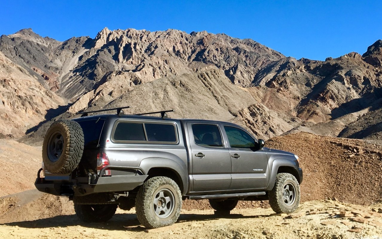

    I went from 275/65/18 (32 inch) to 255/80/17 (33) and like it so far
    Agreed with above, the contact patch is waaay better when aired down. Night and day difference in snow
    Now I want a locker and some on-board air

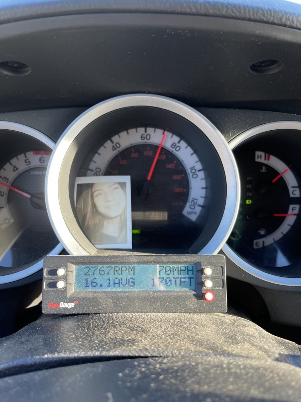

    I’m in the skinnies camp. 255/80/17 cooper st max. I love how little they stick out, and they do wonderful in the sand. Ran them on stock gears, but I have tons more weight and just recently re geared to 4.88. I do plan on jumping up to a skinny 35 eventually.
    Scan guage reading on my way home after regear.

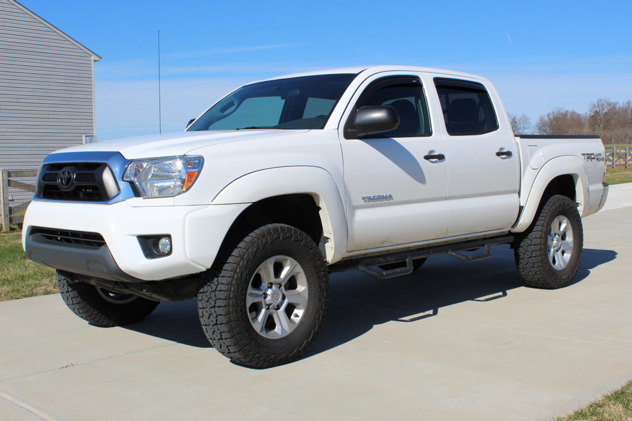

    I have 275/70r17 falkens load c and no reheat needed. I noticed more change in braking than I did power. Did slightly hurt my mpg around town but I get the same or better mpg cruising on the interstate. And these run pretty large compared to the same size ko2’s on my friends truck07AFD59A-C9BA-49F6-86A5-A257B7F4C8D2.jpg
