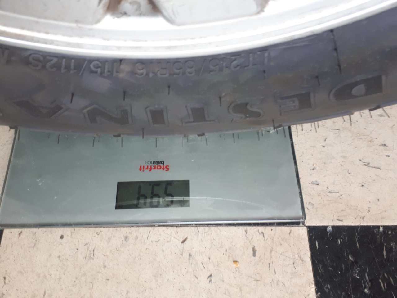

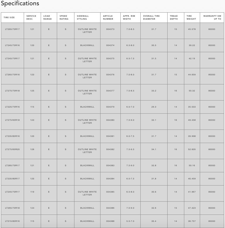

    Light, tall skinnies do exist, but I think/know that the sidewalls are less durable than say, ko's. Might not be a deal breaker if OP is not airing down to go through rock gardens.
    I know OP is looking for a 32 or 33" did, so obviously 215's are out of the question, but the Destinations are offered in a number of sizes. I've been happy so far, just waiting for some big snow. They are quiet and grip well in the rain. They are also under 60lbs when mounted on Toyota alloy rims.
    https://www.firestonetire.ca/tire/destination-xt

    I ran destinations for a few years. Very under rated tire as far as highway and snow driving. Quiet and great on corners. I would not trust them aired down though. They just are not made for it. At least in my opinion.

    My thoughts exactly. They have 3 ply treads and 2 ply sidewalls vs 5 and 3 for BFG KO's. They are excellent for "softroading" and fire roads, but give up little in regards to mileage or handling. Good jack of all tire.

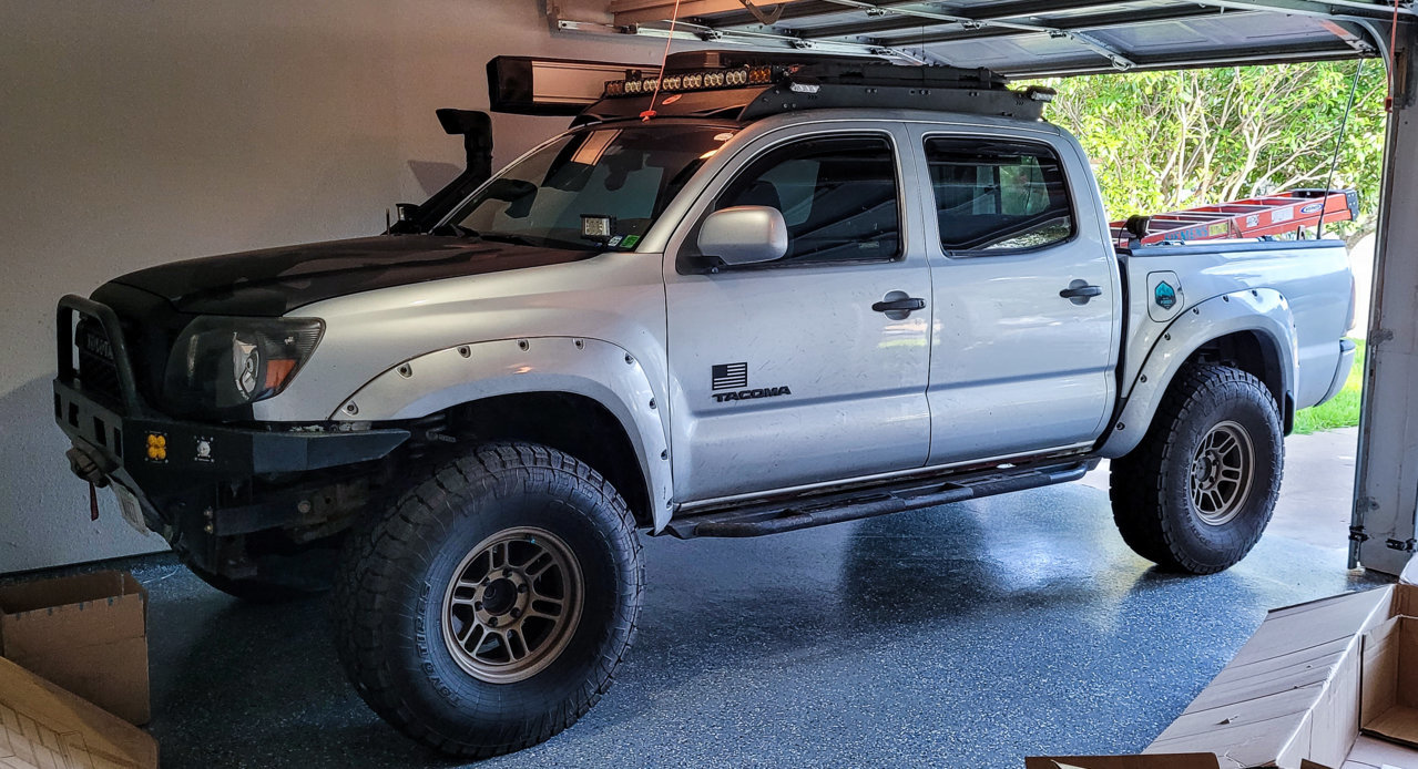

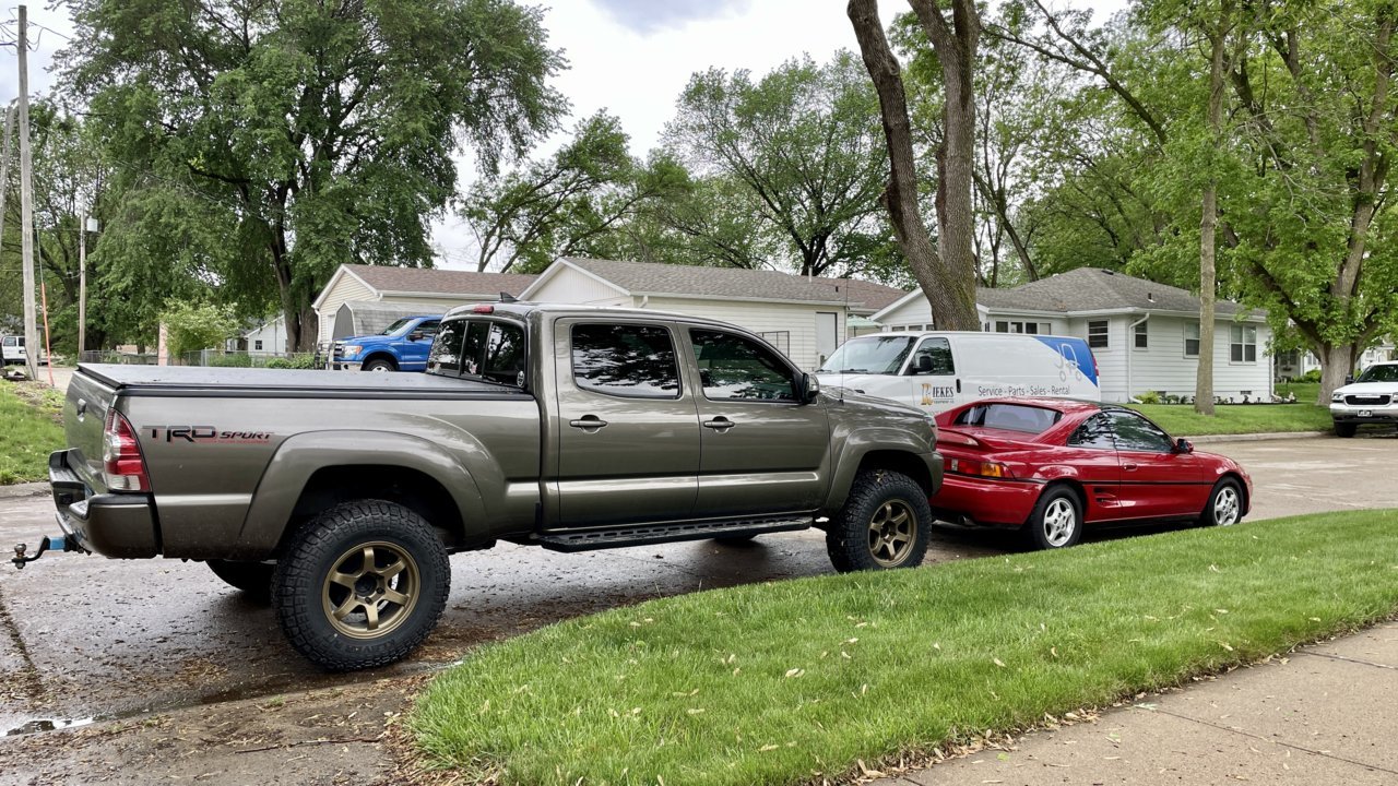

    I just put on Kenda Klever RT 33x10.50r17 a couple months ago. I had 265/70r17 Duratracs before that, which were great also. There is a noticeable change in acceleration and I'm about 2mph off on the speedo. But it isn't horrible. In my experience these trucks don't like cruising at 80mph no matter what size tire I have had on it. I usually stick to 70mph or 75 at most. I have HPTuners which helped a lot and I recommend it for anyone thats annoyed with throttle response or the factory trans tune.
    I have zero rubbing, though I am lifted (without UCAs at the moment). But since up travel is still the same and fully stuffed stock vs lifted I don't have any rubbing I would say most people would be fine. I have seen some people say these fit on a stock truck with no lift and no rub since they are more narrow than a 285. 10.50's are essentially a 265 width BTW. They make these in a 35x10.50 too which some people have ran with no rubbing on a 2" lift!
    This is the best picture I have with these tires. I'll get more eventually.

    Nice Mr2. Brought me back to the day.
    TacoFergie likes this.

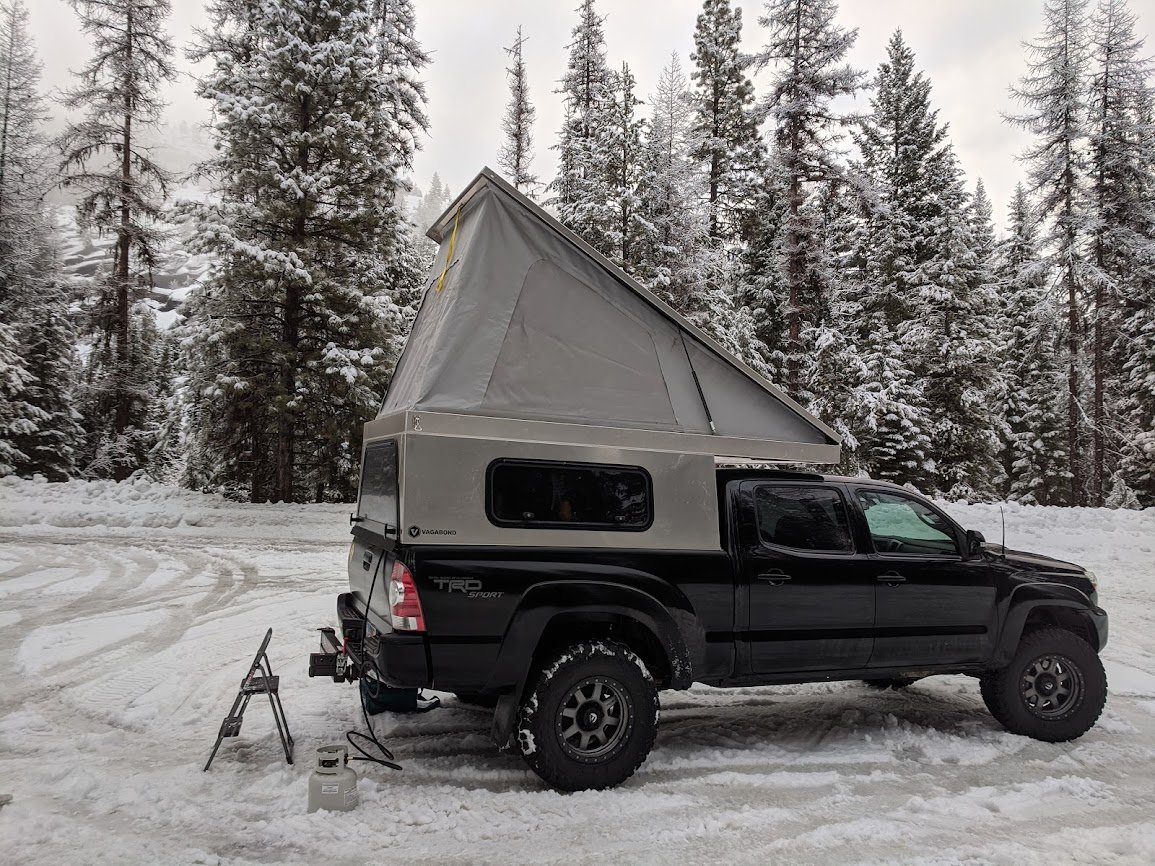

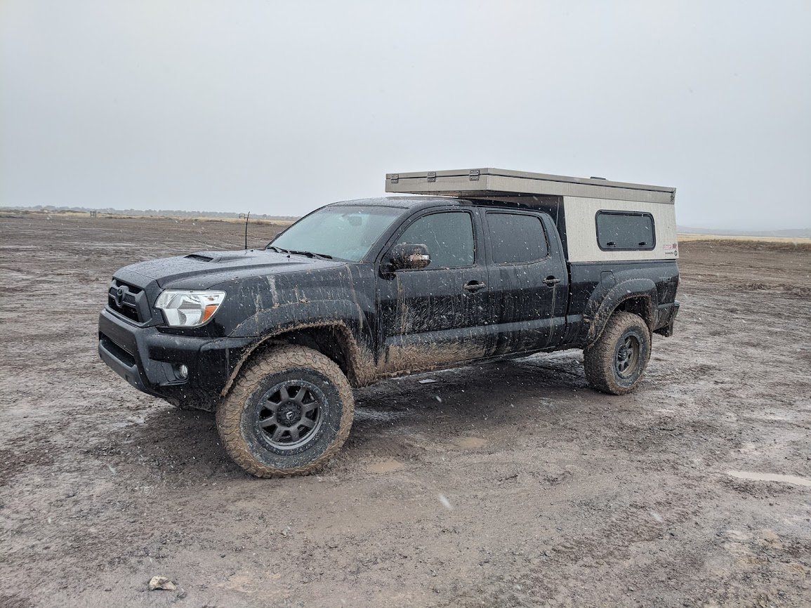

    Just to give you one more opinion...
    I'm running 285/70r17s (KO2s) on Fuel wheels with a 2" lift but no bumpers or anything else. I've got a wedge camper and full camping build in the back, so it's probably got 700lbs on the rear axle on a regular basis. I ran stock gears for two years with no complaints. It revs high going up hills or in to the wind on the highway and it's not fast off the line, but it's a lifted truck! Just got it tuned and that fixed the high revving and acceleration issues.
    I do plan to switch to a tall skinny when these tires are done, but that's just because of the MPG and traction benefits. I also personally prefer the look of tall skinnies.
