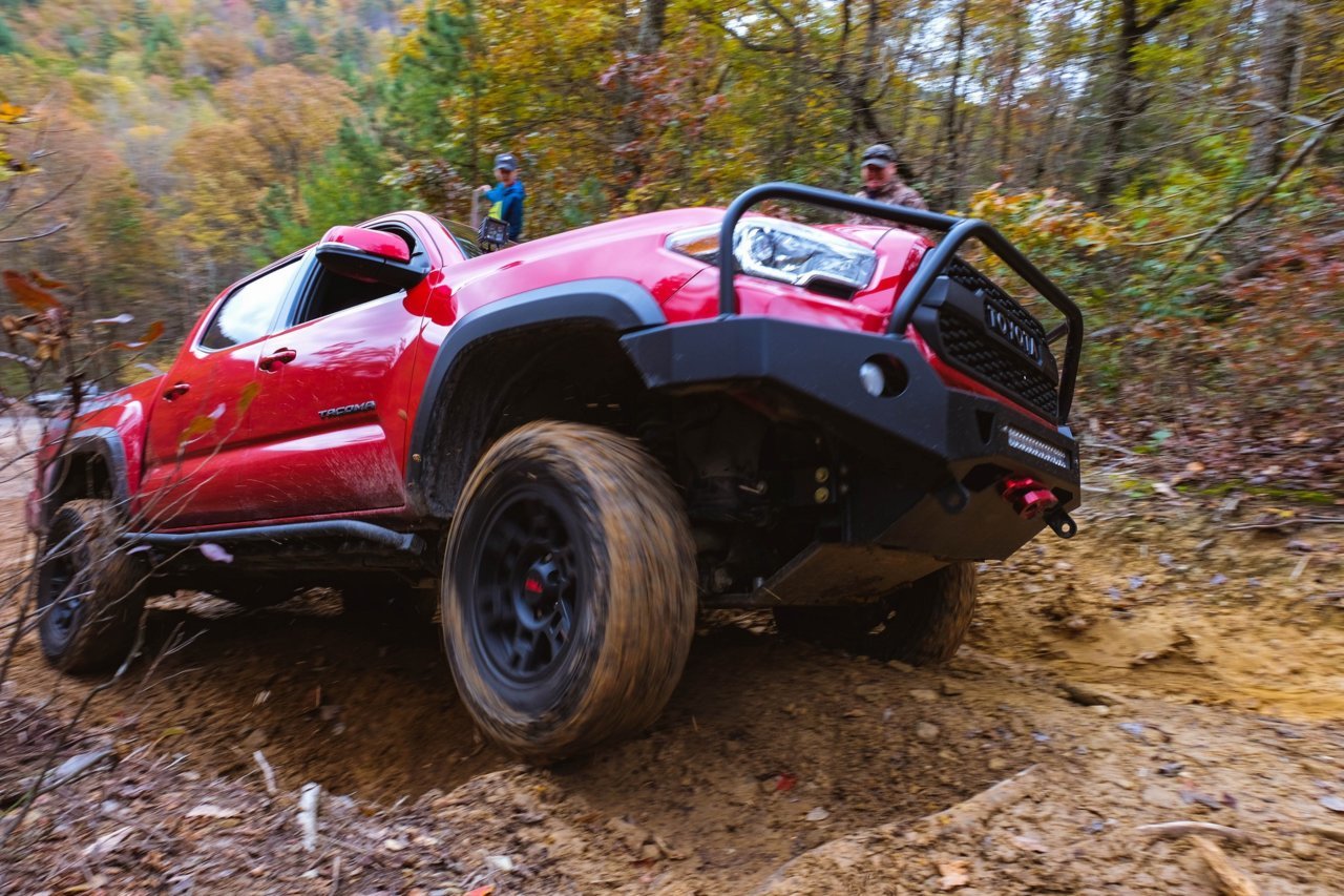

    Here is a pic of my skinny 33"s kicking ass climbing a steep, loose shale hill with mud moguls at the top. No problem for these tires and a rear locker. 482A83E1-B96A-4AE0-BFF3-F1B71009C538.jpg

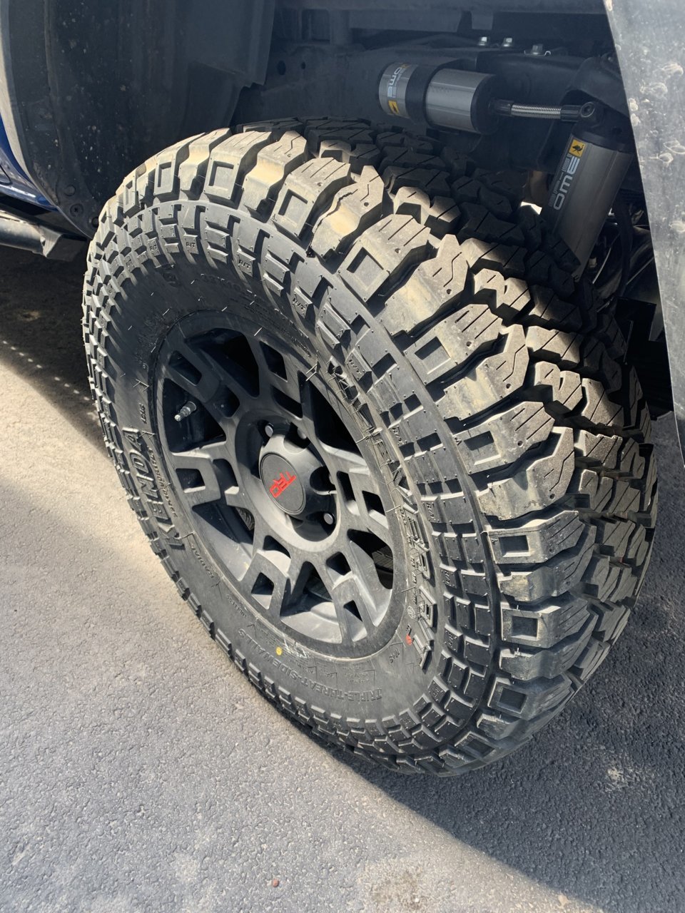

    2017 TRD OR
    Old Man BP51 coilovers Dakar HD leaf springs Icon Delta control arms TRD Pro rims with Kenda Klever RT 33x10.5 tires Exhaust mod TRD front skid, RCI tranny and transfer case skids Southern Style Slimline front bumper Baja Designs S8 bumper light Warn Zeon Platinum 10s winch 4.88 Nitro gears ARB front locking differential ARB twin air compressor X2 Power 27 battery RCI rear bumper with Rigid SRQ lights RCI rock sliders RLD canopy Dometic CFX3 55 refrigerator TRD Pro grill Front & Rear anytime camera Seat Jackers Diode Dynamics Pro fogs
    Haha that's funny. The actual tire will make a bigger difference in traction than the width of the tire. And depending on what your driving through, a “skinner” might even be better. In snow & mud for instance, you don’t want to go over it you actually want do go down through it if possible to hit a harder surface. I use to run 285’s but have much better luck where I live and drive through using a 33/10.5. The tire is also a better fit for the Tacomas as the 285's I was previous running felt like too much tire for the rig. Made the steering and handling feel sluggish. Couldn’t be happier running a 33/10.5. I can air these down and go anywhere I did with the 285. And it’s all about where and what your going to be doing with your truck. To just say you have to have a 285 or larger tire or your wasting your time is just being ignorant. I've ran four different sizes and five different tires in just the last two years so I'm speaking from experience. You obviously don’t have any experience running a 33/10.5 tire and haven’t tried too many tire designs to know that size isn’t always what matters LOL

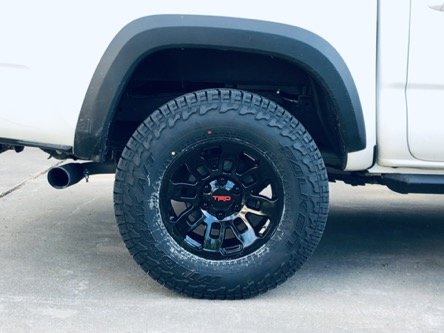

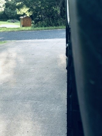

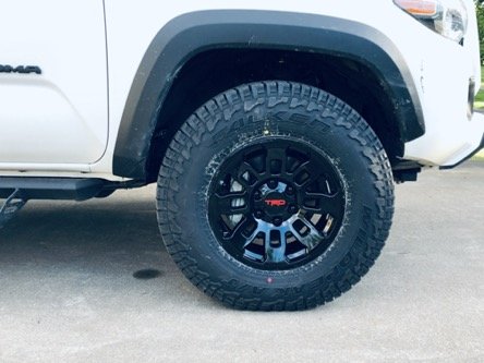

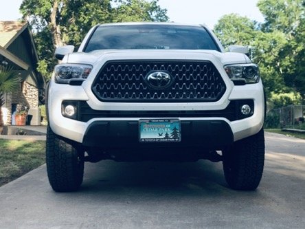

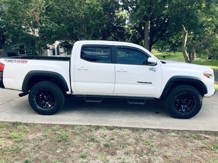

    255/80r17 on 17x8 +15 offset. Stock suspension and front mud flaps removed. No rubbing on daily driving. Haven't had a chance to do anything that would flex it off road yet.
