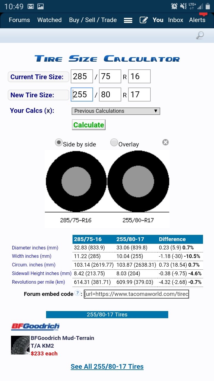

    I would prefer 255 by all of my research but I can get sets of 285s for half the price of 255s. (I work in a parts department for Honda and have multiple tire distributors to get wholesale prices on stuff) but even though them I can't get 255s for less than 170 each. Also a tire such as 255 80 17 is a taller tire than a 285 75 but has a smaller side wall. By what I understand more the sidewall the better. Plus that means I'd have to to buy a heavier and more expensive 17 inch wheel so any money savings on mpg would be gone. If it existed I'd choose a 265 80 16. And it would be nice if someone made any 33 or 34 in a SL tire. If wheeled some falken at3w in a sl on lots of sharp rocks and drive 100 miles a day for work and never had a flat. Our trucks do not need LT's.
