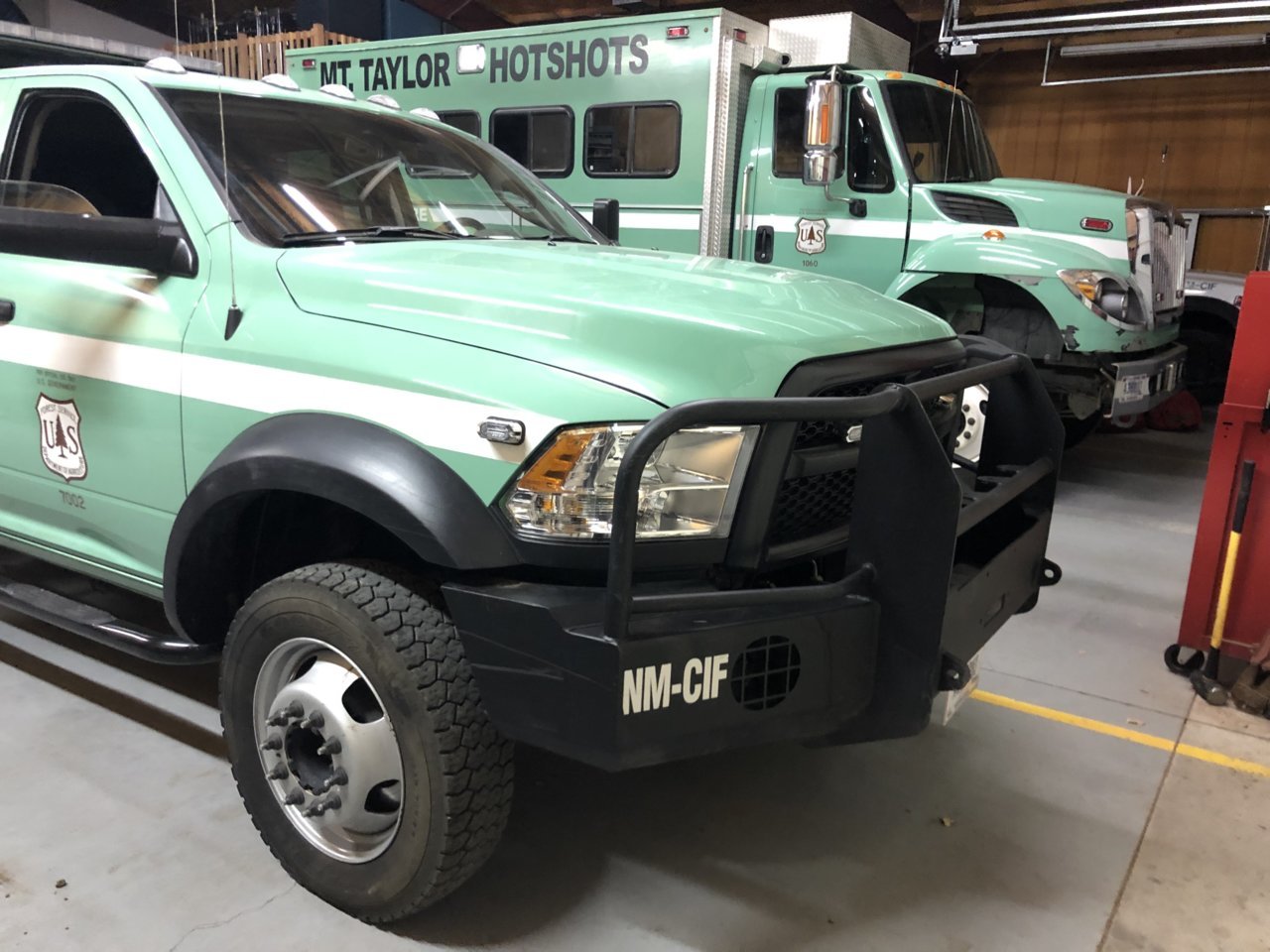

    I’ll add that the Forest Service fire rigs run “skinnies”

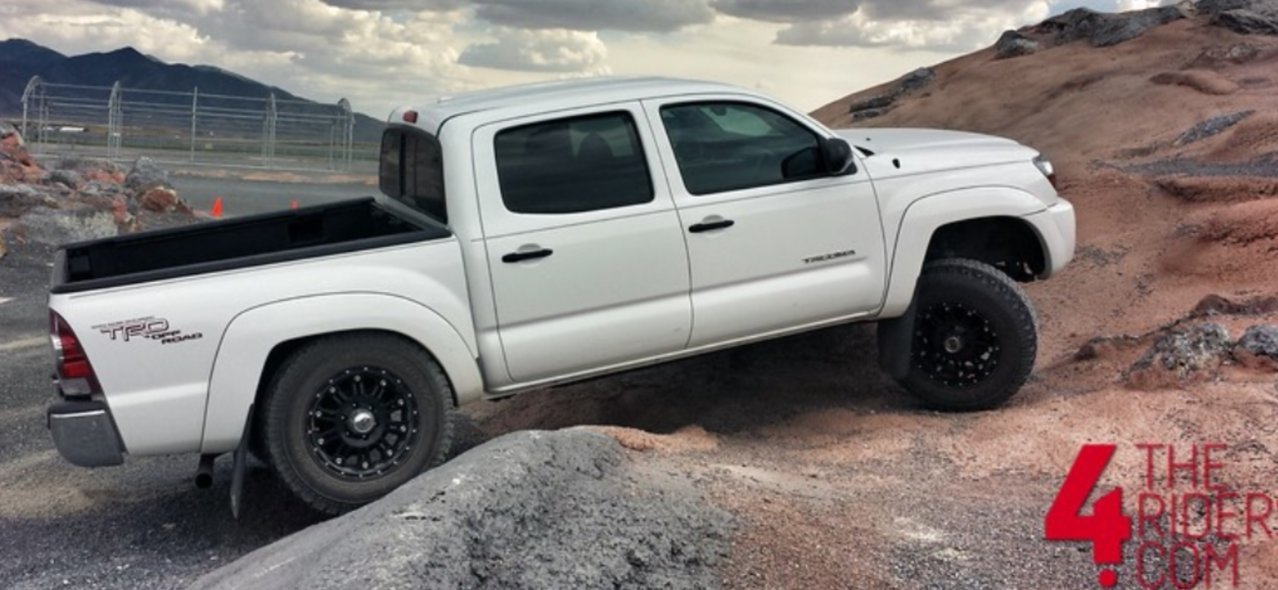

    He is just saying that when your suspension compresses and the tire goes up into the wheel well, the tire will end up in the same place whether the truck is lifted or not.
    Like this
