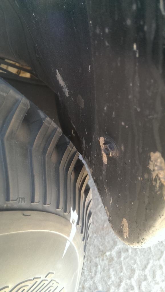

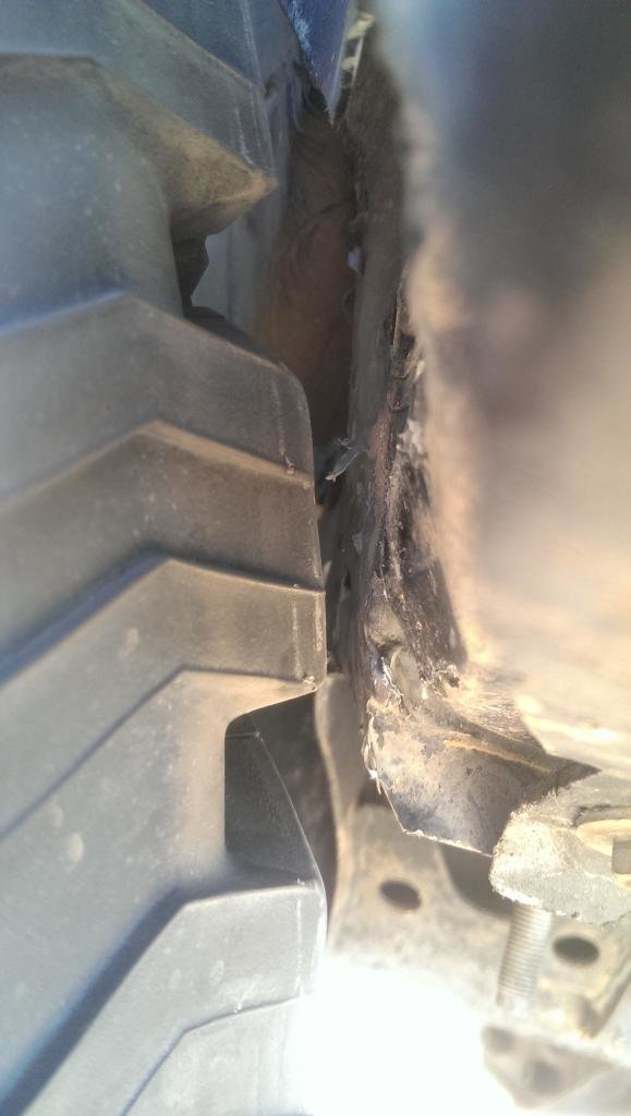

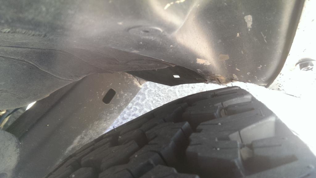

  4. Jul 20, 2014 at 6:47 PM
    NightProwler
    NightProwler [OP] Well-Known Member
    Nov 12, 2013
    #116470
    3,458
    Harlan
    Maricopa, Az
    '01 Prerunner, '16 trd4x4, '03 cbr954rr, '03 rc51
    As you can see, it's rubbing on the lowest point of that pinch weld. There's only a gap there between the tire and the pinch weld because the steering backed off about an inch from full lock when I let go because I didn't have anyone to hold it at full lock while I took pics.
    Again it doesn't really rub at all unless in reverse. It seems like its so close to being fixable. So I'm hoping the spacers will help. Or if not if I can get someone to adjust the camber or whatever. If not I can live with it. But would be nice to not have people turn heads and stare when I back out of a parking spot. Lol.
